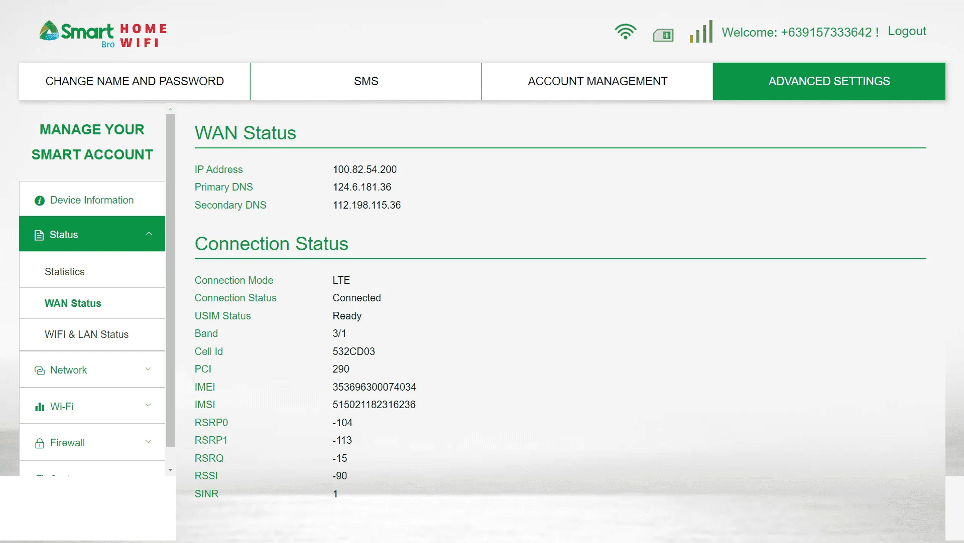

  • merong antenna ports
  • quectel module (low end cat6 300mbs/50mbps)
  • mahina sumagap (probably loc ko rin problema, baka nagcconnect sa mahinang band)
  • probable ipv6 bug like d2k (NOT SURE)
  • no antenna settings
  • build shape is good (ρrémíùm tingnan wag lang hahawakan)
  • eth 1 does not indicate as wan pero nagffunction siya as wan
  • so, 1 WAN/LAN port and 3 LAN PORTS, no other IOs
