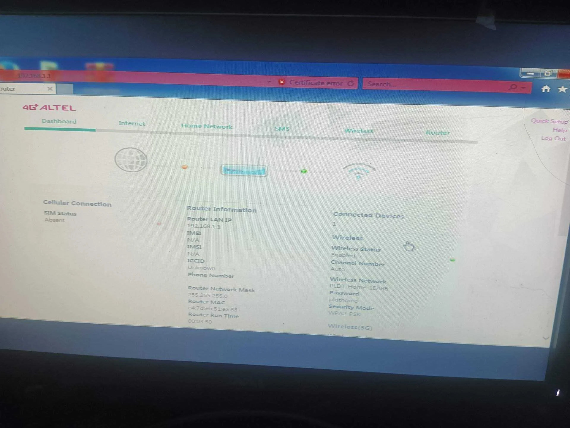

Pag nag flash ka make sure na alam mo kung san nkalagay firmware1 at firmware2..pag magkatbi si firmware1 at firmware2 flash mo sa mtd5 pag magka hiwalay naman sa mtd4...
Gnun naman po ginawa ko mismo file ni sir jhowel pinag kunan ko pinalitan ko lng ng bin file
Un po ginamit q na file is altel- firmware .bin
Ah cge po slmt
Alin po pala file pang pldt nalilito po kasi aq?
Yan mismo naka link dropmb ka phc
Altel-firmware.bin
para ma check mo po if san nka lagay mga firmware
cat /proc/mtd

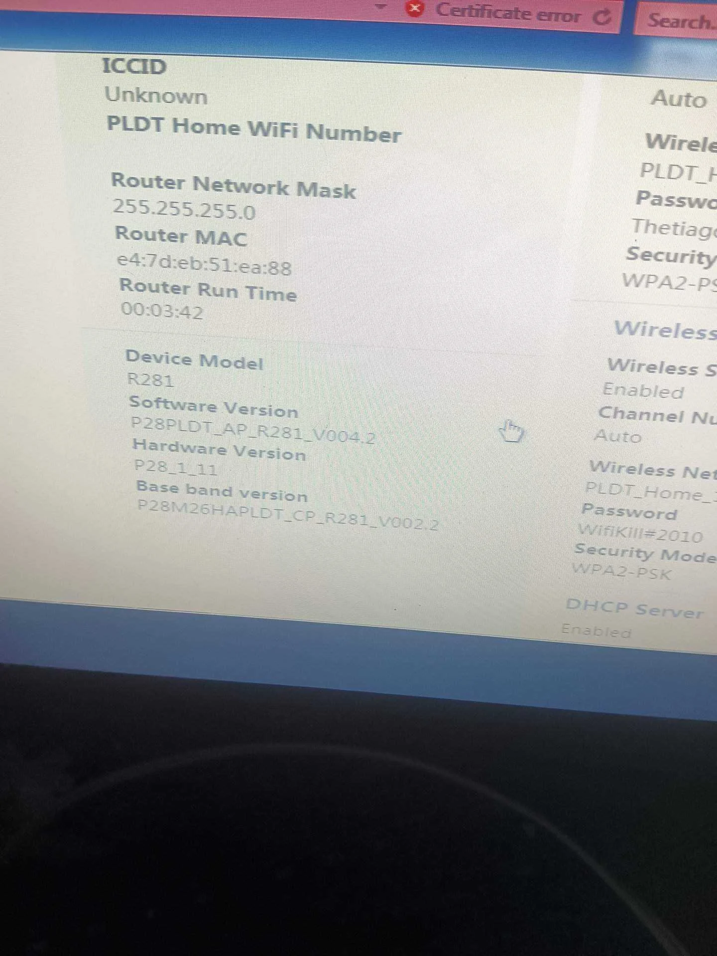

Check mo muna Firmware version
Kung updated na firmware mo to v53 at baseband31 error talaga yan, sarado yan need mo idowngrade muna
May paraan pa
Pero kung Firmware v54 baseband 33 yan, Si master Jerome palang may kakayanan mag downgrade nyan via Teamviewer

V.4.2 po gamit
2.2

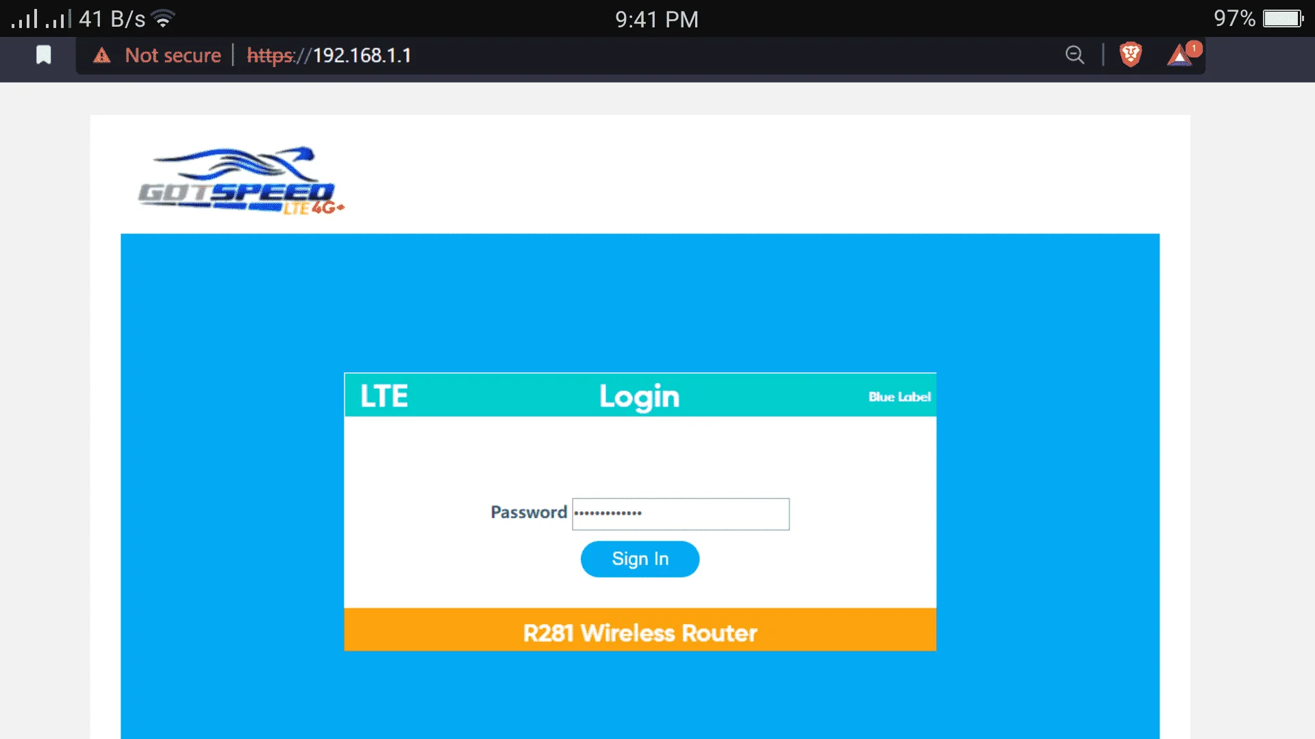

here sir
here sir
Ang bilis, Idol
More power to the Max kaalaman
Maraming Salamat para sa nakakarami na ka Phc
Marami matutuwa dito, Idol
Dapat sipagin din sila backread

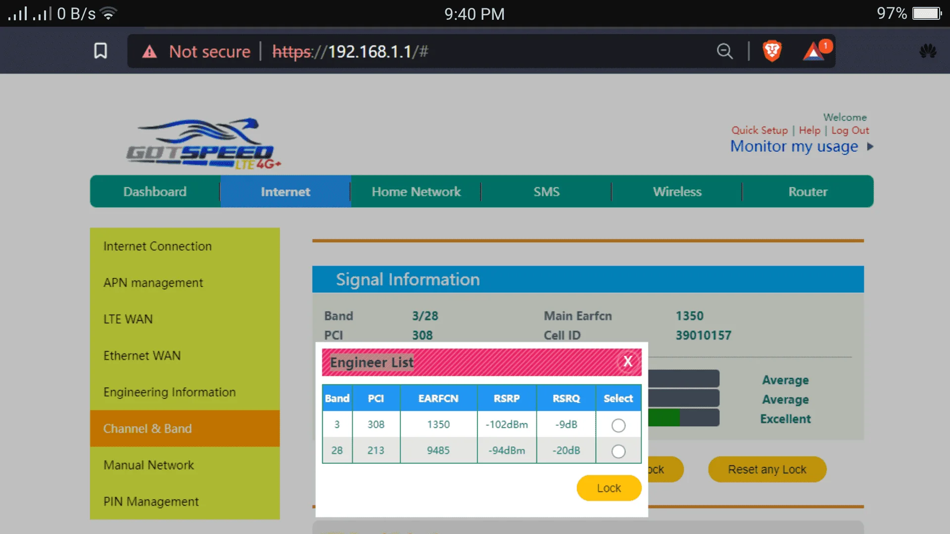

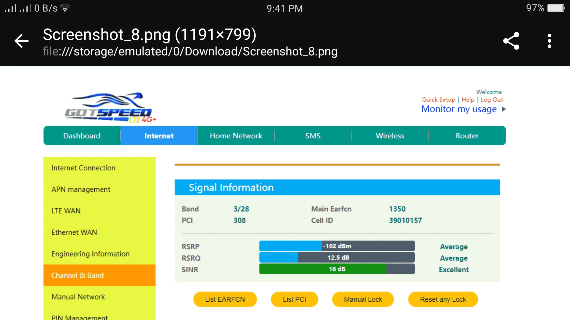

Dagdag Dashboard Collection from Lodi Alex with Signal bar, BANDLOCK, Cell id
Mukhang magandan gawan permanent
Kau naman mag request permanent kay Master Wesley, mga Lods
Screenshot_2022-07-26-21-41-33-45.webp Screenshot_2022-07-26-21-41-15-50.webp Screenshot_2022-07-26-21-40-57-84.webp
