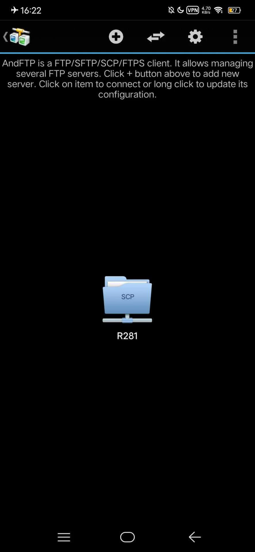

Sa akin ito lang gamit ko pang flash at Mobile Telnet🤣🤣

ito binfile block update and open telnet v5.2 webui
ito yung moded folder to combined...UNITEL webui them
salamat in advance Lods WESLEY
CREDIT din kay sir Lodi marukoy sa gumawa nitong more band..
inalis ko lang ibang band ...wala talaga sa R281
