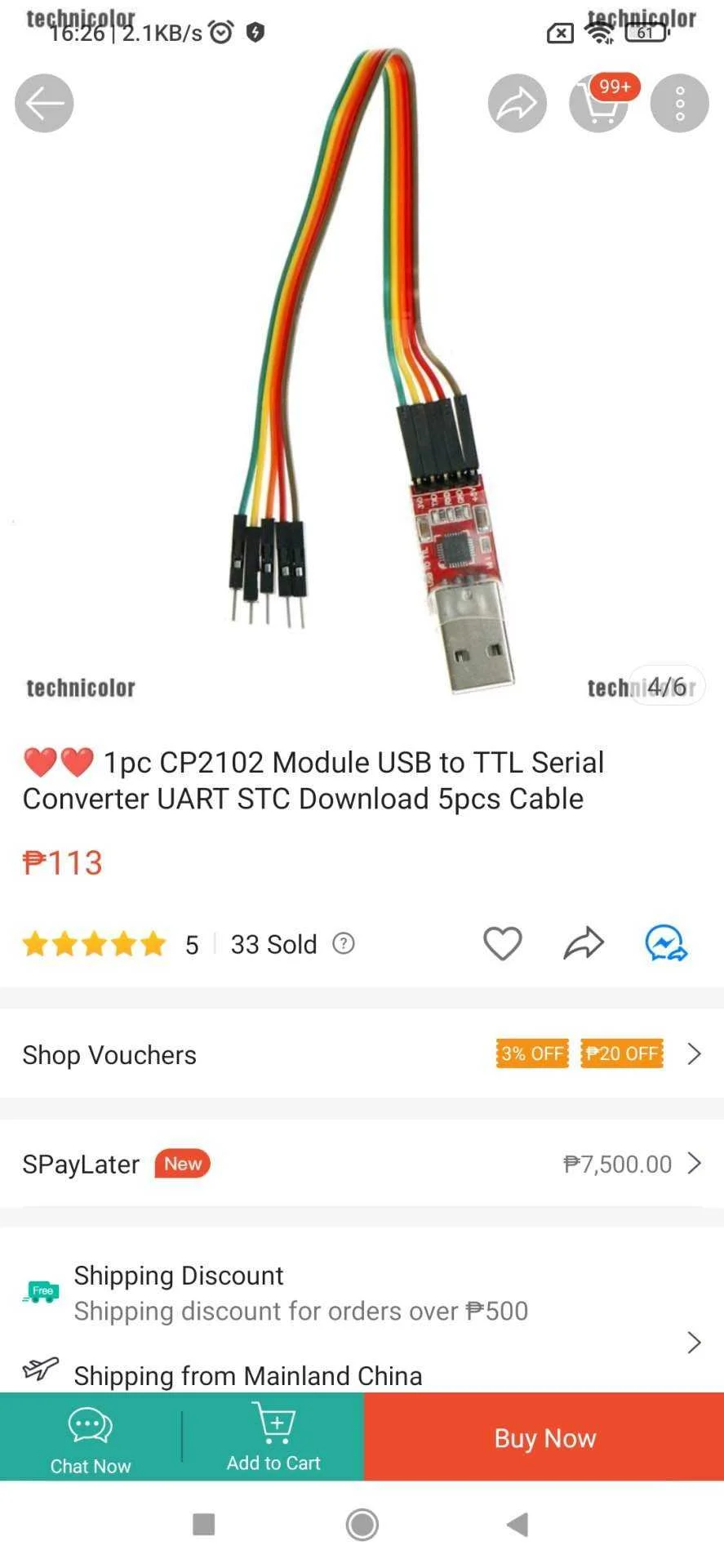

Sir jeromelaliagg ilang pin ang cp2102 ang bibilhin?
Kahit ilan basta may TX/RX/GND, wag gumamit sa board ng voltage gamit ang usb to ttl kung binubuhay naman ng ibang power supply ang pag coconneckan ng usb to ttl.

You can use any Silabs or FTDI USB UART bridges. Those are the good bridges. You just need to avoid the WCH and Prolific based ones.
We have tested the following:
  • Silabs CP2102
  • Silabs CP2104
  • FTDI FT232H
  • Silabs CP2102
  • Silabs CP2104
  • FTDI FT232H
Natest ko na itong Silabs CP2102. goods na goods mura pa. Waiting nlng din ako sa zte mf286ra. Lokong globe kasi yan zlt s12 pro ung dumating. Buti pinalitan nila. Matagal nga lang.
