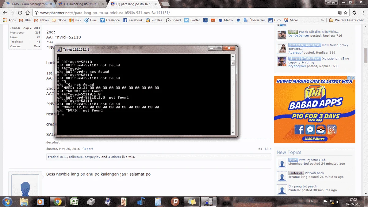

madali lang yan boss..
dapat naka open telnet client nang pc mo.
1st: mag static ip ka muna..
ang ilagay mo na ip (192.168.1.5) then hit enter
ang default sub. net (255.255.255.0) ok na.
2nd: open telnet, run (telnet 192.168.1.1) hit enter
mag papakita na si telnet. hit mo lang don (enter)
ito dapat makikita mo.
(BusyBox vv1.9.1 (2014-11-03 0901 CST) built-in shell (ash)
Enter 'help' for a list of built-in commands.)
next step:
1st
type: lteat
tapos pag may nagpakita. burahin ang unang letra na T at ang matitira syempre A
tapos type kana ng AT (magiging ganito ang format niyan AAT^nvrd=52110)
AAT^nvrd=52110
^NVRD: 12,31 00 00 00 00 00 00 00 00 00 00 00
pag back to normal naman:
1st:
AAT^nvwr=52110,1,0
2nd:
AAT^nvrd=52110
^NVRD: 12,00 00 00 00 00 00 00 00 00 00 00 00
restart modem!

hello po, nagawa ko na po ang step 1 which is yung bricking. Ang hindi ko maiintindihan paano gawin ang unlocking code ng b593s-931-nov. Nakapasok na ako sa telnet and i tried using the command AAT^CARDLOCK? pero hindi ko parin gets kasi nag "error! ret=-1" sya.
