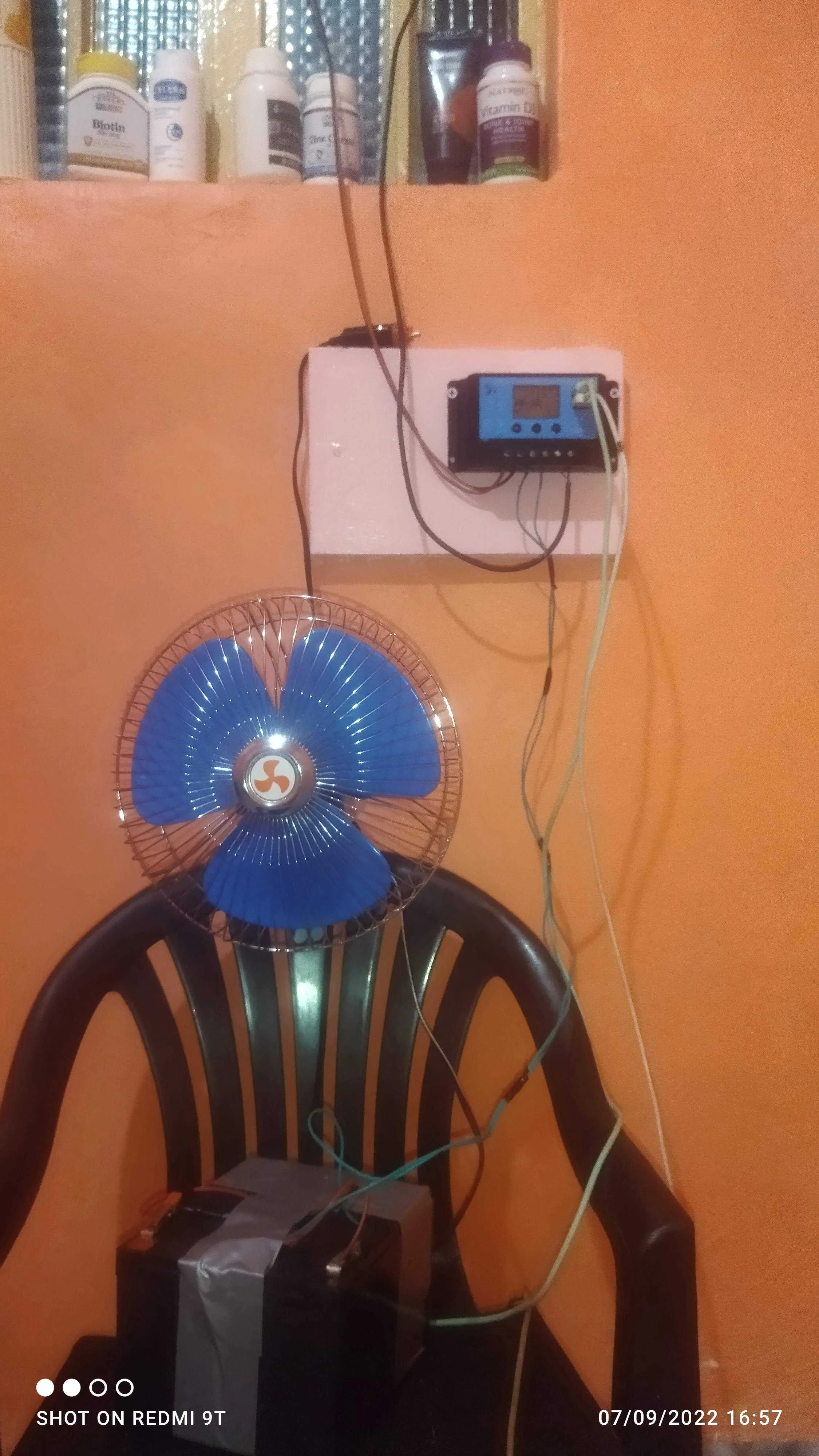

Fully charge 9 hours gmt ko fan pag gabi
Charging 5, and half hour
Battery dlwang 8 ah, 16 amp nka parallel
Inayos ko na nilagay ko sa room ko 😊 solid eto nalang fan nato 8ft abot ung hangin 😊😁IMG-20220709-165806.webp
