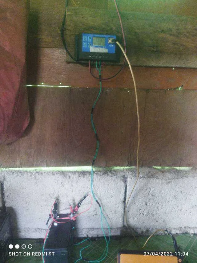

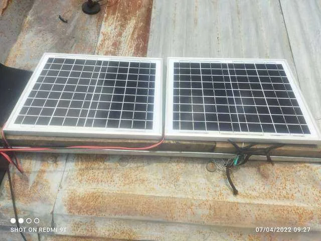

Share ko lang may 30 watts solar naka parallel ung dalawang 15 watts,IMG-20220704-092728.jpg pang charge at pang ilaw at electric fan na 12v

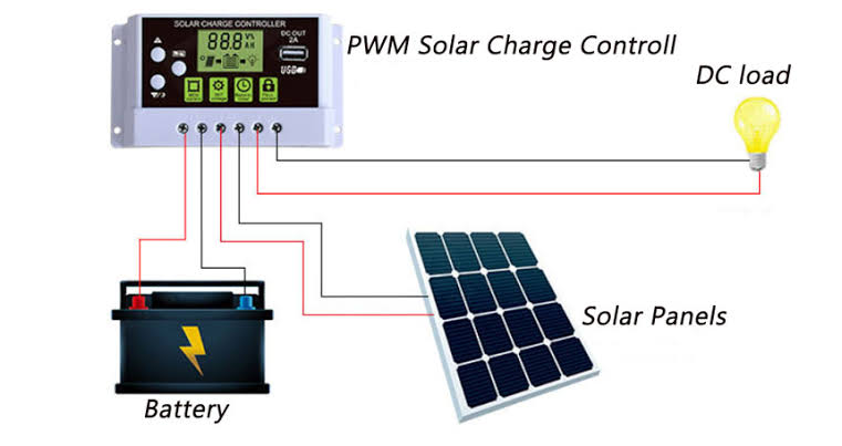

Solar charge controller my
Dalawang klase pwm at mptt , depende sa bibilin magugustuhan ninyo controller, ung sakin ay pwm pang lead acid lang ung mptt ay support sa lahat ng battery gel type lithium at lead acid
Sa wire naman pagdutong sa solar panel at sa battery ay number 22 for low watts ,kung high watts nmn panel nyo 12 or 14 sized ng wire😊 gamit na lang kayo ng electrical tape pag pinutol nyo alligator sa sa solar 😊. link ng wire You do not have permission to view the full content of this post. Log in or register now.

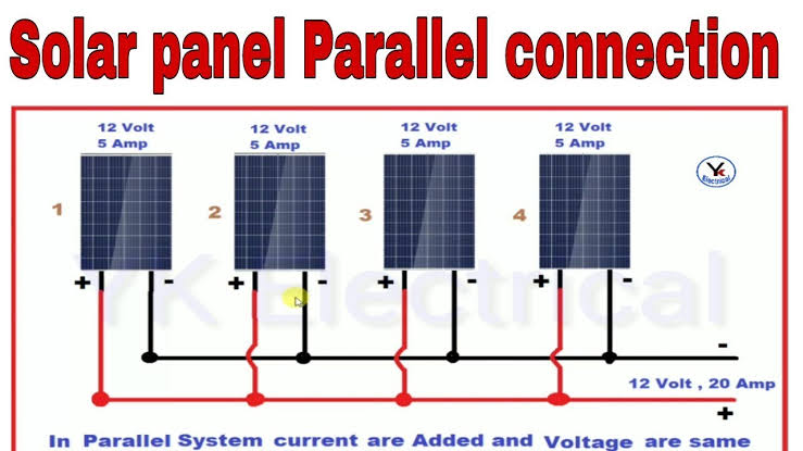

Eto po tut para mag parallel ng 15 watts pwede nmn po mag cmula sa 15 na panel kung low budget pag my pera uli sa bumili uli ng 15 watts na panel.
Note po sa pag parallel ng panel dpt same volts at same watts .
Solar panel 15 watts 375 pesos You do not have permission to view the full content of this post. Log in or register now.

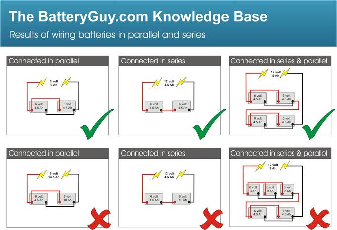

Sa battery naman na gamit ko ay lead acid napili ko 😊 8ah pwede rin iparallel connection ang battery, note dapat same amphere ung battery.
Lazada battery 450 pesos You do not have permission to view the full content of this post. Log in or register now.
Panno iparallel ang same amp at volts ng battery na kahit ilan pa.
