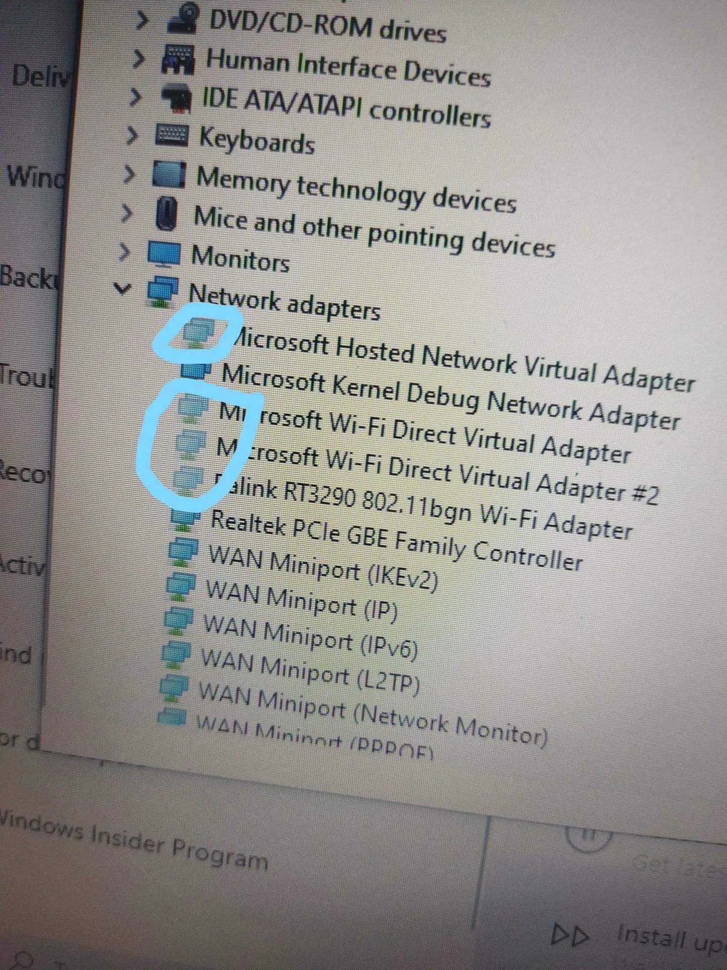

🔒 Closed Windows 10 no wifi icon (sa mga laptop expert dyan)
try niyo po sa device manager, then network adapter, idelete mo yung nandun then restart pc. automatic mag rereinstall yun, pero kung hindi, connect muna thru LAN then download ka manually ng wifi driver

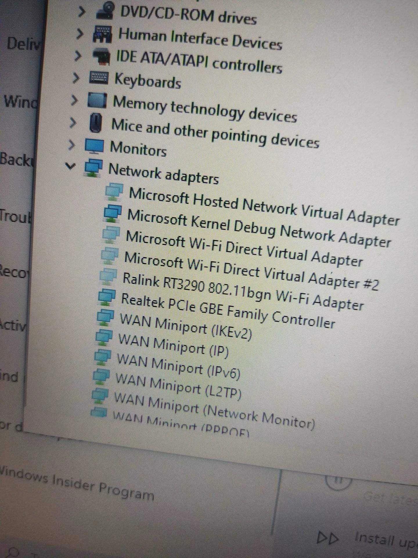

Baka hardware fault na po yan. Since walang gumana na tutorials try disconnect at connect yung wifi card ng laptop mo, then check if umayos or gumana, pag wala parin baka hardware nayan at need na ng bagong wifi card. Hindi drivers ang prob since nakikita naman ng device manager mo yung realtek na wifi card, bago mo pala i disconnect connect try mo right click sa ralink wifi adapter check mo kung merong enable driver tapos click mo yun and check mo16536415250047214281706693185547.webp
uninstall mo yang mga hidden devices mo. then click mo refresh or f5 key.
pag ayaw pa din, punta ka sa bios, load default config. save then restart.
Please check your wireless card in your laptop, Because if the wireless card is damaged then that would be a problem. However some wireless card are not completely functional with other operating systems like windows 10, or windows 11. But some operating systems like windows 7 or any linux distributions mostly works.
I suggest you change your wireless card from laptop that is supported by any upcoming operating systems.
Baka sa hardware na yan ts, try mong alisin, linisin then ibalik yung wifi module ng laptop mo.
Ganyan din nangyari sakin dati, hindi na ma read wifi module ng laptop ko pero ginawa ko lang to umokay na.
