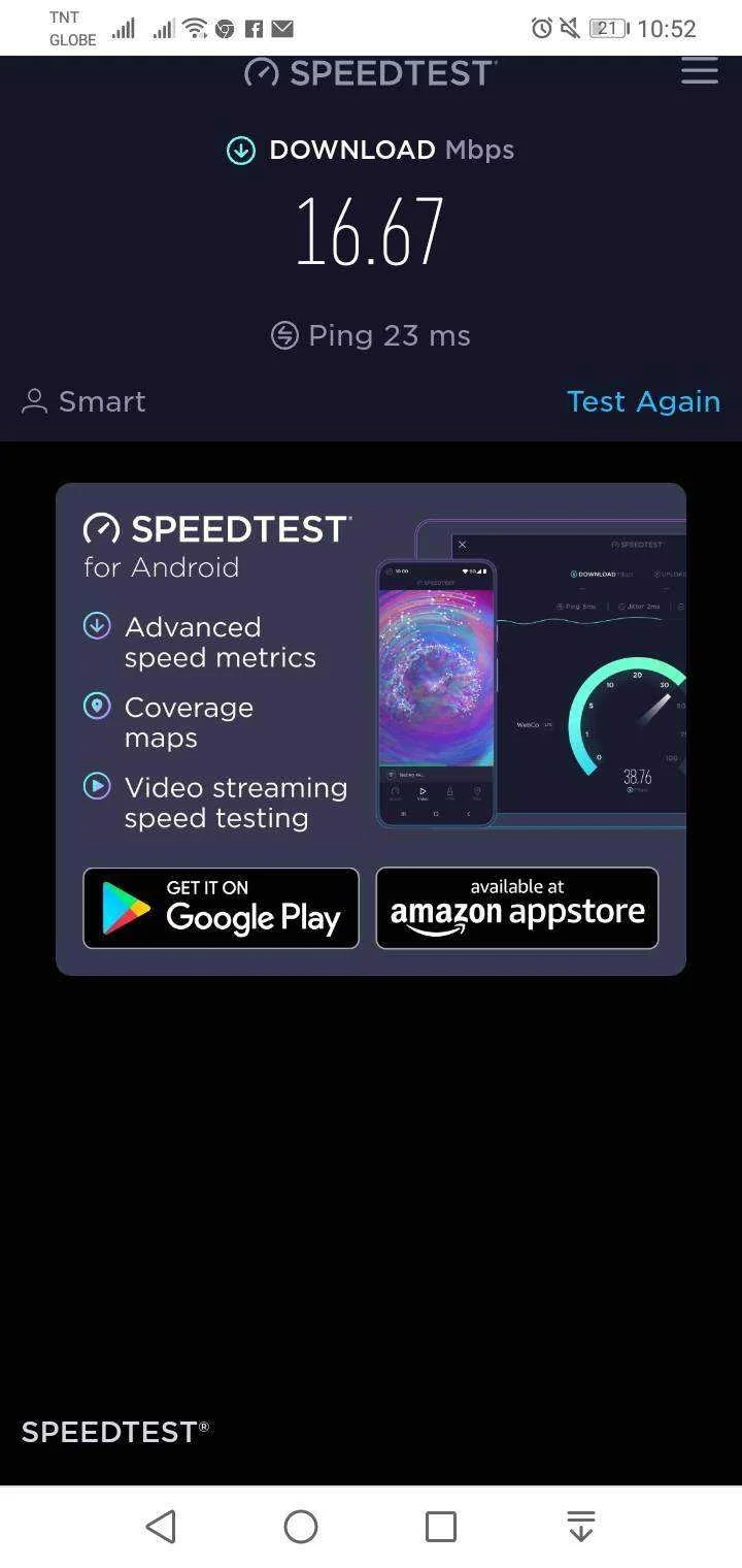

Post nyo mga lods speed ng UNLI299 sa modem hindi sa phone
napakabagal unli299 parang GOMO 5Mbps cap

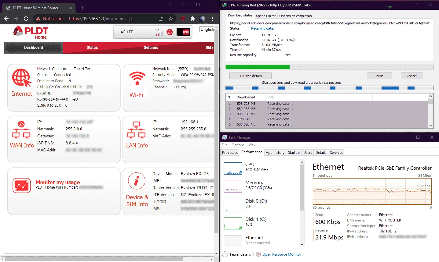

I am using ZLT-S10G and FX-ID3 with EXTERNAL ANTENNA
Tried different possible solutions but still no progress
Change BAND ❌
Cell ID locked ❌
Change APN ❌
Change IMEI ❌

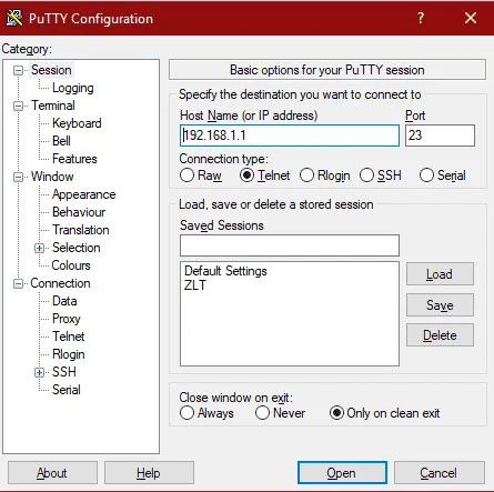

lods di ko alam pano mag access ang advanced.asp sa FX-ID3. Madali lang mag change IMEI via putty ang problema wala pa nagshashare pano ma access telnet. Antay mode muna sa mga master na hindi nagpapabayad.

go to advanced settings (You do not have permission to view the full content of this post. Log in or register now.)
user: advance
pass: @siaT3lco
go to system command enter
telnetd -p 23 -l /bin/sh
go to putty
ENTER COMMAND
AT*MRD_IMEI=D (press enter)
AT*MRD_IMEI=W,0101,01JAN2019,<IMEI>(press enter)
tapos reboot
