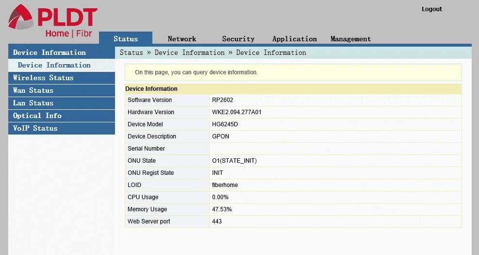

👨‍🏫 Tutorial Fiberhome HG6245D RP2804 downgrade fw for superadmin
bale lods tanggalin mo lang ung yellow na ρá†ch cord from pldt fiber junction box don sa onu mo ska mo ma access yong admin hxxp://www.YøùTùbé.com/watch?v=gbiZiJqu3Vk

Possible kaya mag change onu from fiberhome to huawei? Meron kasi akong HG8145V5 running COMMON(Generic) firmware. Gusto ko sana ipalit sa fiberhome HG6245D grabe kasi uminit at ping spikes. garalgal pa telephone pag high load.
Nitry ko na kasi i copy yung serial from fiberhome to huawei kaso (O5 Operation State lang). Di kumokonek yung mga WAN.
Na try ko rin i copy ung serial number ng fiberhome don sa huawei at yes operational ung state nya pero wlang wan ip na ma receive. Ginawa ko is pinapalitan ko na lang ung fiberhome to huawei from pldt. Minsan pa swertihan lang kung me huawei ung contractor na pinadala ng pldt at dpat na ka indicate don sa tiket mo na huawei gusto mong ipapalit
Lods na try mo naba mag open ng uno sa console andun ata lahat ng command pati palit ng mac
