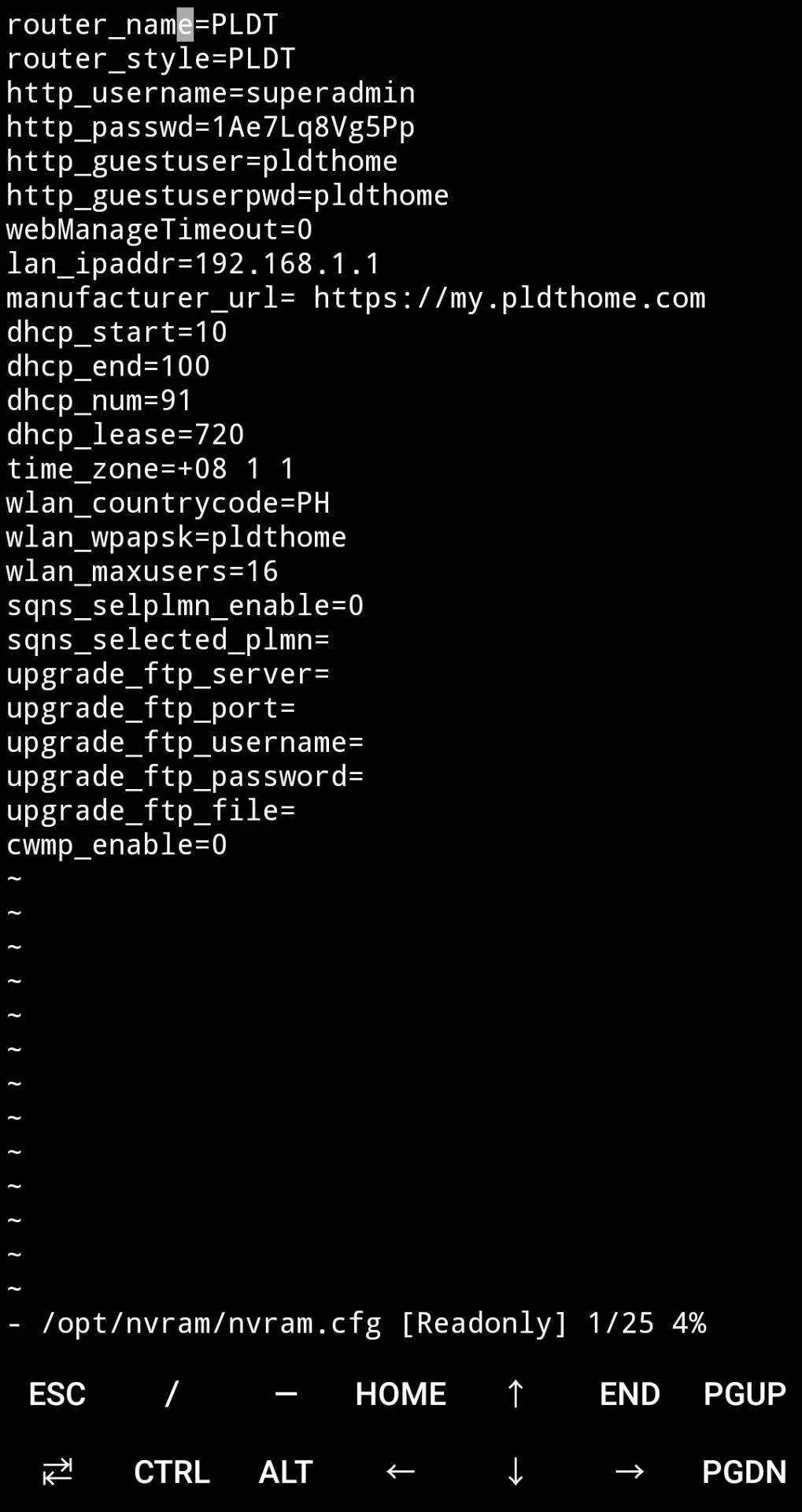

Someone sent me a sceen shot asking me how to modify the opt/nvram/nvram.cfg Sad thing is I don't have my D2k. I can't see all the available details or pkgs that comes with the modem.

pahirapan iedit eh sabi nung clue ni boss b kernel ρá†ch daw
kernel ρá†ch sabi2 sa. mga ρáíd service para mahirapan kau pero ang too isang command lang nman para ma edit nyo sya

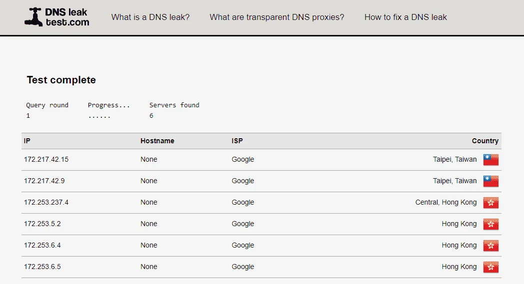

sa mga gusto mag palit ng DNS ni D2k ito command
nvram_set 0 wan_dns '8.8.8.8 8.8.4.4'
nvram commit 0
/sbin/reboot
after reboot check nyo dapat magiging ganito sya
# cat /etc/resolv.conf
search local
nameserver 8.8.8.8
nameserver 8.8.4.4
nameserver 10.86.250.171
para ma check nyo working ang DNS punta ka sa website You do not have permission to view the full content of this post. Log in or register now.
click nyo standard depende alin sa dalawa... dapat ganito ang magiging resulta nasa image
