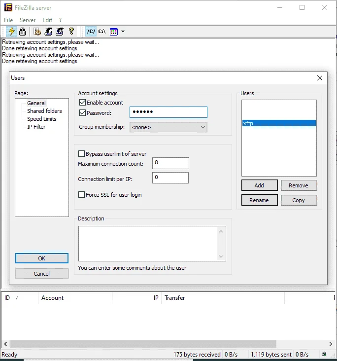

- Create Access account to your Server; Sample FTP-Username - xftp ; password - 123456

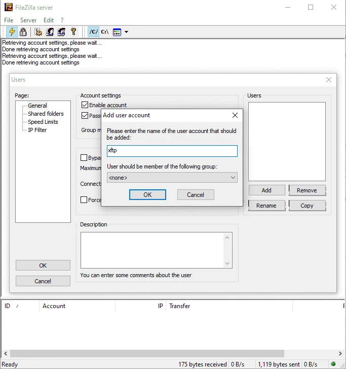

a. on your fileZilla console Click the edit and choose user, you may also click the icon with one face
b. on the user pane click add and input xftp see below as the username and then click OK
c. Check box of the password and input 123456 as password of xftp user.

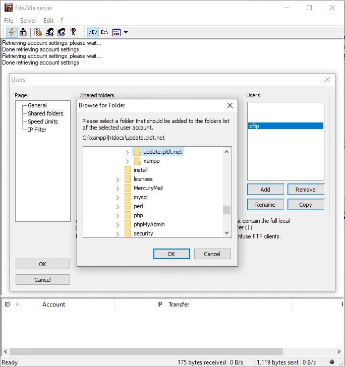

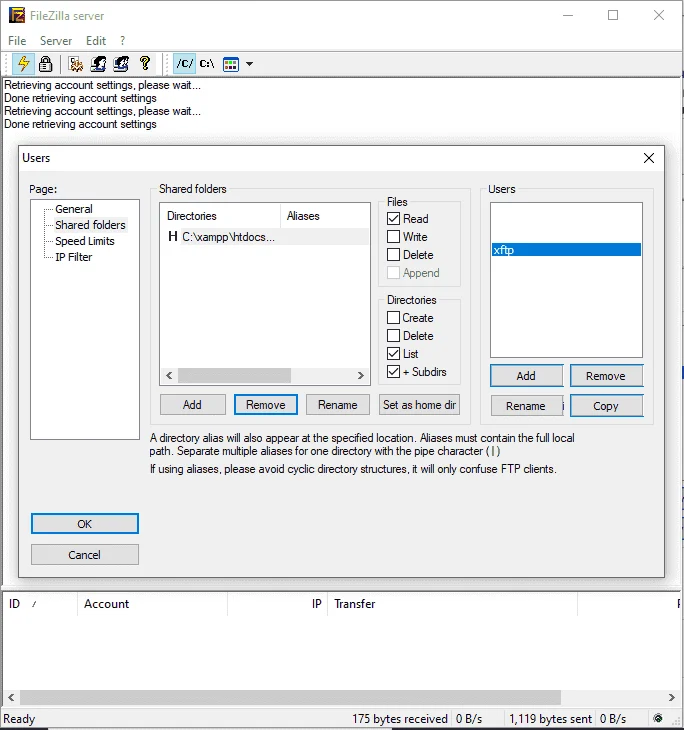

d. Assigning the Shared folder;
  • Click Shared folders and in the shared folder pane click add
  • Select the folder named below as your shared folder
- set your folder option below, i prefer read only below, then you may now click OK to save Share folder settings
e. On the Share folder Create D2K folder and put the Firmware rename the below to PLDT_IDU_GDM7243QT.PRG

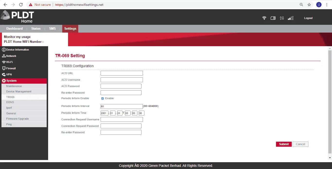

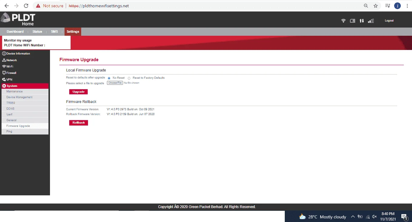

d. Also verify on your Modem console on the tr069 settings, see below

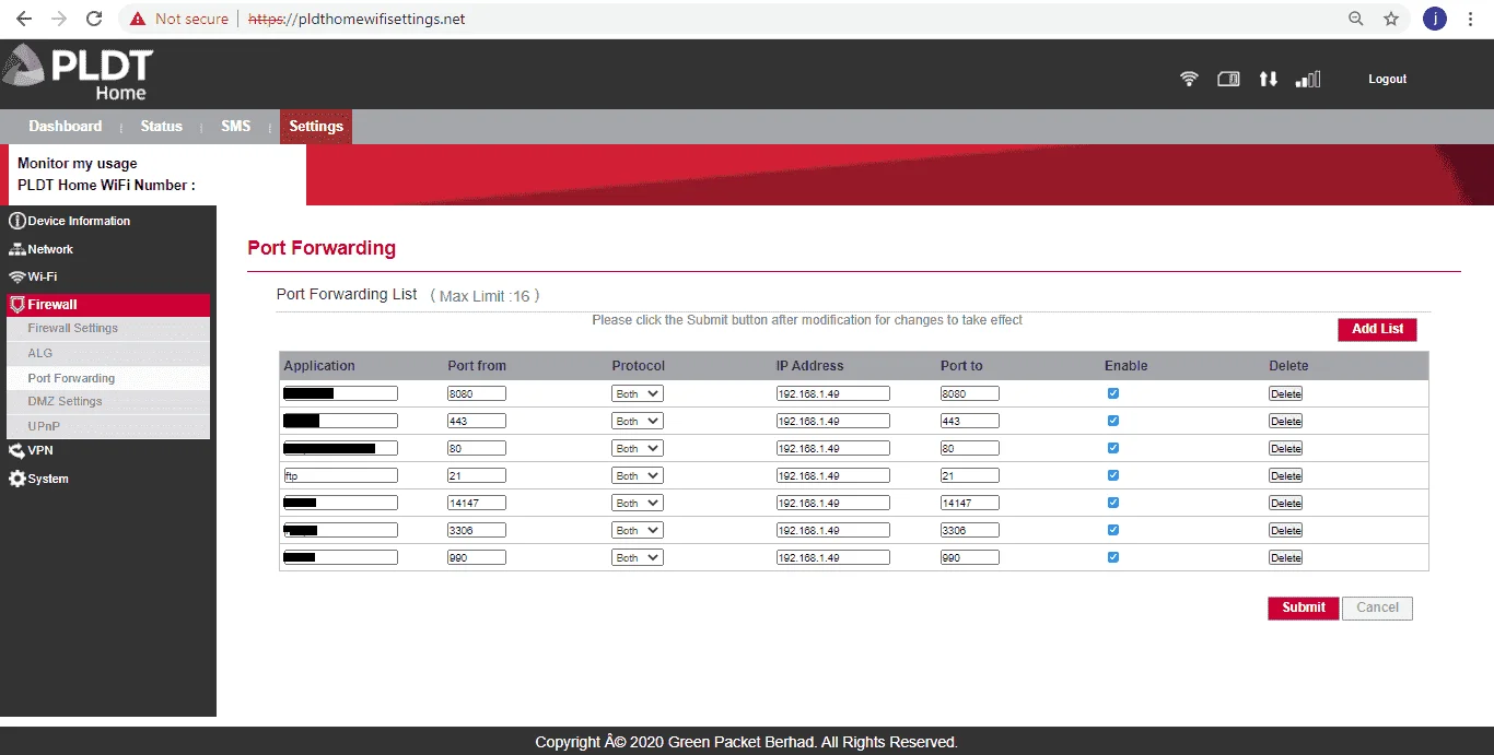

e. you will need also to set your port forwarding on your modem, i have below my port forwarding configurations

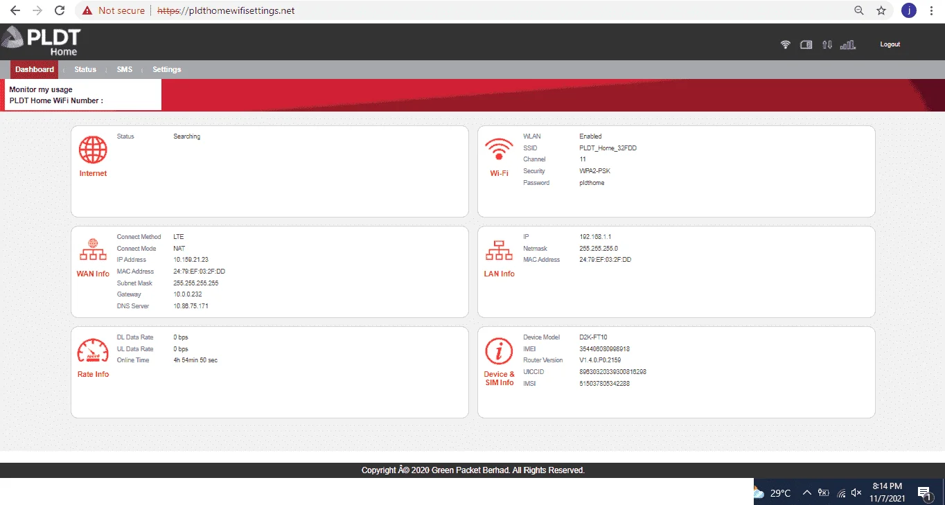

All are set, verify if the run time of the modem is below 10mins. reboot modem if it is already above 10mins run time

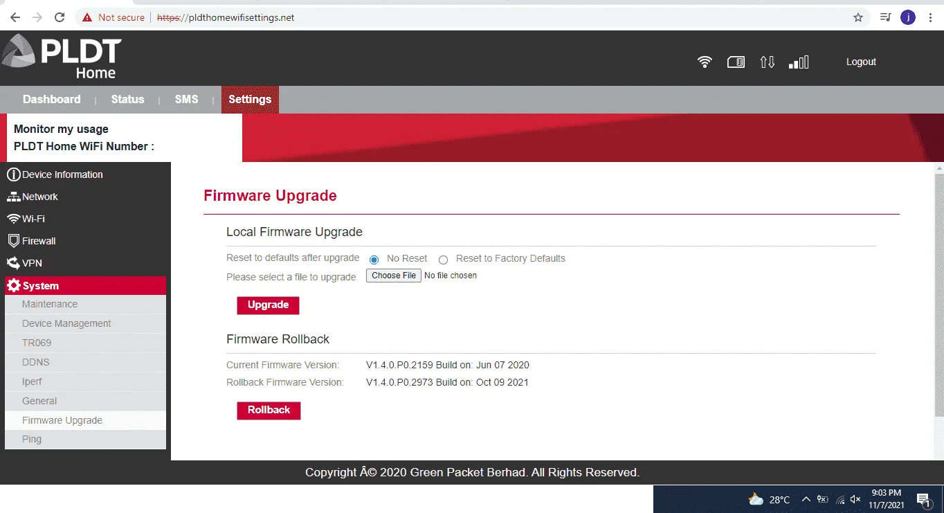

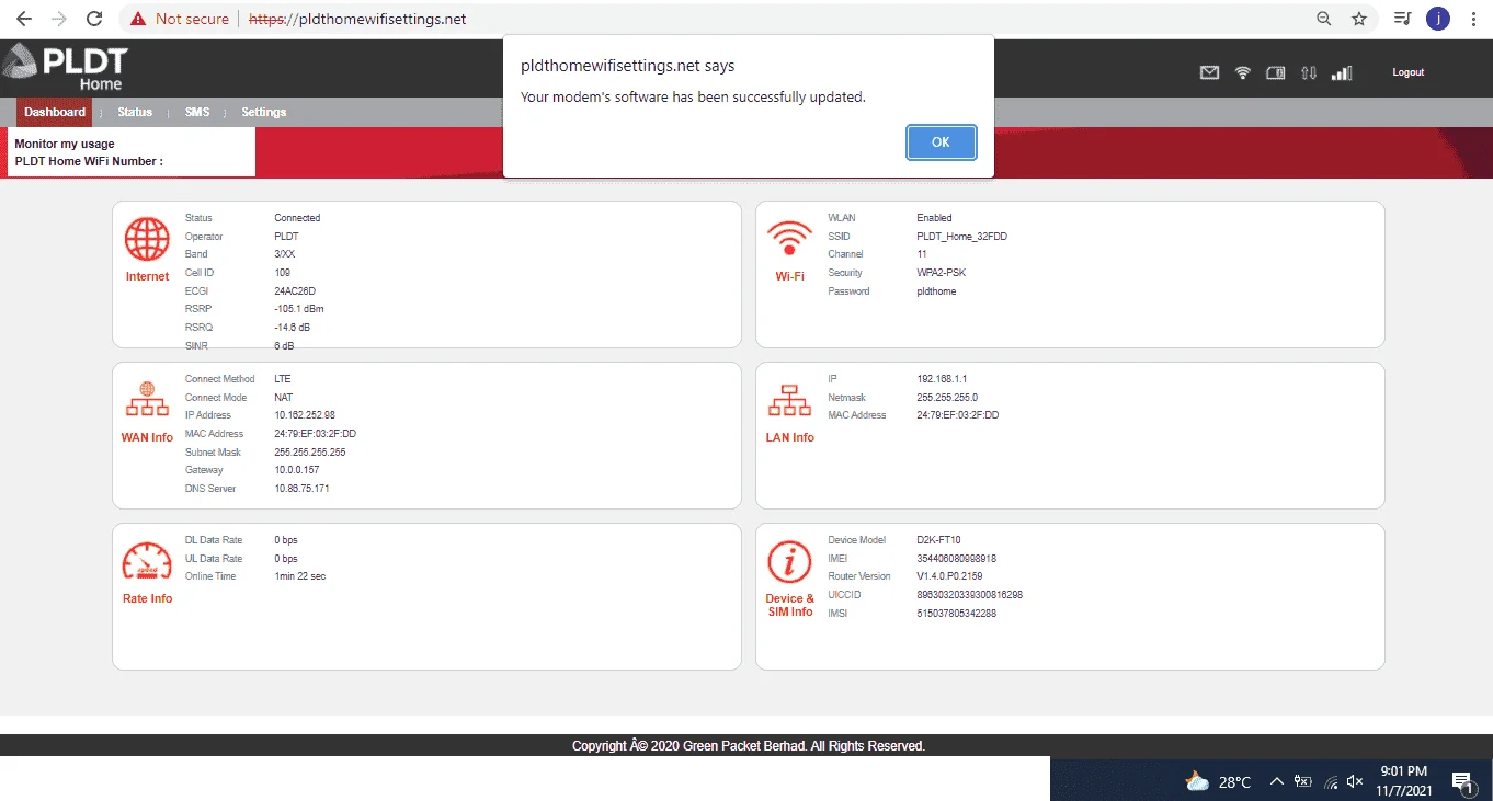

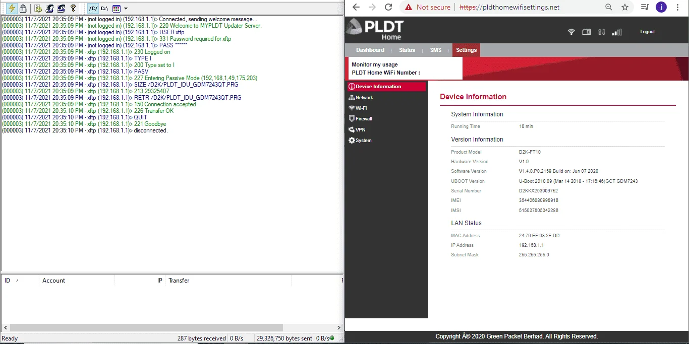

a. initial ver. 2159

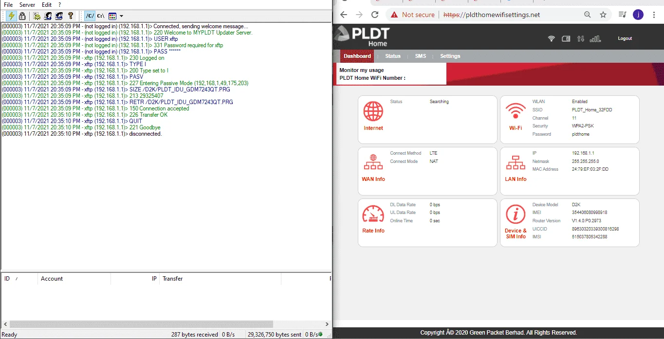

b. the modem communicates with the ftp server below, your modem will reboot
c. Relogin to the modem console and you will see that your firmware has been updates to 2973
d. see time and the firmware details - your nvram,cfg will still be as is

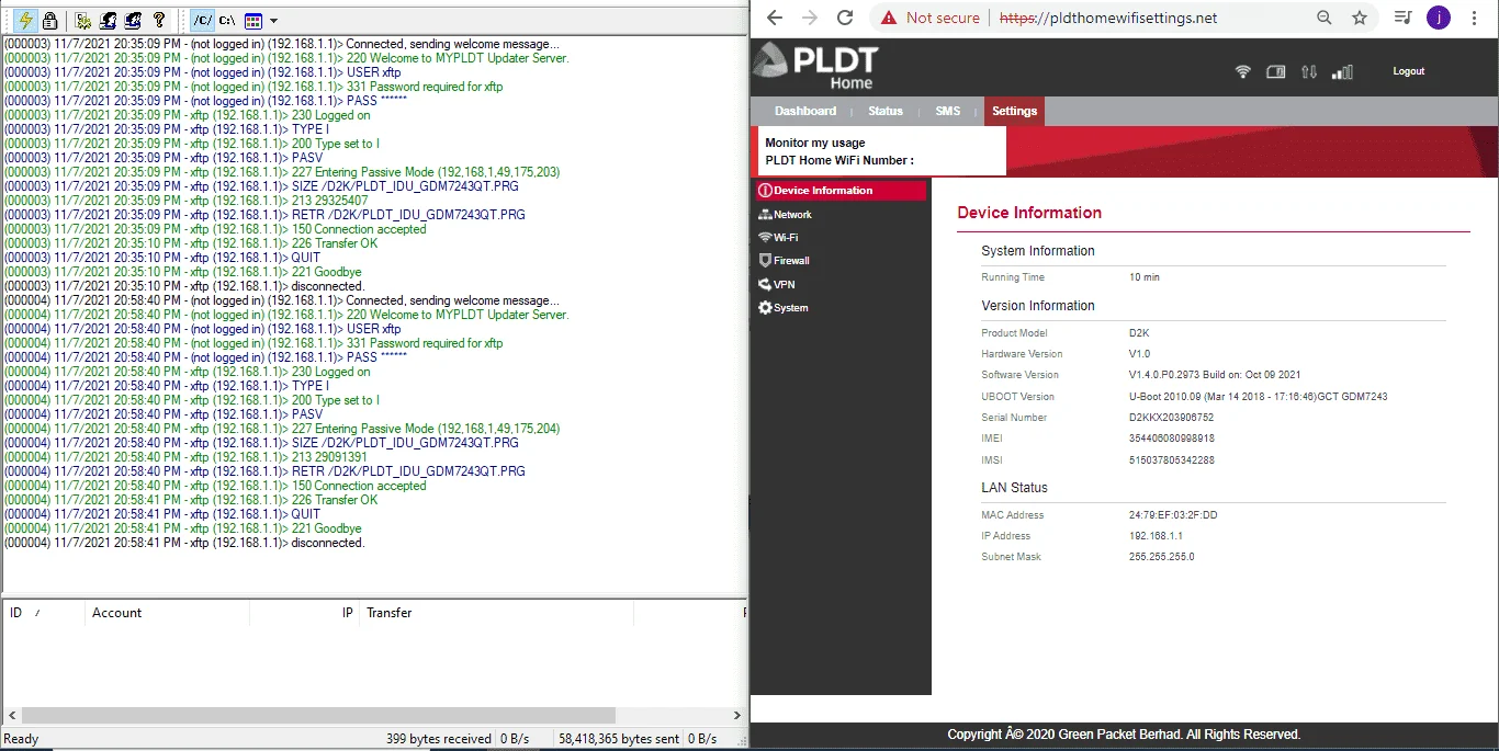

e. rename the current firmware on your Shared folder now use the 2159, rename to PLDT_IDU_GDM7243QT.PRG
f. Reboot your Modem
g. the modem communicates again to the ftp server
h. see below the new details/updates on your Modem console; the firmware updates back to ver. 2159.
i. see the firmware update details below of your modem console
