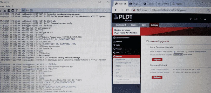

Blocking updates command below - copy paste nyo lang po sa baba na commands
nvram_set 0 manufacturer_url
nvram_set 0 cwmp_periodic_inform_enable 0
nvram_set 0 cwmp_periodic_inform_time
nvram_set 0 cwmp_periodic_inform_interval
nvram_set 0 upgrade_enable 0
nvram_set 0 upgrade_protocol
nvram_set 0 upgrade_method
nvram_set 0 upgrade_http_url
nvram_set 0 upgrade_http_period
nvram_set 0 upgrade_ftp_server
nvram_set 0 upgrade_ftp_port
nvram_set 0 upgrade_ftp_username
nvram_set 0 upgrade_ftp_password
nvram_set 0 upgrade_ftp_file
nvram_set 0 upgrade_ftp_period
nvram_set 0 upgrade_tftp_server
nvram_set 0 upgrade_tftp_port
nvram_set 0 upgrade_tftp_file
nvram_set 0 upgrade_tftp_period
nvram commit 0

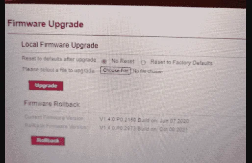

Sadyang pwede idowngrade ang 2973 lods, kahit sa local firmware upgrade gagana yan.
Try mo iupgrade sa 2993 ang firmware mo then saka mo gawin yan 2159 na sinasabi mong downgrade. bjarnco32
Naka permanent lock na pre ang 2993+ version, di ko alam kung bakit marami parin nag pipili ng via nvram command at plmn settings sa interface.
