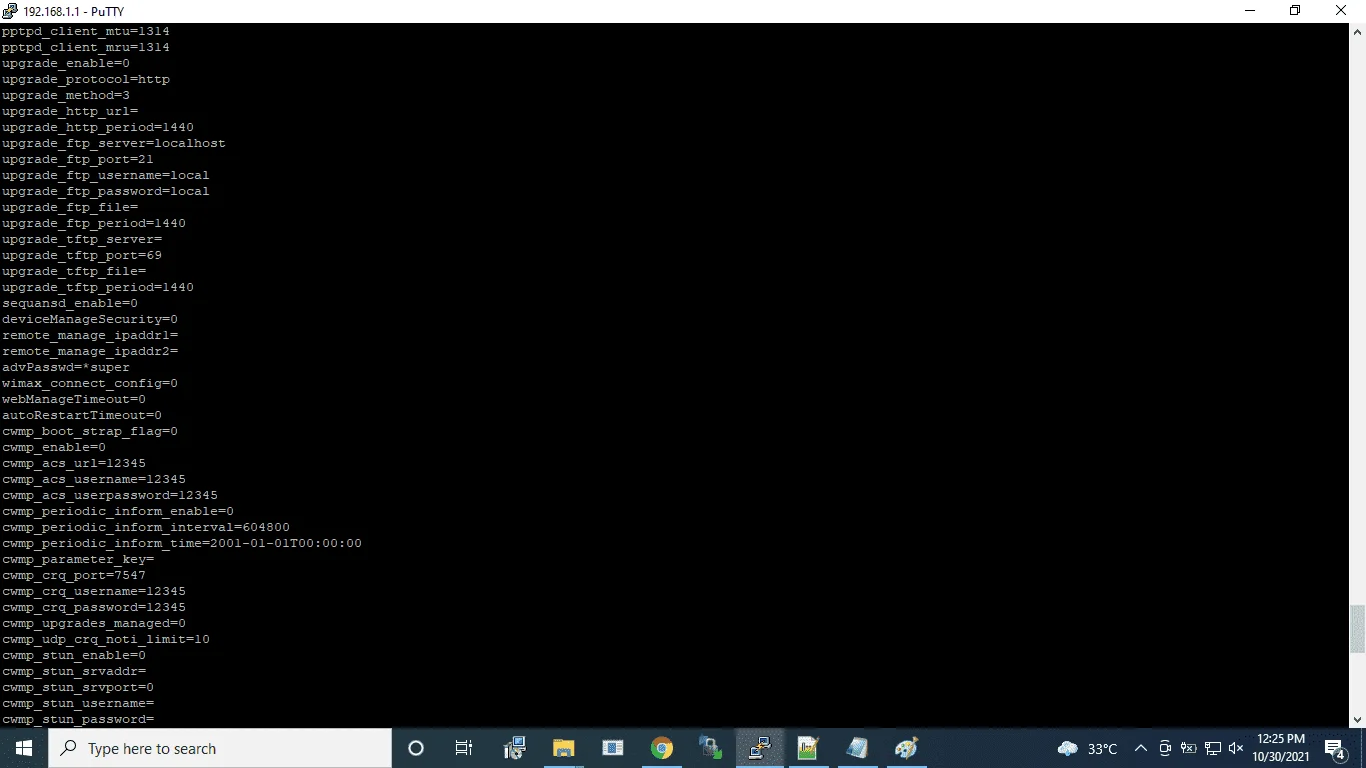

Check mo muna kung gumagana yan openline mo sa 2993 TS, at mamaya mali impormasyon na ibinibigay mo. Did you try it yourself with another sim from another network? Where's your actual screenshot that it is openline and working?

Disable Updates Values
upgrade_enable=0
upgrade_protocol=http
upgrade_method=3
upgrade_http_url=
upgrade_http_period=1440
upgrade_ftp_server=
upgrade_ftp_port=
upgrade_ftp_username=
upgrade_ftp_password=
upgrade_ftp_file=
upgrade_ftp_period=1440
upgrade_tftp_server=
upgrade_tftp_port=69
upgrade_tftp_file=
upgrade_tftp_period=1440
