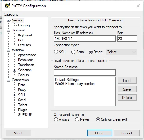

2. Hard code po sa Using PUTTY
- open your installed PUTTY; below ip:192.168.1.1 , port 23, click open
- you will be asked with user name and pass; username: root while password: root123
- command to openline

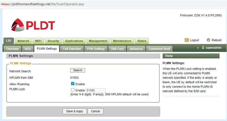

PLMN locking and setting of PLMN ; 1 = enable; sample DITO PLMN Below
nvram_set 0 sqns_selplmn_enable 1
nvram_set 0 sqns_selected_plmn 51566
nvram commit 0

Sakin Paps Unchecked Na Yung PLMN Lock Pero Ayaw Padin Gumana
May mga naka gamit na po neto na ibang sim sa kabila kong thread. Ty dun po sa advise
Ikaw yun tinatanong ko TS kung nasubukan mo na mismo sayo at may screenshot ka na may signal yun openline mo kamo sa 2993. Ayan may nag reply na sayo na hindi gumagana.
Anyway, para dun sa iba, permanent network locked sa Smart ang 2993, kahit anung nvram set ang gawin ninyo sa console, kaya walang signal na masasagap ang ibang sim maliban sa Smart sa version 2993.
