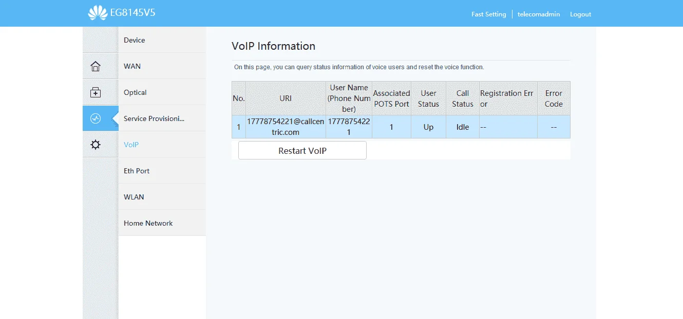

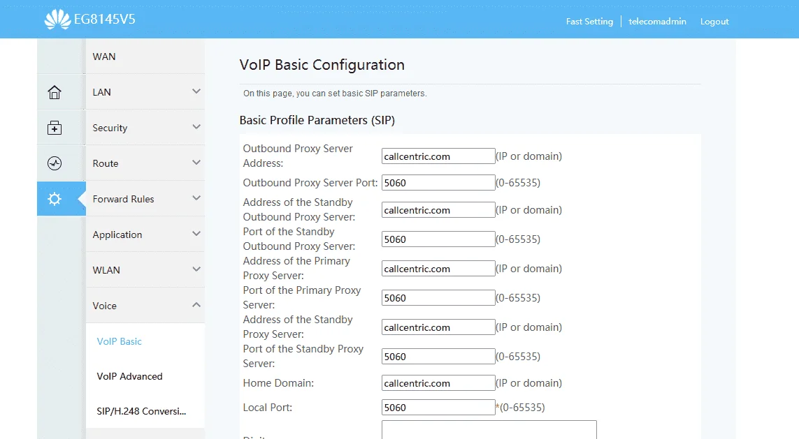

Sa mga Converge Fibr X dito, sulitin natin ang features ng Huawei Modem natin, paganahin natin ang telephone port, Powered by CallCentric.
This features have free incoming & outgoing calls, Callcentric to Callcentric. Let's use our Huawei Modem features.
1. Just register first at You do not have permission to view the full content of this post. Log in or register now.
2. Login to your huawei modem
3. Go to VOIP setting and that's its.

Delete mo lang yung internet dun, tapos gawa ka ng panibago, pero instead ng INTERNET nag pipiliin kagaya ng dati, palitan mo ng VOIP + INTERNET, vlan 10 padin..kung my problema , pm mo ako
Thank you paps working na ung sakin, di kk na binjra existing na internet pero nag add lang ako voip, additional lang para magamit sa local sya, kung marunong ka mag voip pwede mo maconnect sya sa local phone number satin callcentric forward to raspbx, then max extension ata na pwede mo magawa ay 25, xmpre di mo sga magagamit dahil u.s voio sya, download ka lang sa cp mo ng zoiper then magkakaron ka mg voicemail
