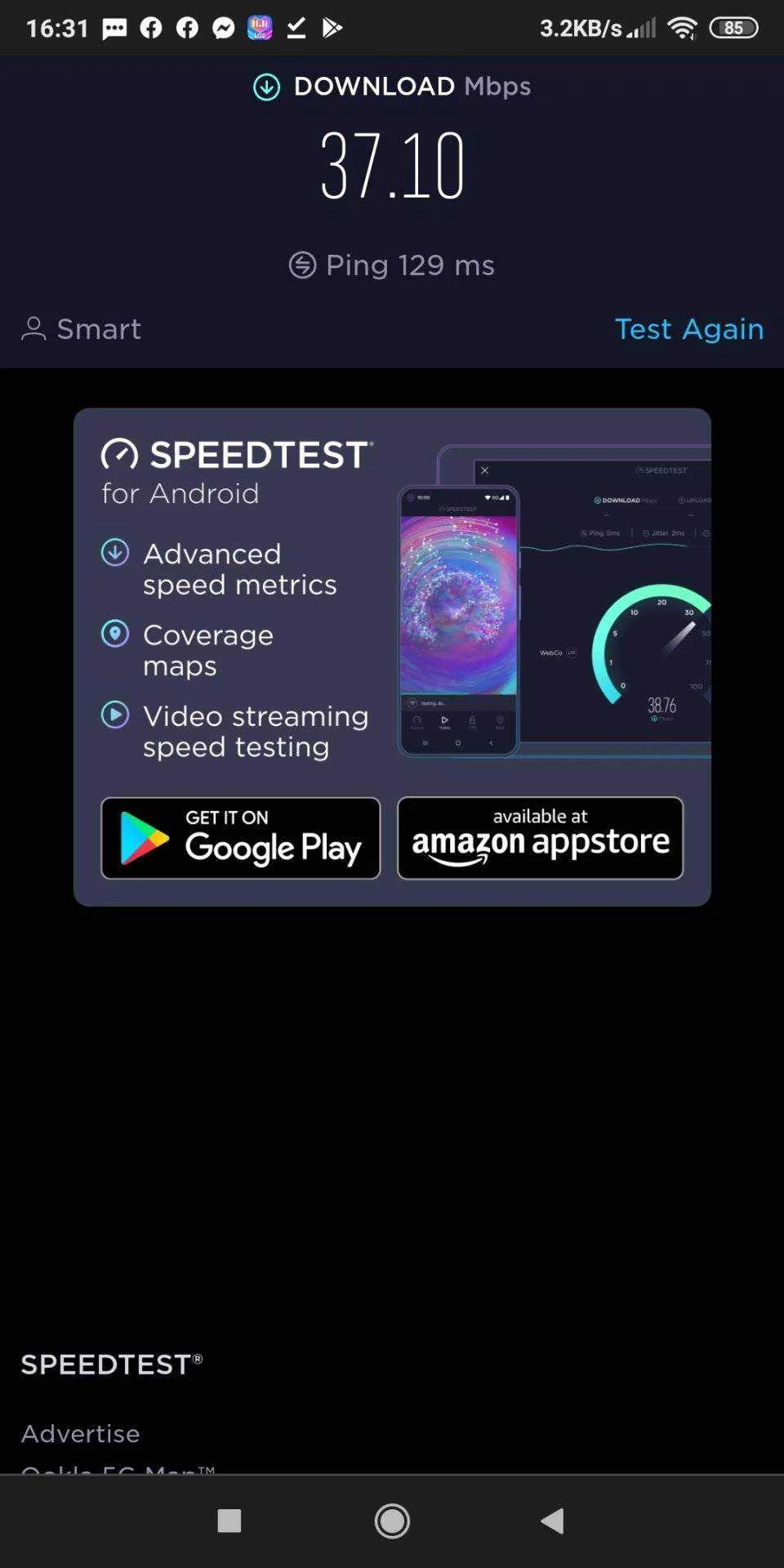

bakit kaya pag magspeedtest ay nawawala yong connection?
Naka-external antenna modification ka ba? If yes, normal occurrence siya, pero dapat sa mga succeeding speed test mo using Ookla hindi na dapat mawalan ng signal.
Tapos dapat isolated lang siya sa Ookla speedtest at hindi ka maka-encounter ng ganitong issue sa fast(dot)com and OpenSignal.
Hindi din dapat mawalan ng signal pag nag-speedtest ka ng hindi naka-kabit yung external antenna mo or if your using the internal antenna.
Here are some suggestions to prevent/fix this issue.
a. Change the default internet Protocol to IPV4 from IPV4/V6 (default)
b. Upgrade stock power supply (12V 1A) to beeferier 12V 2A AC/DC adapter
c. Add power surge protector, AVR or UPS. (AVR will be fine, cheap and reliable)
Ayun lang, LODI. hopes this help. 😁
