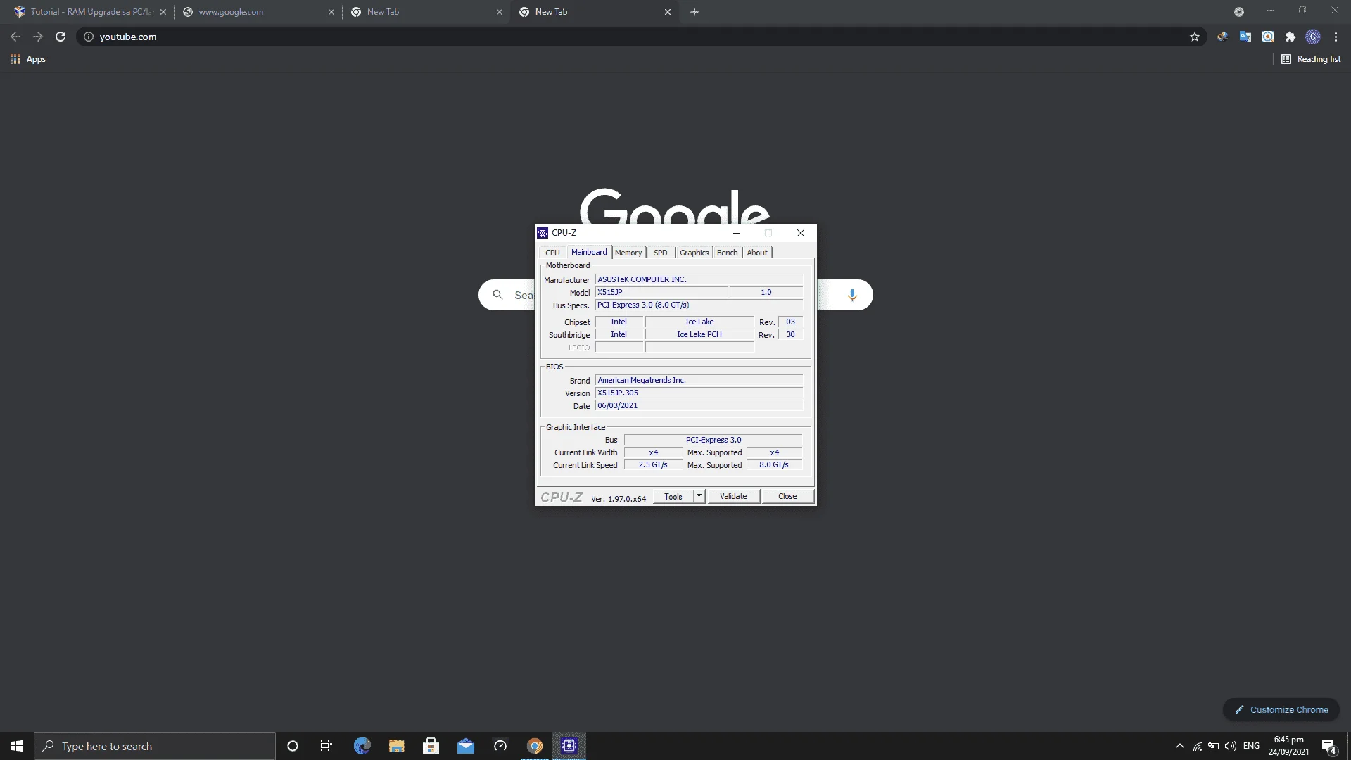

1. CPU-Z (download and install)

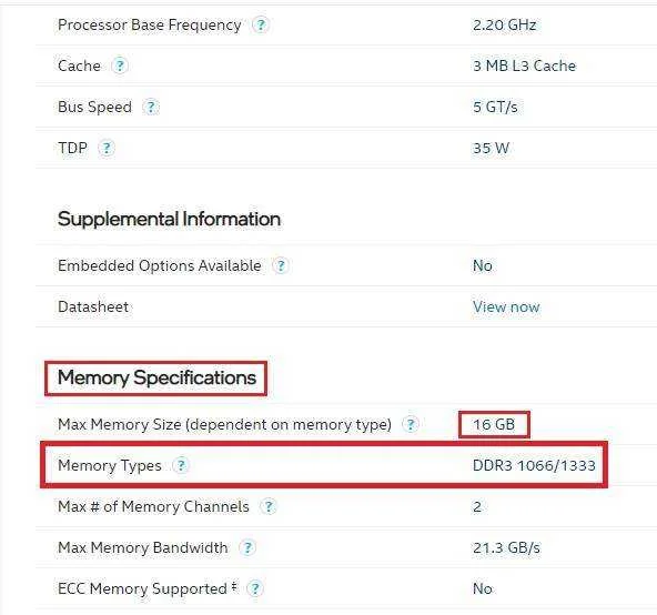

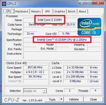

2. Check Processor (CPU) specs
sample: i3 2330M
option 1: computer (right click),open properties or
use nyo CPU-Z (option 2)
3. Search type ng ram at speed na supportado ng MOBO/CPU (ddr2, ddr3, ddr4 /1066/1333/1600/1866 etc)
sample: DDR3-1333 (ito lang kaya ng cpu ko)

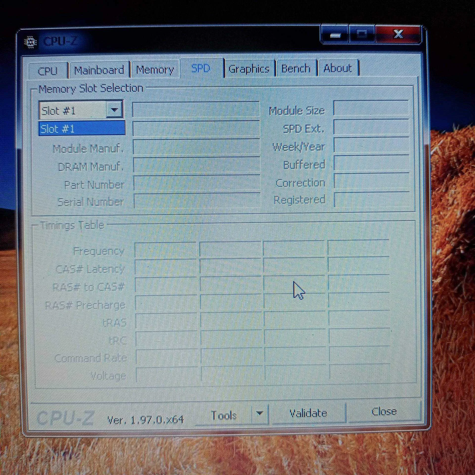

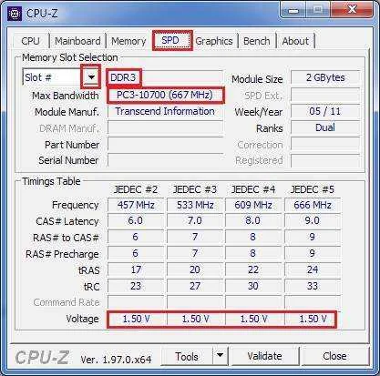

4. Paano malaman yung RAM na nakasalpak (speed/manufacturer/volts)
gamit CPU-Z sa SPD tab
notes:
DDR3=1.5v
DDR3L=1.35v
PC3=1.5v
PC3L=1.35v
Kung nakalagay ay
PC3-10700 ay equivalent 1333MT/s (Mega transfer per sec) or 1333MHZ
divide nyo lang 10700 sa 8 (approximate)
divide 1333MHZ sa 2 kasi dual = 667MHZ
PC3-6400=800MHZ (or MT/s) 400MHZ
PC3-8500=1066MHZ (or MT/s) 533MHZ
PC3-12800=1600MHZ (or MT/s) 800MHZ
PC3-14900=1866MHZ (or MT/s) 933MHZ

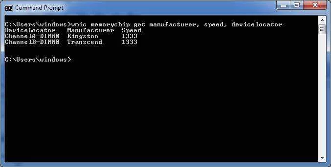

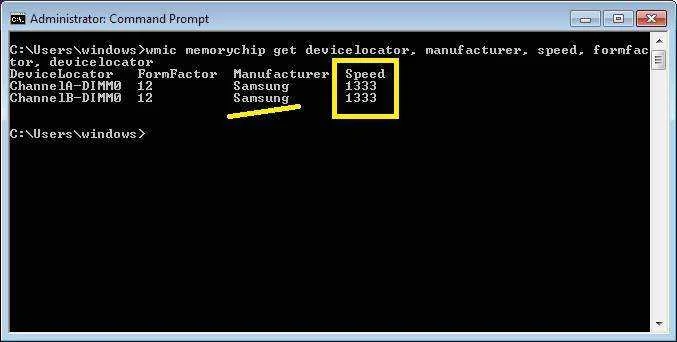

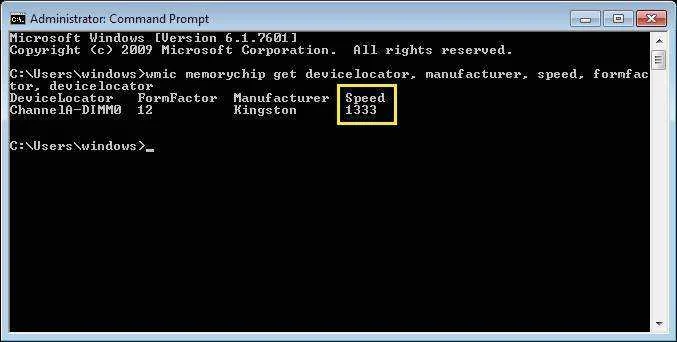

5. Paano malaman yung RAM na nakasalpak via CMD (speed/manufacturer/locator)
gamit CMD type code below
Summary: i3 2330M = 16gb MAX= DDR3 only = 1333MHZ speed= 1.5v or 1.35v

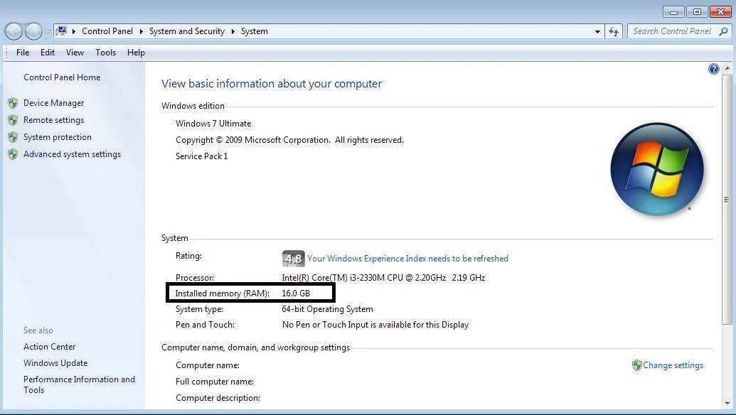

6. MAX Capacity via OS (operating system)

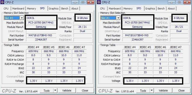

UPDATE sa aking pag UPGRADE
a. my cpu max=16Gb ddr3 1333MHZ
b. my mobo max=8Gb ddr3 1600MHZ (speed capped to 1333MHZ due to cpu limits)
c. via cmd max=16GB
d. voltage supported 1.5v and 1.35v (as per old RAM used)
final: bought 2 x 8GB DDR3 1333MHZ 1.35v
bakit hindi 1600MHZ kinuha ko kasi useless at sayang pera kung limitado sa 1333MHZ
bakit 16GB at diko sinundan yung max ng MOBO? Personal risk kuna since luma na to at personal test kung kaya nya ihandle as per max sa cmd command

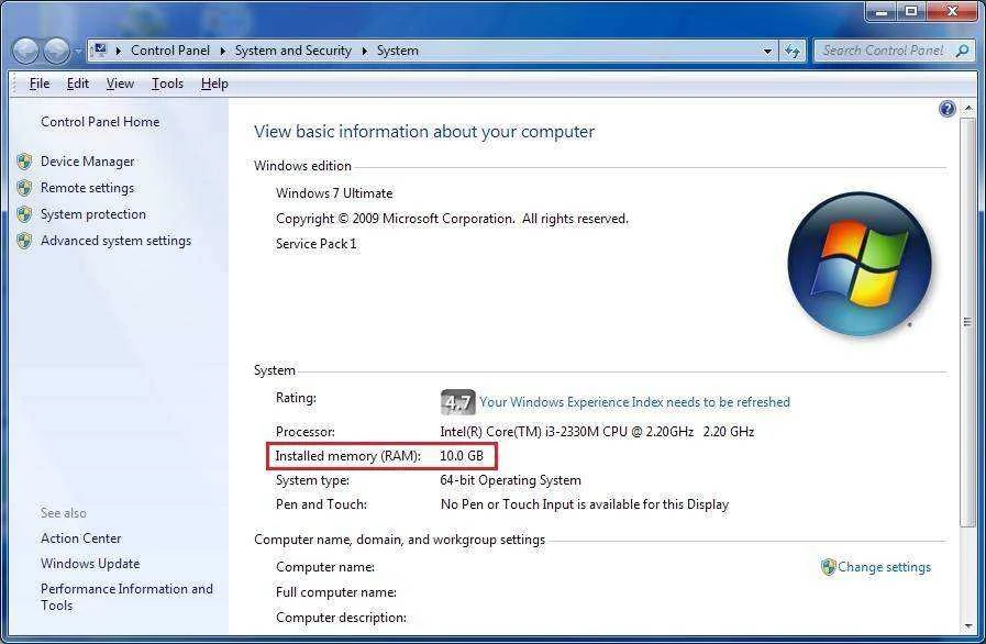

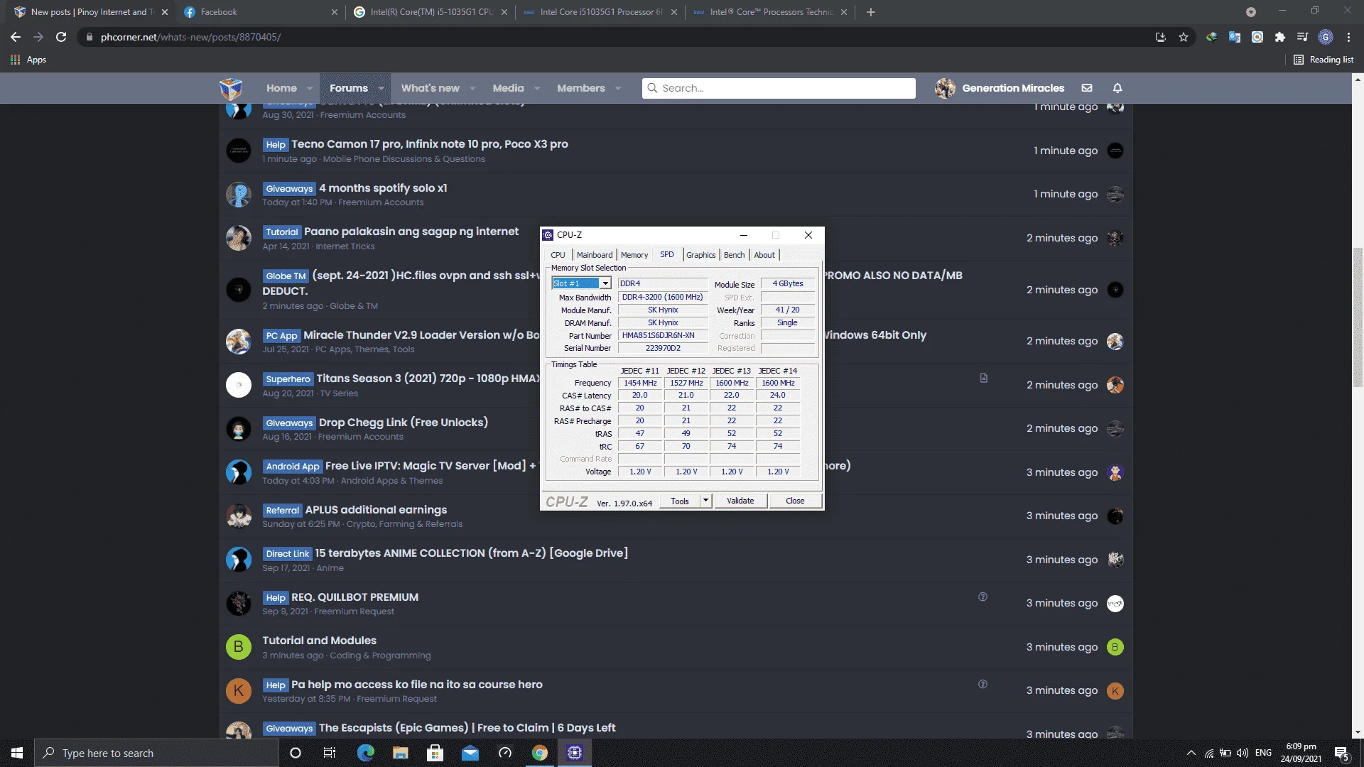

Result:
1. bootable/usable lahat
2. cpu-z
3. Computer properties
Kung bago pa mga unit nyo stick muna kayo sa manufacturer specs sa limit ng Mobo/CPU since yun palang fully tested nung narelease.

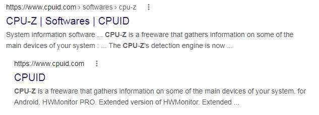

Tools:
Steps:

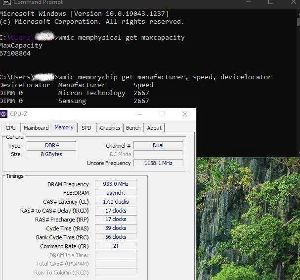

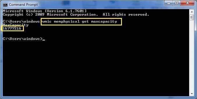

1. Check Max capacity ng RAM na kaya ng PC/Laptop nyo
open cmd type code below then press enterwmic memphysical get maxcapacity
value in kilobytes divide nyo lang sa 1024, divide ulit sa 1024 yun na yung total GB ng Ram-or gamit online conversion
sample sa taas = 16GB Max Ram capacity2. Check Processor (CPU) specs

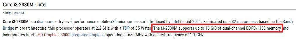

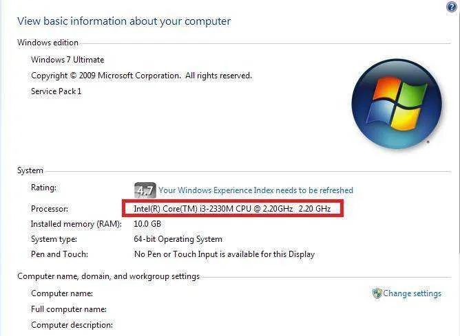

sample: i3 2330M

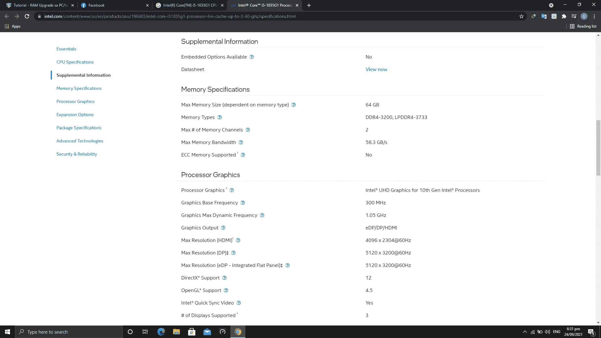

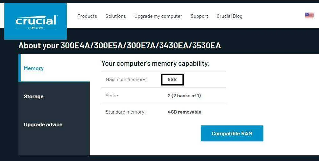

Mobo Max via Crucial (8GB lang max)
note: Yung MOBO ko max capacity 8GB at reco gamitan ng 1600MHZ kaso yung nasalpak na 8GB 1600MHZ downgraded sa 1333MHZ kasi yun lang limit ng CPU ko

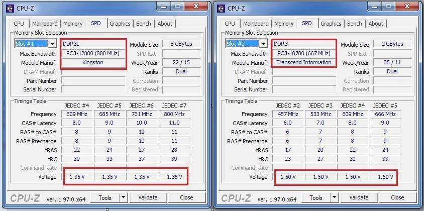

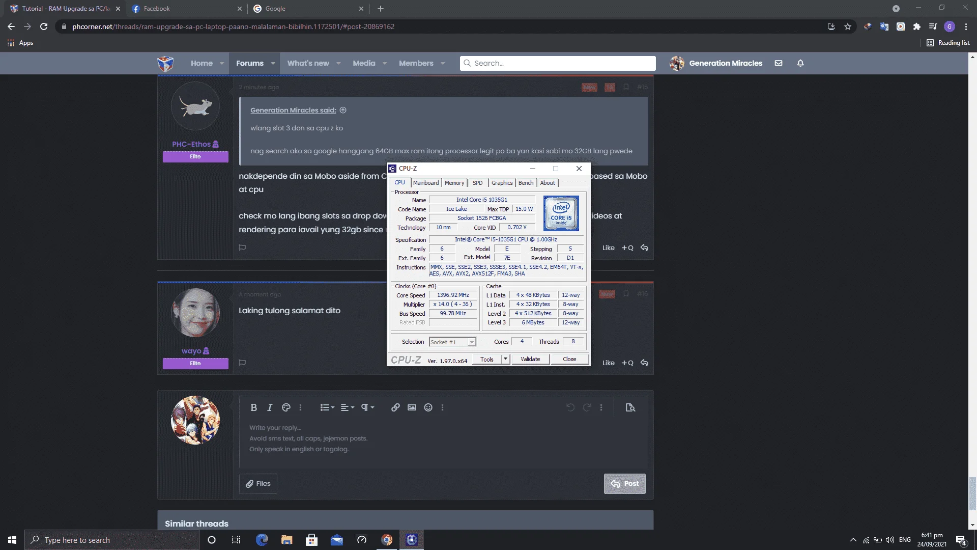

notes:
DDR3=1.5v
DDR3L=1.35v
PC3=1.5v
PC3L=1.35v
Kung nakalagay ay
divide 1333MHZ sa 2 kasi dual = 667MHZPC3-6400=800MHZ (or MT/s) 400MHZ

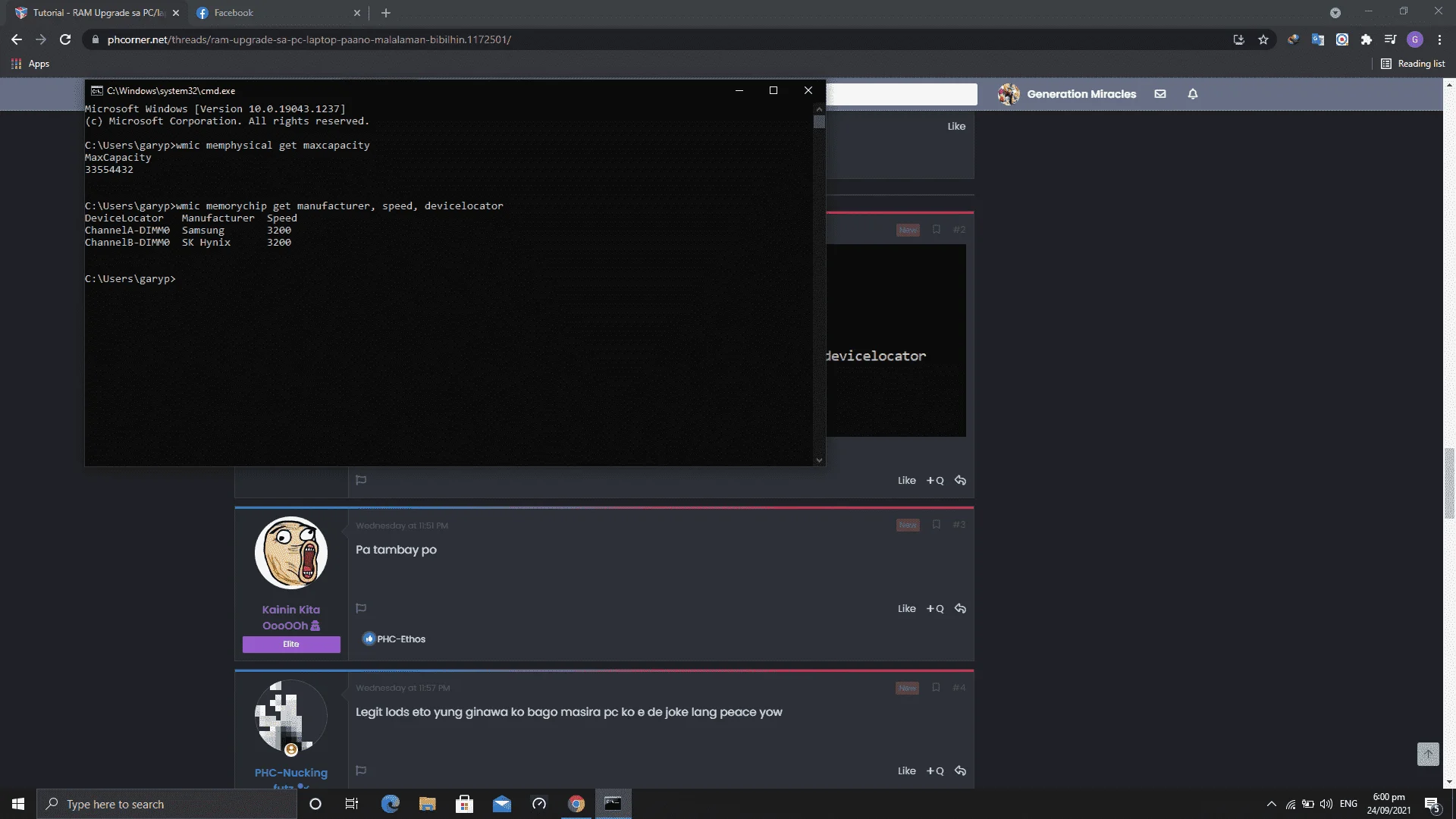

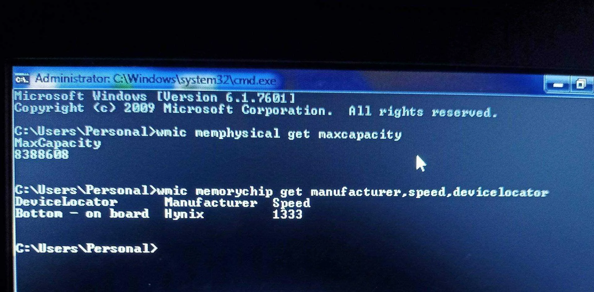

gamit CMD type code belowwmic memorychip get manufacturer, speed, devicelocator

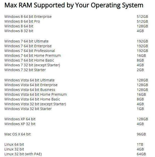

Summary: i3 2330M = 16gb MAX= DDR3 only = 1333MHZ speed= 1.5v or 1.35v6. MAX Capacity via OS (operating system)

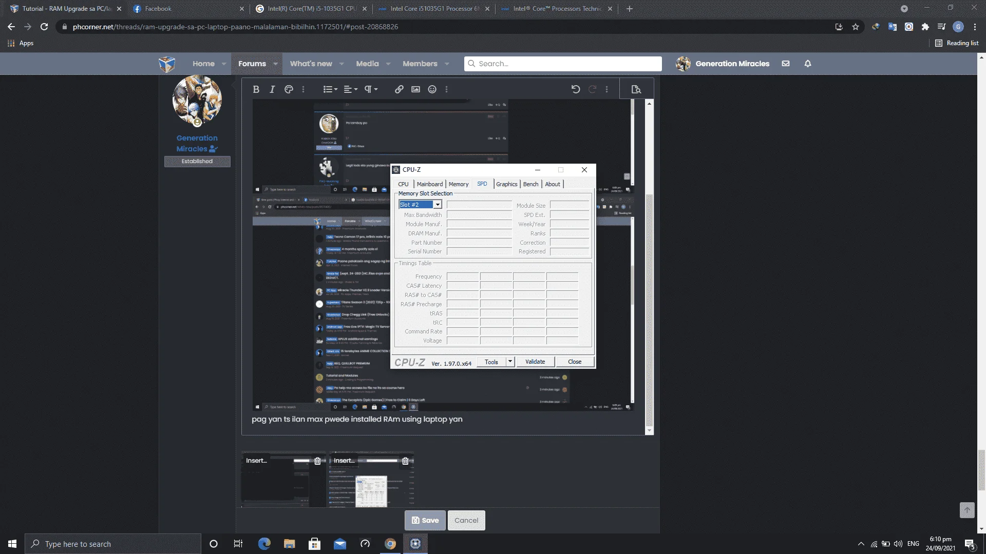

, bat ganto naman po saakin master blank po yung part ng SPD sa may CPU-Z po naka run as administrator namn po?
