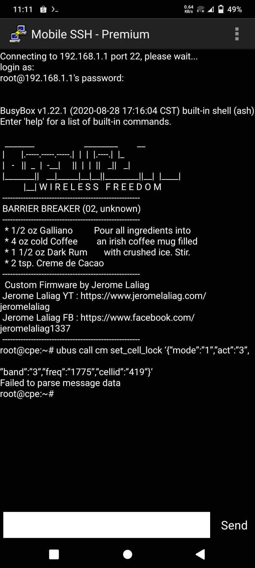

Eto yung mga Band LODS
Band 3/1 using Ubus
ubus call version set_atcmd_info '{"atcmd":"AT+ZNLOCKBAND=1,0,5,0"}'
Frequency Lock to 1775 using Ubus command in telnet/ssh
ubus call version set_atcmd_info '{"atcmd":"AT*CELL=1,3,3,1775,0"}'

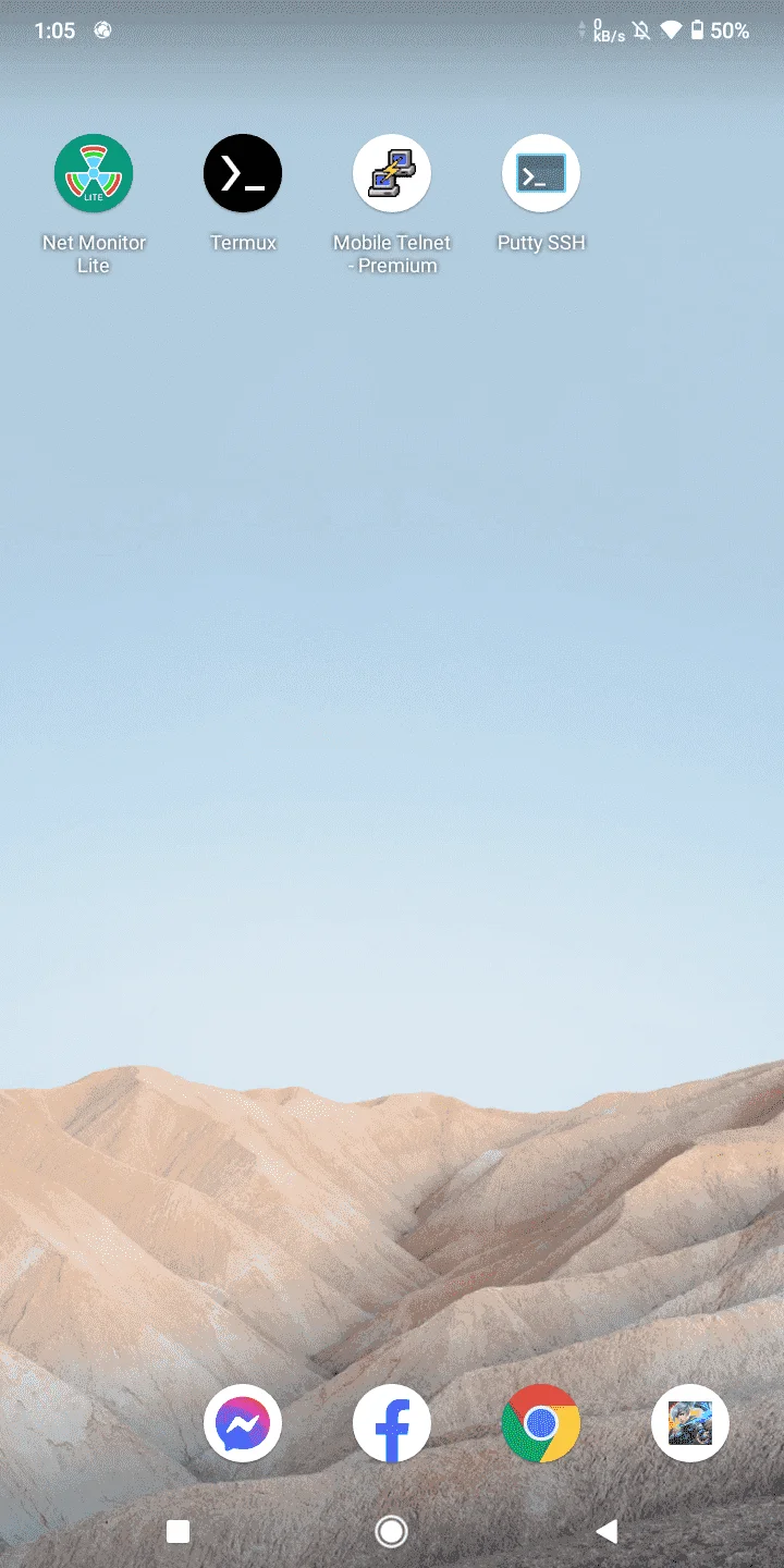

tanong lang boss pano paganihin yung mobile ssh and may link ka ba?
patut boss gusto ko sana palitan band 41 sakin kase mabilis kase nagpapalit palit sya ng band e
Ano pala wifi modem r051/r281
Ano version firmware Baseband mo, Lods. Para malaman agad kung ano pwede gawin jan. Na unlock mo na Telnet mo
