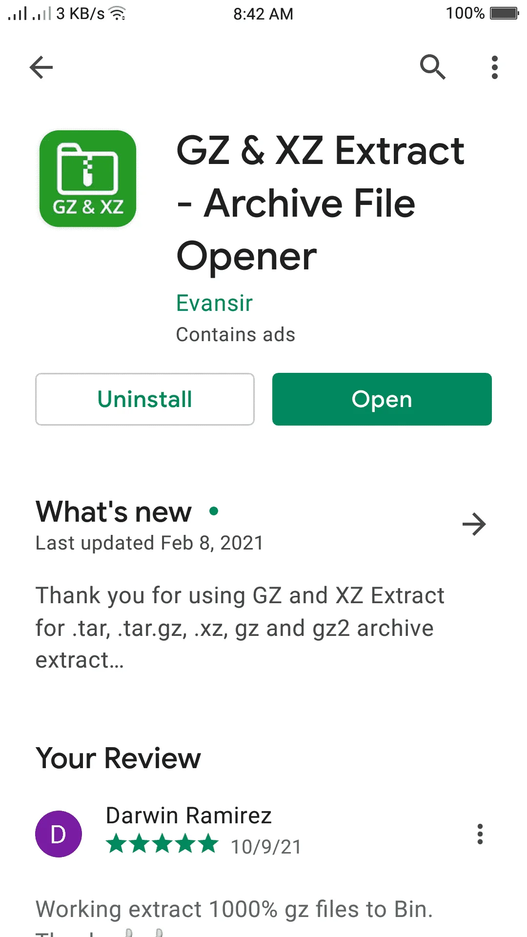

Paano ba yang bin file lods?
Lodi, Sa Termux/ssh command yan Lods, magiging bin file ung mtd.gz kung gagamitin mo yung mtd write na commands
Pero pwede mo naman i extract yang gz file using gzip apps magigin bin file

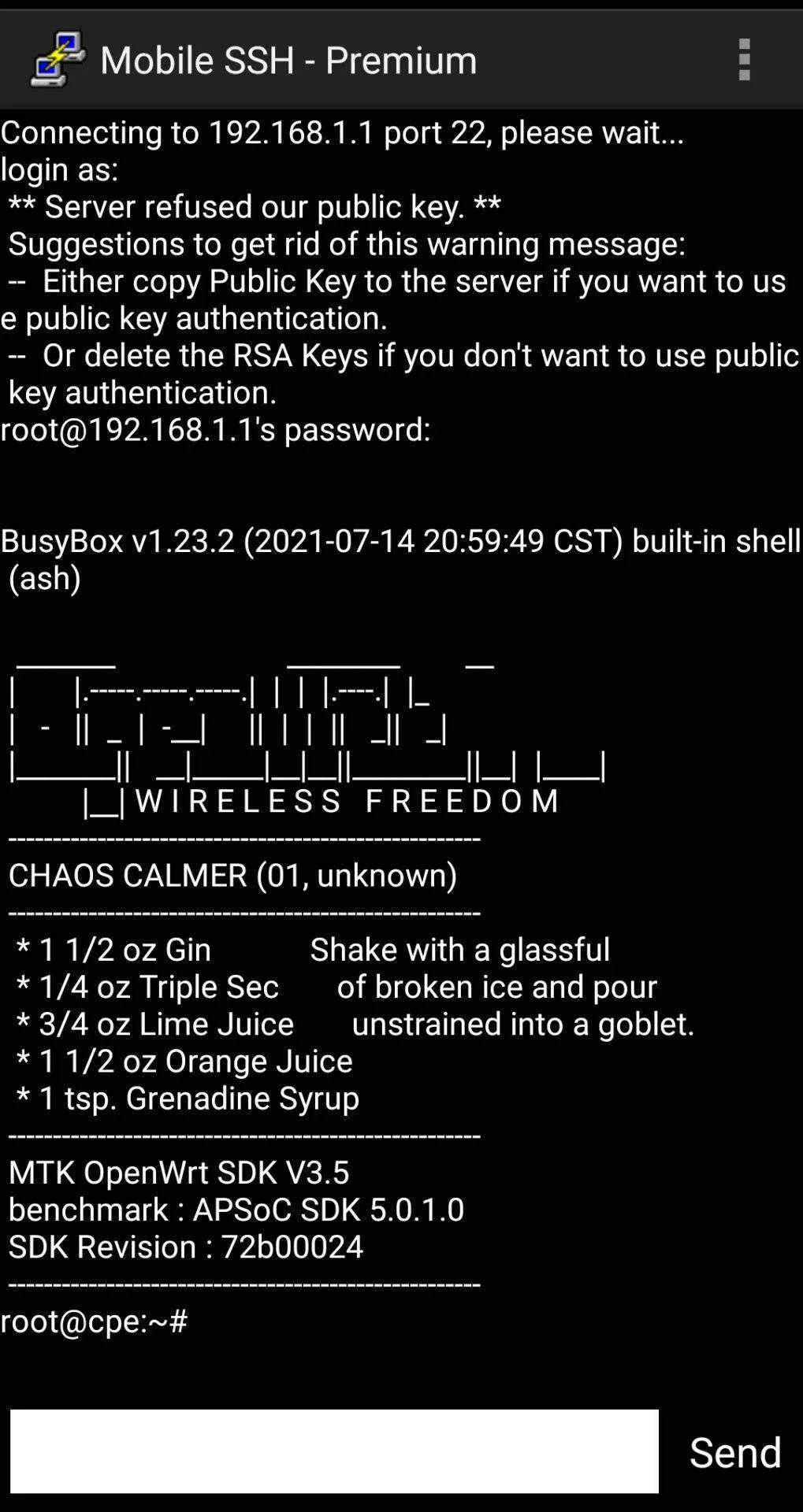

Eto pala yung commands Lods in short way
Sample yan sa firmware2 naman na extract, yung v4.2 nadowngrade to firmwarw 4.1, pero yung baseband 2.2 pa rin, hehe
cat /dev/mtd7 > /tmp/firmware.bin
Kapag natapos,
mtd -r write /tmp/firmware.bin /dev/mtd4
