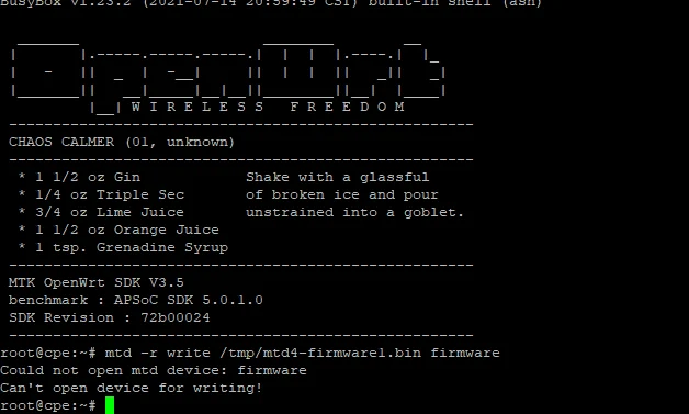

Try mo palitan ng firmware1
Example:
mtd -r write /tmp/{firmwarename} firmware1
Kapag ayaw, dahil running or gamit pa ang firmware1, try mo direct sa /dev/mtd4
Example:
mtd -r write /tmp/{filename} /dev/mtd4
noted master. thank you. nagwork po yung firmware to firmware1
Ganito yun
Mukhang eto Susunod na Command Lods, overwrite mo rin yung /temp/mtd4.bin to dev/mtd4
mtd -r write /tmp/mtd4.bin /dev/mtd4
