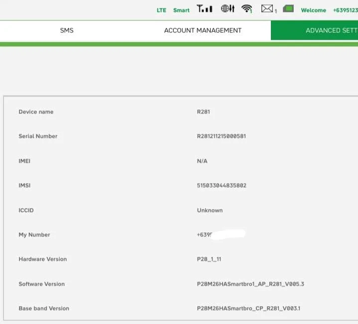

Current Situation:
R281 ko is may signal pero NO IMEI at DISCONNECTED lang sya meaning walang net pero openline 🤣 at naka latest version (5.3 , bb 3.1)
Pano nangyare?
1st. Nag flash ako firmware via RESTER at nag openline (delete IMEI) pero nakalimutan ko mag flash ng CP. so 3.1 parin baseband nya. Di pwede mag flash via TFTPD. Hindi ko maflashan ng CP pang downgrade kasi DISABLE na yong OTA 😮‍💨
2nd. Naisip ko na ibalik ko sa STOCK FIRMWARE para ma-enable ulit yong OTA nya para madowngrade ko yong baseband. At ayun na nga nawala na sa isip ko yong IMEI ko nga pala is wala 🤣 Nag success naman ang flashing ko via telnet from DISABLED OTA to STOCKFirmware 5.3.
Last. Ayun. di ko na magawa 🤣 Stock na sya sa 5.3 bb 3.1 which is wala ng telnet, at hindi din pwede mag flash via TFTPD, at ito malupet, walang OPENLINE , NO IMEI , NO DATA na napasok 🤣
baka may nakakaalam po dito? willing to learn po 🤣

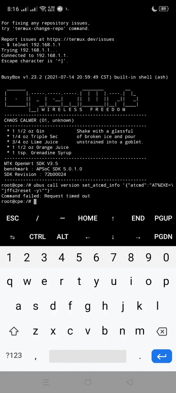

madili lang ibalik kahit walang IMEI at Internet
basta may access sa ssh
Code:
 cat /dev/log_radio|grep "\[RIL1\|\[rild\|AT cmd"
Code:
ubus call version set_atcmd_info '{"atcmd":"AT*MRD_IMEI=U,0101,01NOV2012,IMEI"}'

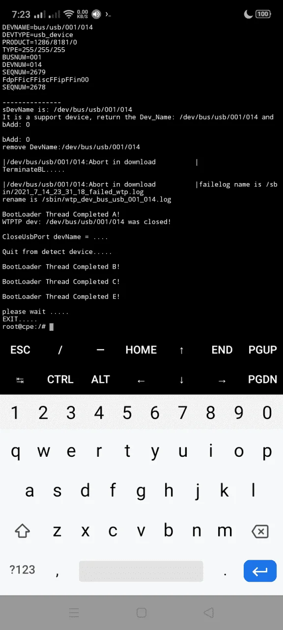

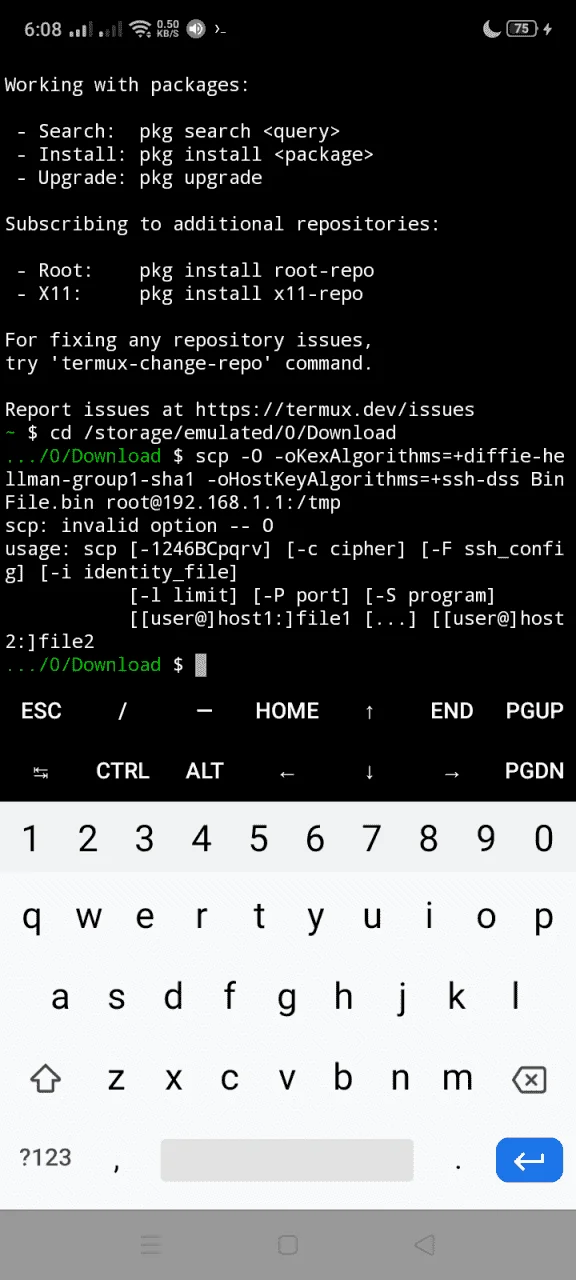

download mo yung BinFile dito You do not have permission to view the full content of this post. Log in or register now.
tapos sundan mo yung nasa sa video
Code:
scp -O -oKexAlgorithms=+diffie-hellman-group1-sha1 -oHostKeyAlgorithms=+ssh-dss BinFile.bin root@192.168.1.1:/tmp
Code:
fbfdownloader_cross -b /tmp/BinFile.bin
Code:
echo 1 > /sys/class/leds/reset_cp/shot

Gayan nalabas sir...

Ganyan nalabas sir
