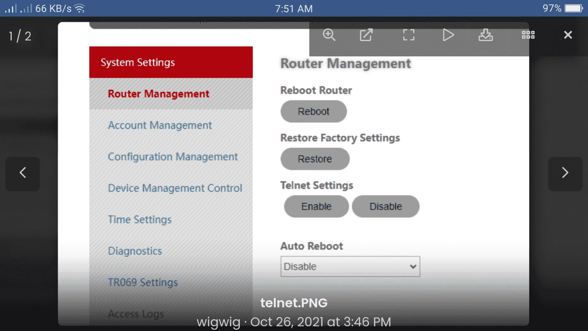

Nanjan sa image yung dahilan, click telnet to enable nalang. Hehe

after enabling telnet...
LOG IN TO TELNET
COPY and RUN these codes:
ubus call router set_dropbear_info '{"dropbear_mode":"1","dropbear_key_type":"99"}'
ENTER DESIRED PASSWORD
fw_setenv dropbear_password your created pw
EXAMPLE: fw_setenv dropbear_password root
DISABLE TELNET AFTER CHANGING PASSWORD
ubus call wireless wifi_ate_disabled
LOG IN TO SSH (USE PUTTY FOR WINDOWS)
vim /etc/init.d/services.init
NOTES: press 'i' to enter insert mode, do your edits # to comment out a line.
Then press ESC to enter normal mode again, then ":wq" to save and exit. If you made some mistakes you press ":q!" to quickly exit without saving, ":q" to also exit a file.
Also in normal mode you can press "dd" if you want to delete a line rather than commenting it out; keys h,j,k,l also acts as navigation keys in normal mode.
COMMENT OUT TR069 command using #
COMMENT OUT OTA command using #
SEE PAGE 28 by master LENAR
OPTIONAL: (by MASTER H4WK)
DISABLE TR069 Disclaimer: Not yet proven but until now modem not updated. Perform at your own risk. So far walang negative effect sa modem ko.
1. ssh 192.168.8.1
2. type cd //
3. type cd etc/config
4. type vim tr069 (vim is a linux text editor). below text will appear on console: config tr069 option tr069_enable '1' option dimcomplete '0' option boot_state '0' option acs_mreboot '0' option conn_name 'roy' option conn_psw 'roy' option acs_url 'You do not have permission to view the full content of this post. Log in or register now.' option acs_username 'notion' option acs_password 'notion' option inform_enable '1' option inform_interval '300' option manufacturer 'Mavell' option model 'L20_1826_p704' option oui '123456'
5. edit option tr069_enable '1' here's how to edit vim. - press insert - move cursor to the text to edit using arrow keys - edit text to option tr069_enable '0' - press ESC -type :wq (that's colon + "wq")
6. DONE! -Other options I think is to comment out everything using "#" or delete the tr069 file but I haven't done these 2 yet. - there's also a file named " Firewall" in the same directory (etc/config), you can also use vim to edit the text and edit "ACCEPT" to "REJECT" or again comment out all the text using "#" yan ung last lods
credits to all the masters
restart modem after enabling
