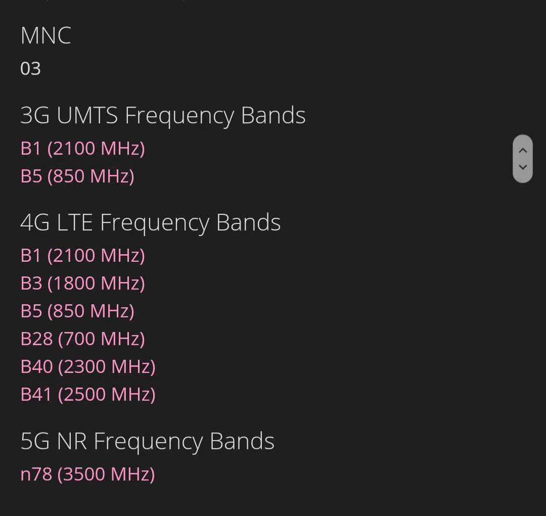

salamat! oo ako din mas okay yun znlockband. disable lang yun 40,41 oks na. palit-palit na sya dun sa remaining bands.
check tower mo din kasi yung tower ko band 1,3,40 lang meron tas dinisable ko na lahat maliban sa 1 and 3 naconnect kasi sa band 5 na mas malayo tsaka mas mahinang tower. ayun mas sulit para di na magpalit palit pati tower. sulit sa rocket sim kakarating lang kanina stable 50mbps with antenna naabot 130mbps sa madaling araw

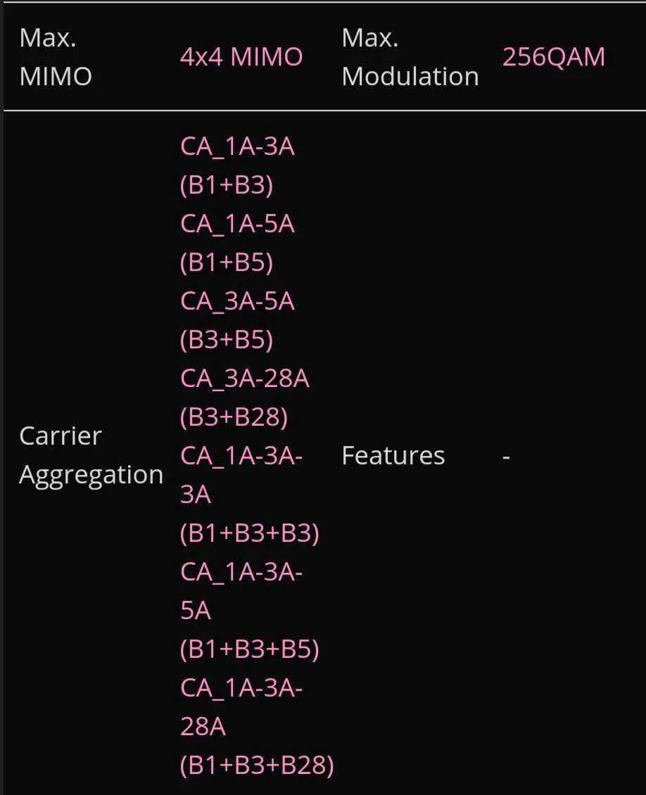

AT+ZNLOCKBAND is to disable other LTE Bands. This is not for Carrier Aggregation SMART LTE have total 6 LTE Bands Band 1 Band 3 Band 5 Band 28 Band 40 and Band 41. With AT+ZNLOCKBAND you can disable Bands that has poor/bad reception and enable just the Bands that has strong connection in your area.
