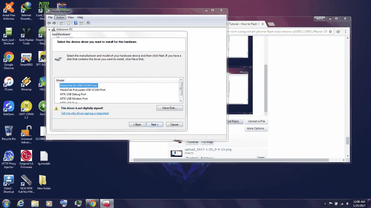

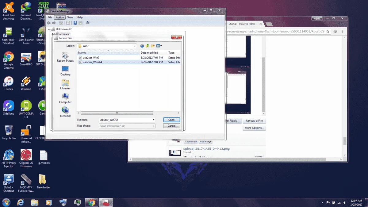

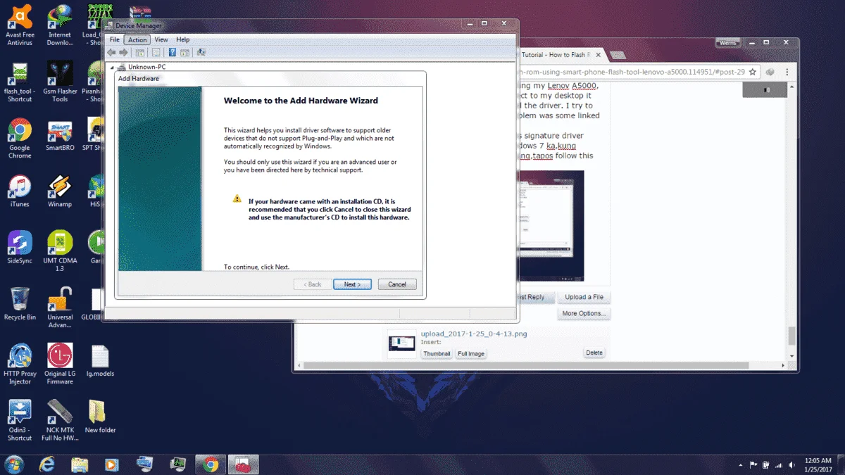

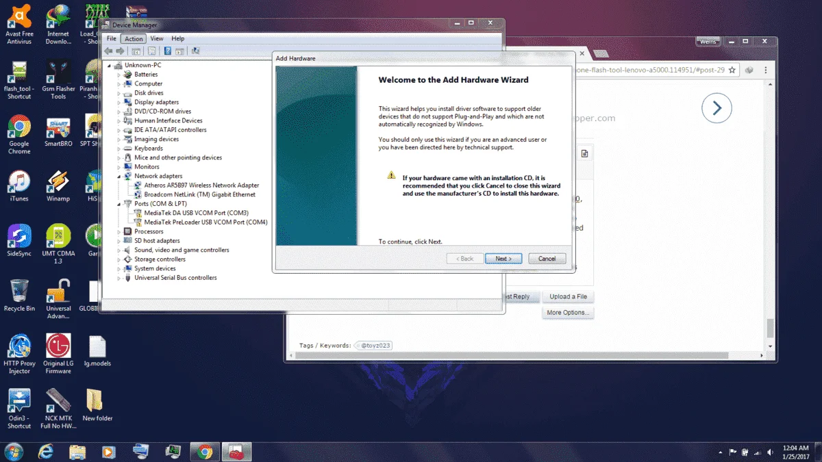

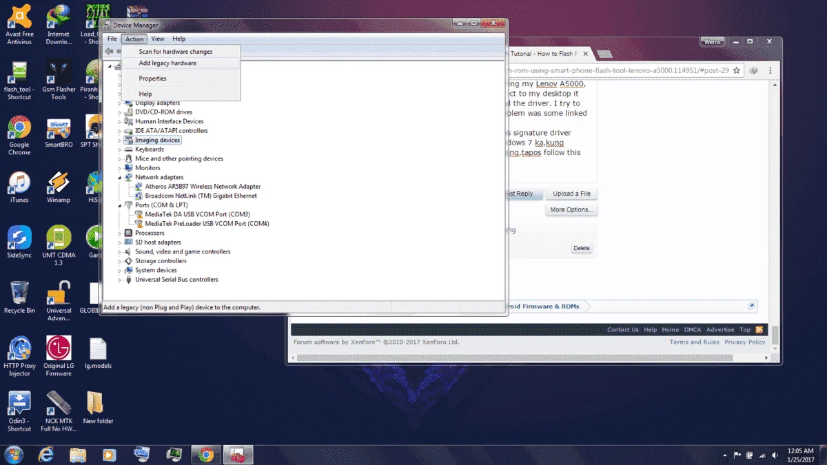

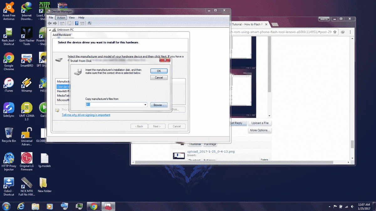

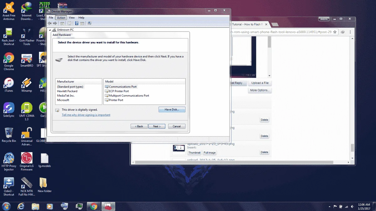

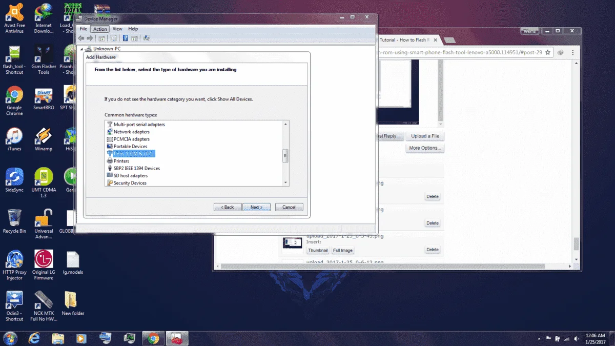

ok lang yun ts ayos na phone ko problema ko ngayon is pang.root naman inupdate ko kc sa lollipop 5.0.2,tska windows 8.1 pro 64bit gamit ko disable lang yung signature verification nung driver yun lang para malaman ng iba.
Sir please help, after flashing my Lenov A5000, the unit can't power on. I will connect to my desktop it will pop always but they can't install the driver. I try to follow your steps above but the problem was some linked was not able to access.
simple lang yan disable mo windows signature driver pag.startup press f8 kung nasa windows 7 ka,kung windows 8/10 nman google mo nalang,tapos follow this images instructionupload_2017-1-25_0-5-32.webpupload_2017-1-25_0-5-45.webpupload_2017-1-25_0-6-12.webpupload_2017-1-25_0-6-30.webpupload_2017-1-25_0-6-53.webpupload_2017-1-25_0-7-20.webpupload_2017-1-25_0-7-48.webpupload_2017-1-25_0-8-32.webp
select mo yung pangalawa pagkatapos mainstall yung una,same procedure..spoonfeed nayan brother kung hindi mo parin nakuha click this link You do not have permission to view the full content of this post. Log in or register now.
