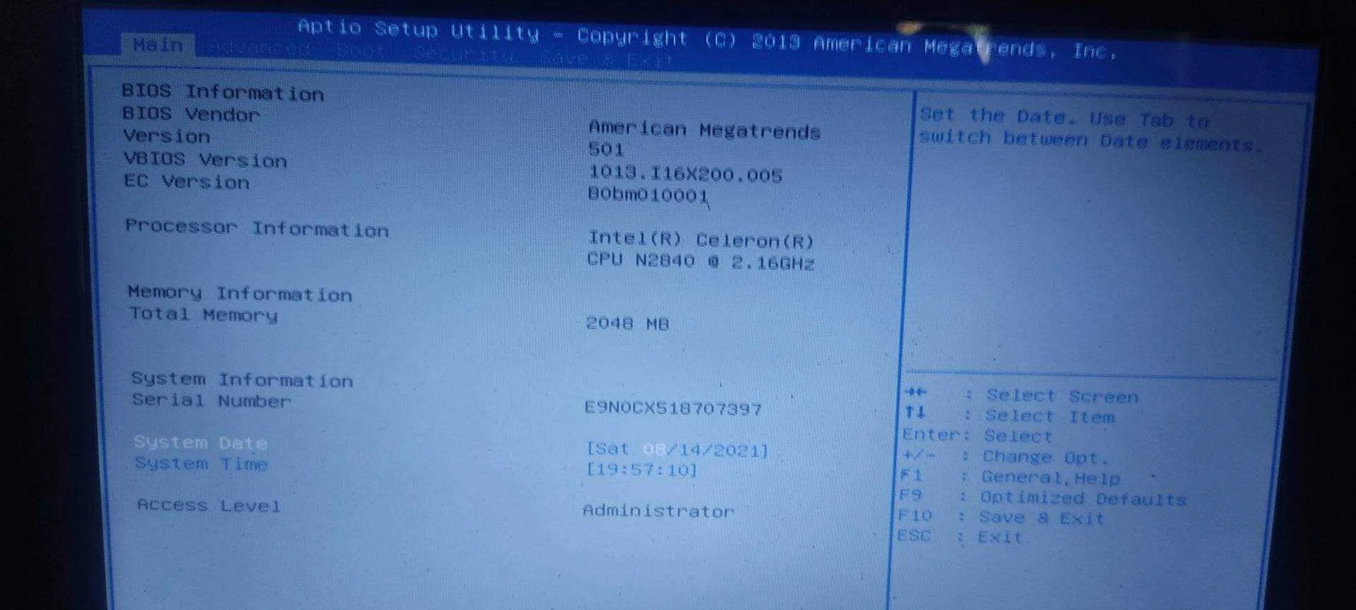

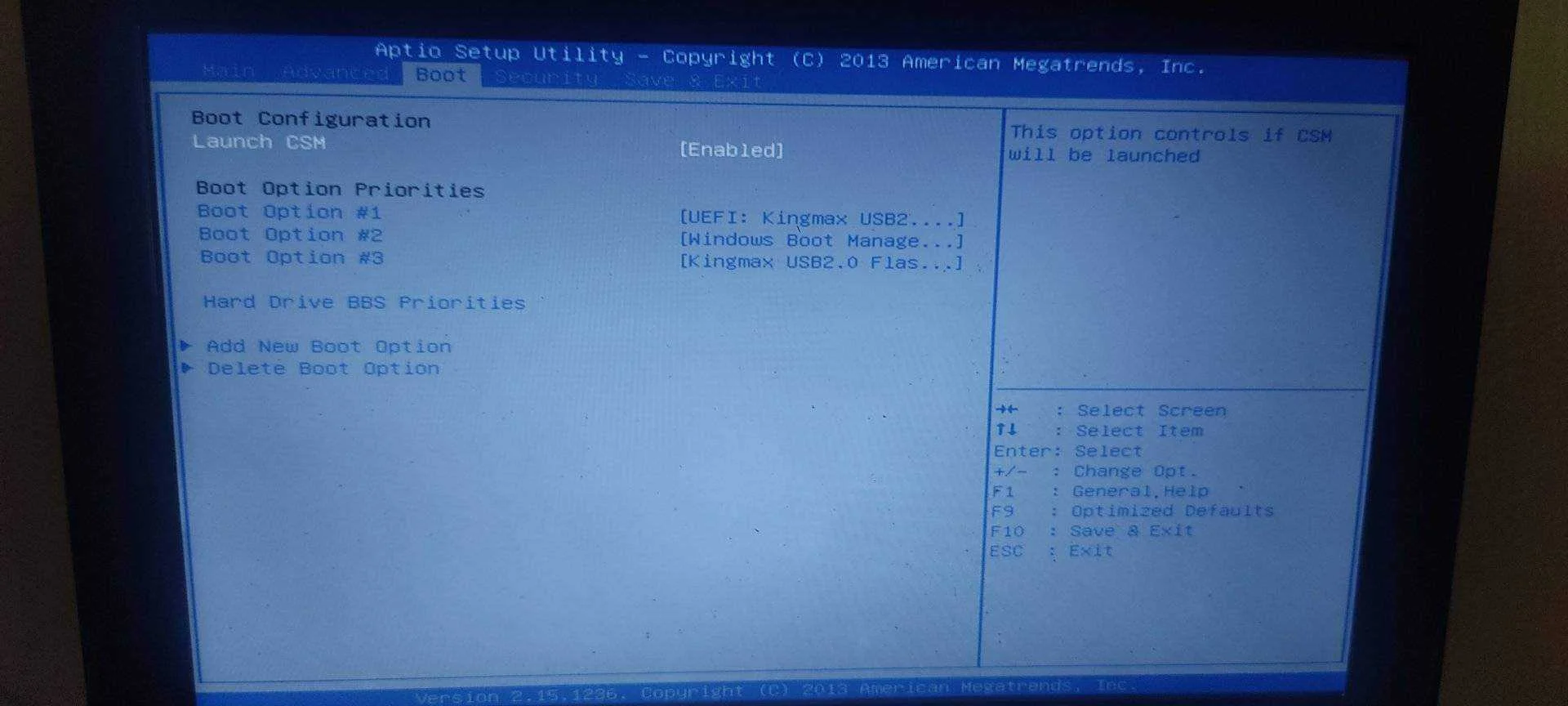

Nakawin 10 ako ngayon kay ghostspectre gsto ko sana downgrade to win7 ultimate redshift kaso d ngpoproceed sa installation pagkatapos masetup boot order dretso agad sa login panel ...pano kaya to asusx200m laptop ko. help sa techyIMG_20210815_105711.webpIMG_20210815_105720.webp

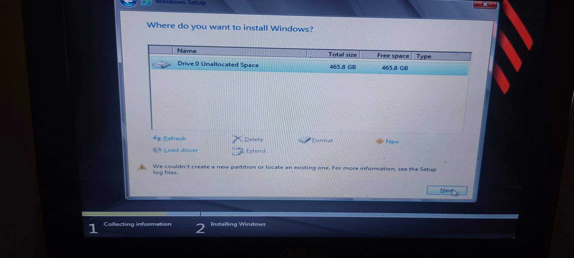

Bakit ganito mga paps nagclean install ako pero d ko mainstallView attachment 1523804
press shift + f10 then type diskpart
list disk
select disk x [NOTE: x is disk number and it start with 0. ex: "select disk 0"]
clean
create partition primary size=5000
format fs=ntfs
assign
active
list volume
exit
cd x: [NOTE: x is drive letter of your USB that shown in list volume for ex: hdd = ltr C then USB = ltr E, so it will be "cd e:" ]
xcopy e: c:/e /h /k
then close command prompt and repartition mo ulit

thank you paps salamat dito
pero kasi hindi nadedetect ang usb ko wala ako pagpipiliang os "kasi no drivers found daw ata" kaya d ako makapagproceed jan kelangan ko pa mag manual install ng drivers na usb3 para mabasa yung usb kaso everytime na nagdiskpart tpos clean syempre mabubura din yung drivers na ininstall ko kaya d madetect yung usb ko
try mo gamitan ng windows image tool for win 7. search mo sa google yan
