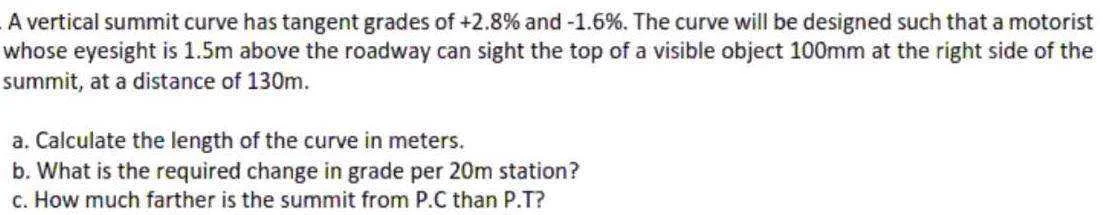

II.
Question: A vertical summit curve has tangent grades of +2.8% and -1.6%. The curve will be designed such th...​
Show transcribed image text

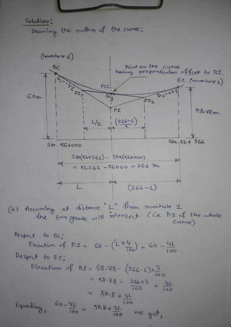

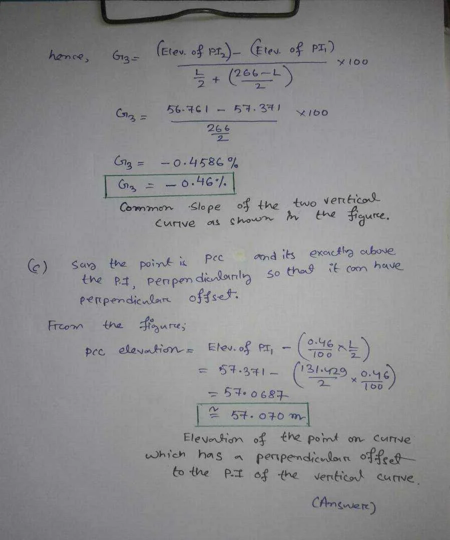

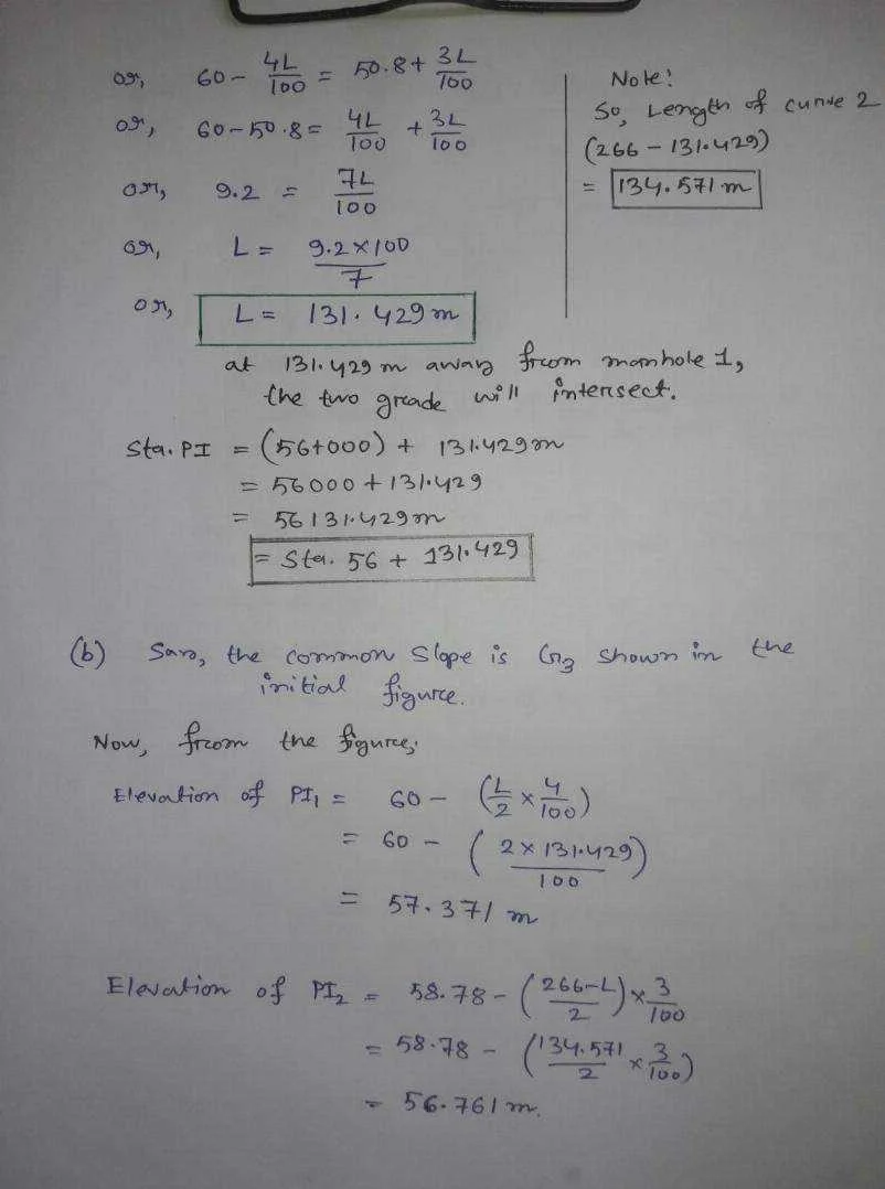

III.
Question: A vertical curve must begin at the center of manhole 1 (sta. 56+000, at elev.60m ) and end at man...​
Expert Answer​
    Anonymousanswered this
    Was this answer helpful?
    Thumbs up inactive
    0
    Thumbs down inactive
    0
    2,466 answers
    1607068575875_Document5_7_2.webp1607068595250_Document5_8_2.webp1607068609615_Document5_9.webp
    Comment

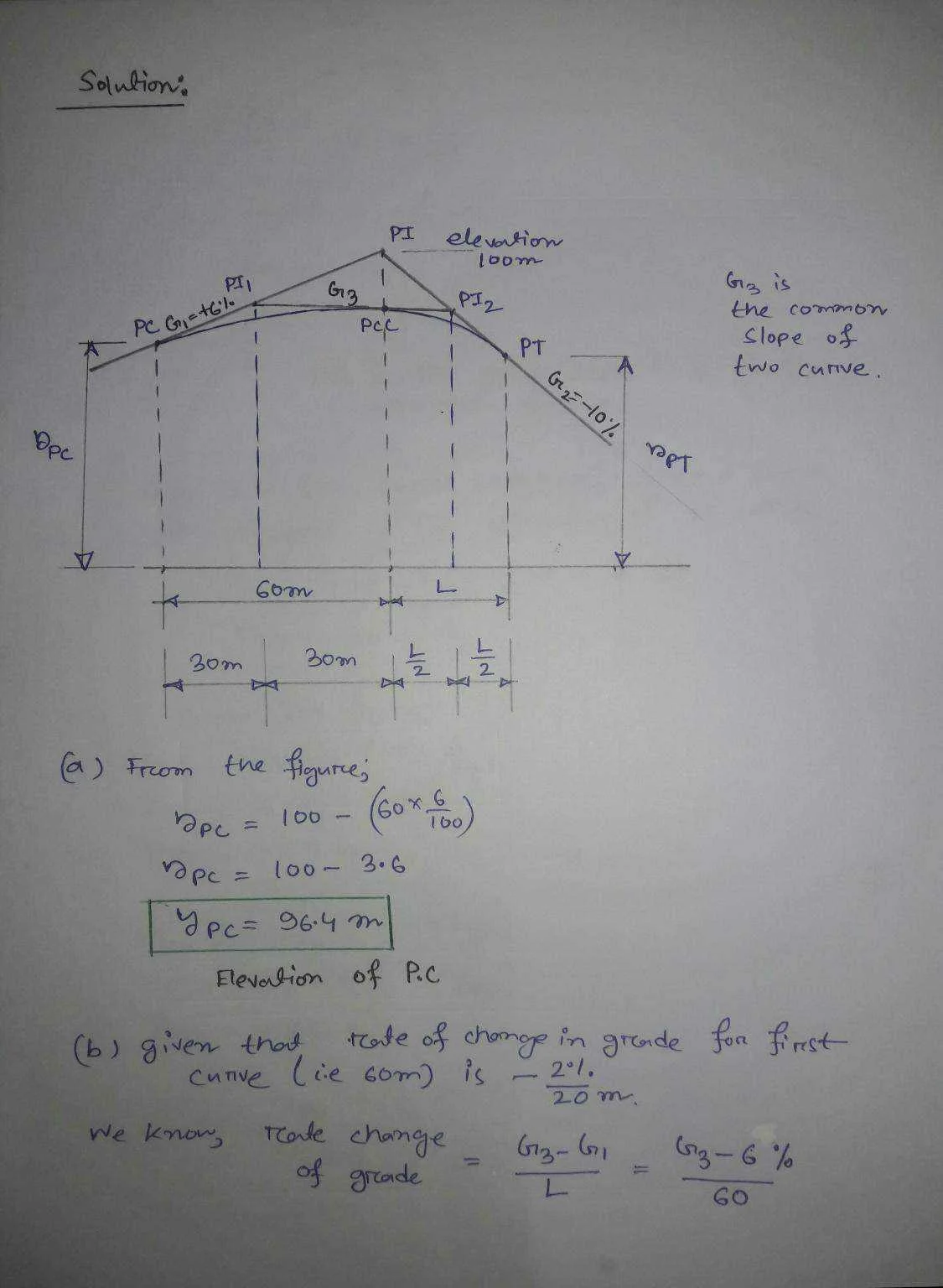

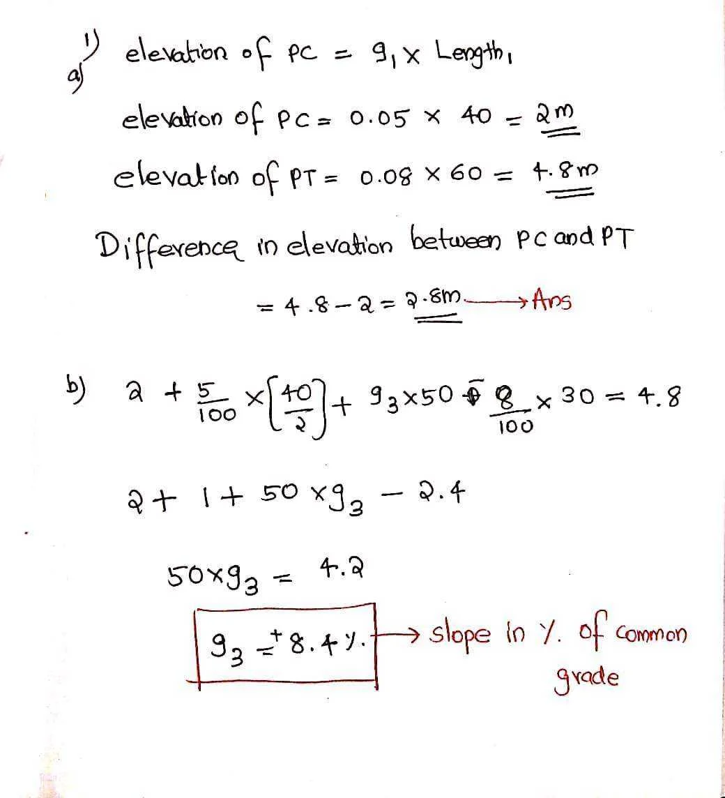

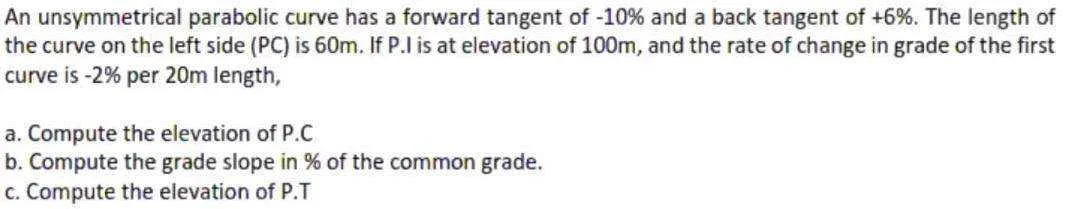

I.
Question: An unsymmetrical parabolic curve has a forward tangent of -10% and a back tangent of +6%. The len...​
Expert Answer​
    Thumbs up inactive
    0
    0
    2,466 answers
    1607089531670_Document6_3_7.webp1607089545950_Document6_4_5.webp1607089561802_Document6_5_4.webp
    Comment

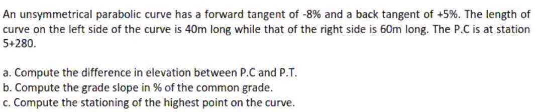

II.
Question: An unsymmetrical parabolic curve has a forward tangent of -8% and a back tangent of +5%. The leng...​
