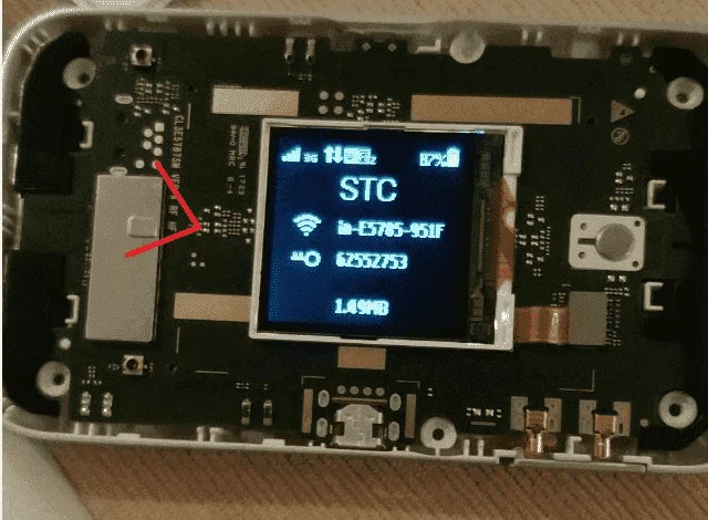

7. Now dismantle the device as shown in above image.
8. With a twizzer or metal, touch and hold both points (Refer above image).
9. Now connect to PC.
