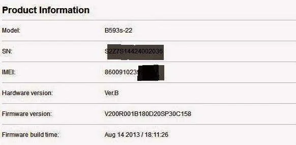

Tutorial: Phase 1
  1. Go to your web gui, on browser 192.168.254.254 and login using user user/ pass @l03e1t3
  2. Copy your device imei (ex. 86009102399XXXX) - on product information tab.
    1. Generate the unlock code by going toYou do not have permission to view the full content of this post. Log in or register now.
    2. Use your Google account and hit +1 be sure to encode every details.
    3. Put your IMEI and copy the red generated NEW ALGO(usually 8 digits)
    4. Insert any SIM except Globe (SMART recommended)
    5. Log-in again to 192.168.254.254 just ignore the message invalid SIM
    6. Use the user account again user/@l03e1t3

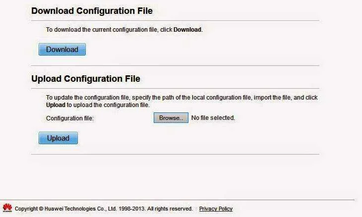

    Tutorial: Phase 2
    1. Download the config file You do not have permission to view the full content of this post. Log in or register now.
    2. Upload the config file by going to system - scroll down till you see "Upload Configuration File", click browse choose file then upload.
    3. The LTE modem will reboot
    Tutorial: Phase 3
    1. This time go to 192.168.1.1 on your browser
    2. Log-in as admin user admin/ pass password123
    3. Navigate to INTERNET tab and paste the NEW ALGO code.
    4. Your Huawei B593s-22 is now openline.
