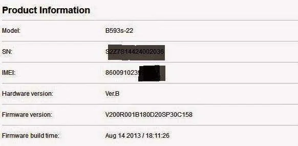

  2. Copy your device imei (ex. 86009102399XXXX) - on product information tab.

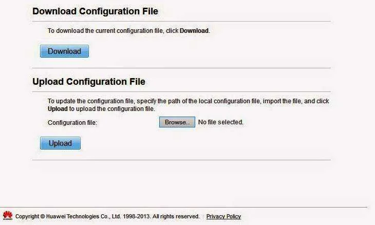

    1. Download the config file You do not have permission to view the full content of this post. Log in or register now.
    2. Upload the config file by going to system - scroll down till you see "Upload Configuration File", click browse choose file then upload.
    3. The LTE modem will reboot
