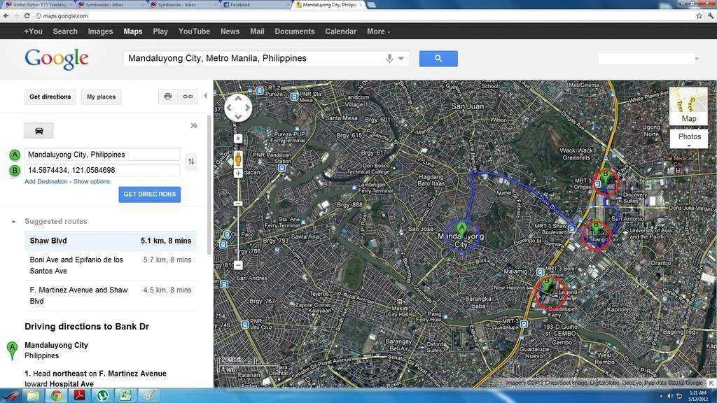

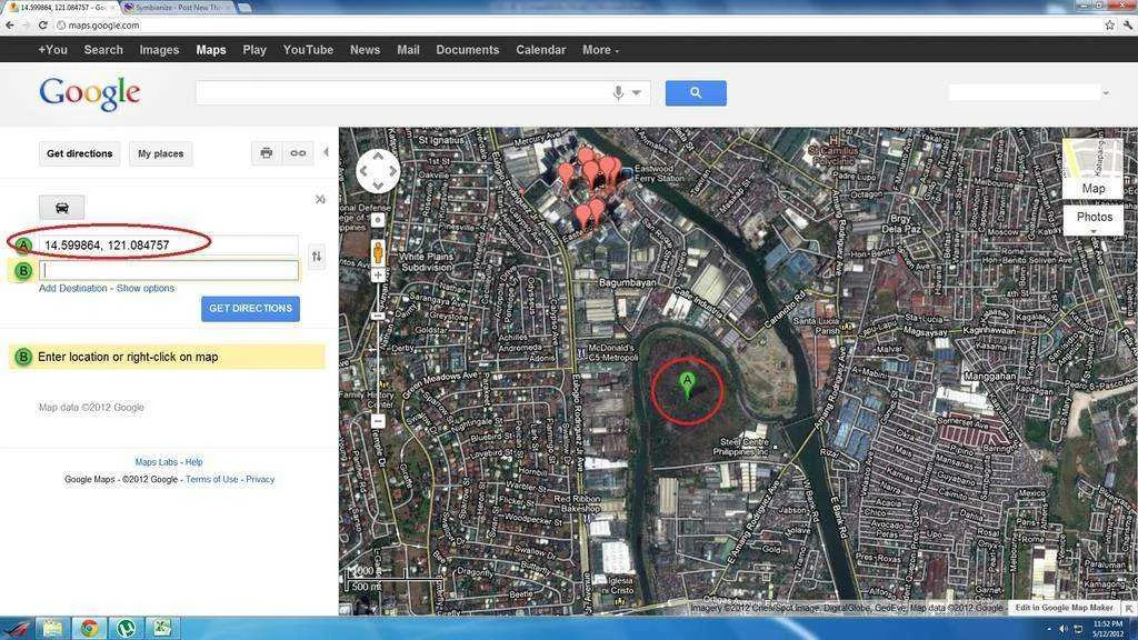

EXAMPLE of plotted BTS in your area (from your destination to available BTS)
blue - your location (mandaluyong)
red - available bts

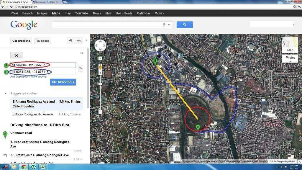

first:

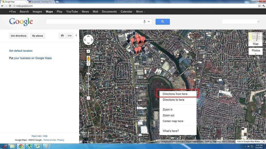

track down your location using google maps
- right click on google map where your located at,
- choose "direction from here"

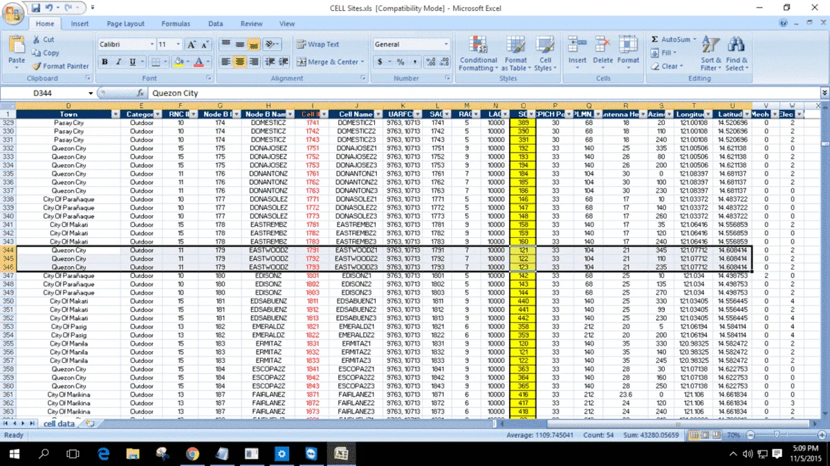

open the cell id list
- control f to find your location for example "eastwood" "quezon city"
- copy longtitude and latitude
back to google map
- copy and paste longtitude and latitude of bts location on B or destination latitude first then comma space
and longtitude
- then click GET DIRECTIONS
* search mo lang tung cell id sa google map if kung ano pa malapit sa lugar niyo at para malaman mo gaano kalapit sa area mo
* dahil dito matatapat mo na yung antenna mo sa pinakamalapit na bts

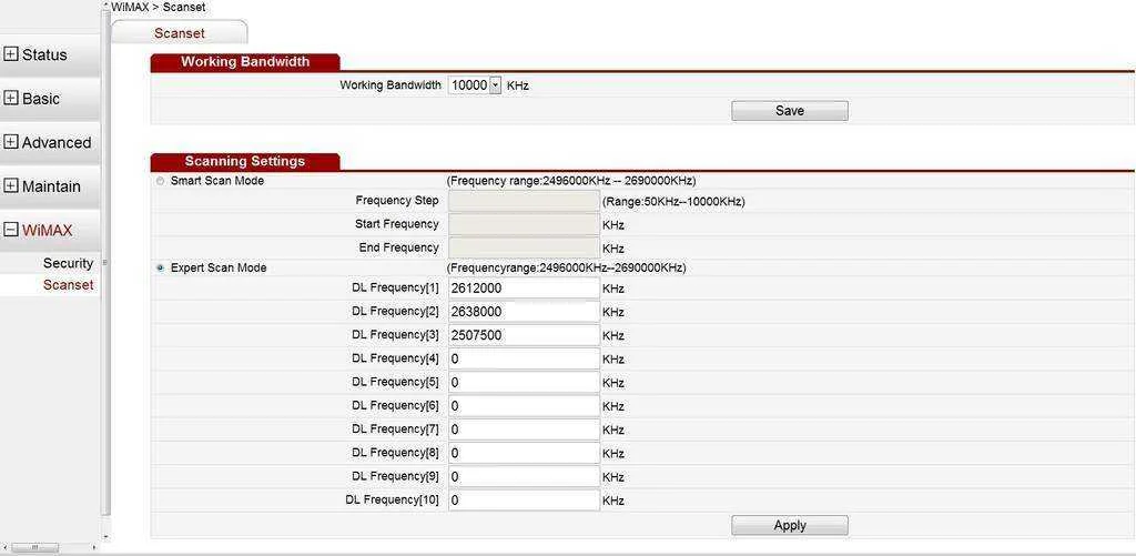

* papano mag force connect on your desired bts.
- access your modem gui as admin then on the bottom left side ng gui
click WIMAX
choose SCANSET
- remove other DL frequency under expert scan mode
- maglagay ka ng isa, dalawa, or tatlo na frequency para sa gusto mong bts
remember: back up default seven scanset para alam mo if ano ilalagay mo
connect frequency ~ bsid it depends in your area
2507500 KHz BSID 01:00:1
2602000 KHz BSID 00:01:2
2612000 KHz BSID 01:0e:3
2638000 KHz BSID 01:01:4
2622000 KHz BSID 0f:1a:5
2505000 KHz BSID b1:12:6
2510000 KHz BSID 1d:1a:7
for example nakatapat na antenna ko sa pinakamalapit na bts,
ang connect frequency na ginagamit niya is 2602000,
dahil yun yung connect frequency niya ang nakukuha niyang BSID is 00:01:2
pwede ko siyang maforce connect lagi sa bsid na yun using connect frequency.
in my case... tatlo lang iniwan ko pero isa lang yung lagi nagkokoconnect, dati apat yan palitan sila pero bumagal kapag tanghali na DL rate niya is 40kbps average of 60kbps unlike yung scanset frequency ko ngayon kahit tanghaling tapat DL lang ok naman speed up to 140kbps minimum of 70kbps and average of 110kbps, hindi na masama...
magdepende kayo sa lugar niyo if ano ang ginagamit ng bts connect frequency nyo, before kayo magbawas.

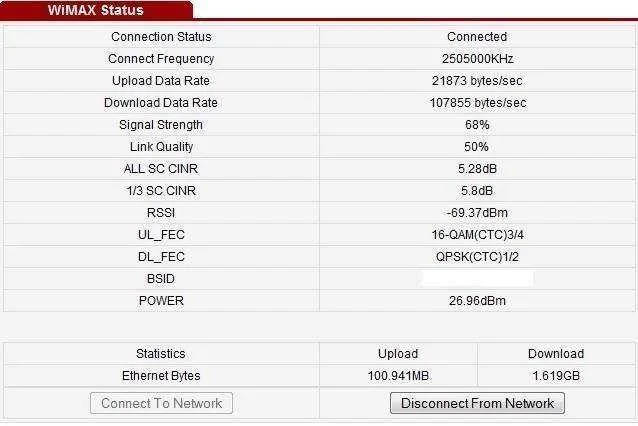

procedure to remember
Install the antenna on area with clear view of the donor cell (WIMAX BTS) as much as possible. (more blocked by high establishment, less signal strength)
Point the antenna directly on the donor cell (WIMAX BTS) (for easy detection and connection to sync from modem to bts)
Adjust the up and down tilt of the antenna if necessary (kasi hindi naman sobrang patag ng kinakatauyaan eh, saka iba iba height ng bts, please refer to cell id reference)
Use the modem LED indicator and modem GUI WIMAX status to find the best
signal and link quality while adjusting the position of the antenna. You can adjust
the up and down tilt of the antenna. The following are the preferred WIMAX
status:
RSSI: -57.5 dBm to -47.5 dBm (LED Status Indicator: Four LEDs on)
DL_FEC: 16-QAM(CTC)1/2 ~ 64-QAM(CTC)3/4
UP_FEC: QPSK (CTC)1/2
ngayon alam mo na, pwede ka na umakyat sa taas ng bubong niyo at itutok ung antenna :D

wimax status

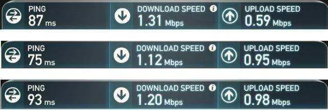

3x times speed test
* 3x suggested speedtest to conduct
then speedtest 1 + speedtest 2 + speedtest 3 = Total * 20%
answer nun is normal download rate mo, or pass pa rin based sa guidelines ni hari ng mundo
ping test -n 50 (ping You do not have permission to view the full content of this post. Log in or register now. -n 50)
* lower than 300ms is pass s download rate "any bandwidth"

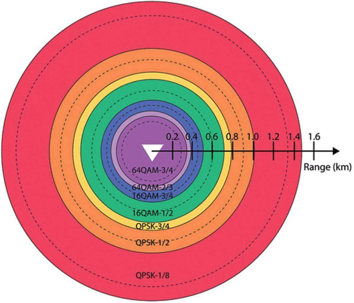

DL_FC are measured how far BTS from your location.
This certain value is referring to DL rate or speedtest not IDM rate and if you've able to acquired quality signal this would be the value you will get.
QPSK 1/2 - 1kbps to 2mbps
QPSK 3/4 - 2 to 3mbps (most often sa non peak hours specially sa madaling araw, if peak hours 500kbps to 2mbps)
16-QAM(CTC)1/2 - based on my experience (1mbps) mas pipiliin ko pa makakuha ng QPSK 3/4 (siguro mas benefit dito yung "VIP" MAC)
16-QAM(CTC)3/4 - 4-6mbps ("VIP" MAC will get this dl rate)
64-QAM(CTC)1/2, 2/3 or 3/4 - 6-12mbps ("VIP" MAC will get this dl rate)
