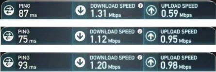

3x times speed test
* 3x suggested speedtest to conduct
then speedtest 1 + speedtest 2 + speedtest 3 = Total * 20%
answer nun is normal download rate mo, or pass pa rin based sa guidelines ni hari ng mundo
