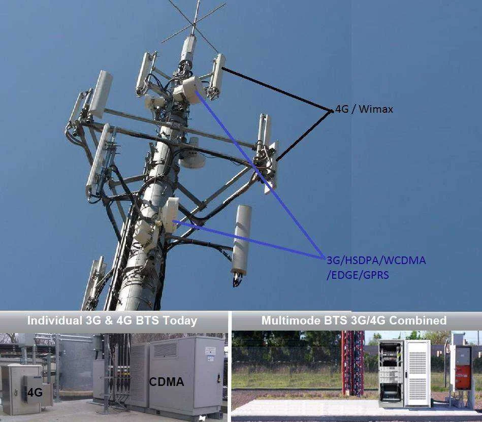

Globe Wimax BTS Tracking
How to track BTS/BSID or Base Station ID or Globe Tower:
This tutorial is how to tune your antenna on the right path according on the available BTS in your area, for signal strength effectiveness.
ADDITIONAL INFO: 4G data networks using Long Term Evolution (LTE) or WiMAX (Worldwide Interoperability for Microwave Access) is a wireless communications standard designed to provide 30 to 40 megabit-per-second data rates, providing up to 1 Gbit/s for fixed stations. It is a part of a “fourth generation,” or 4G, of wireless-communication technology. WiMax far surpasses the 30-metre (100-foot) wireless range of a conventional Wi-Fi local area network, offering a metropolitan area network with a signal radius of about 50 km (30 miles) 3G networks that descended from GSM. 3GPP technologies evolved as follows. • General Packet Radio Service (GPRS) offered speeds up to 114 Kbps. • Enhanced Data Rates for Global Evolution (EDGE) reached up to 384 Kbps. • UMTS Wideband CDMA (WCDMA) offered downlink speeds up to 1.92 Mbps. • High Speed Downlink Packet Access (HSDPA) boosted the downlink to 14Mbps.

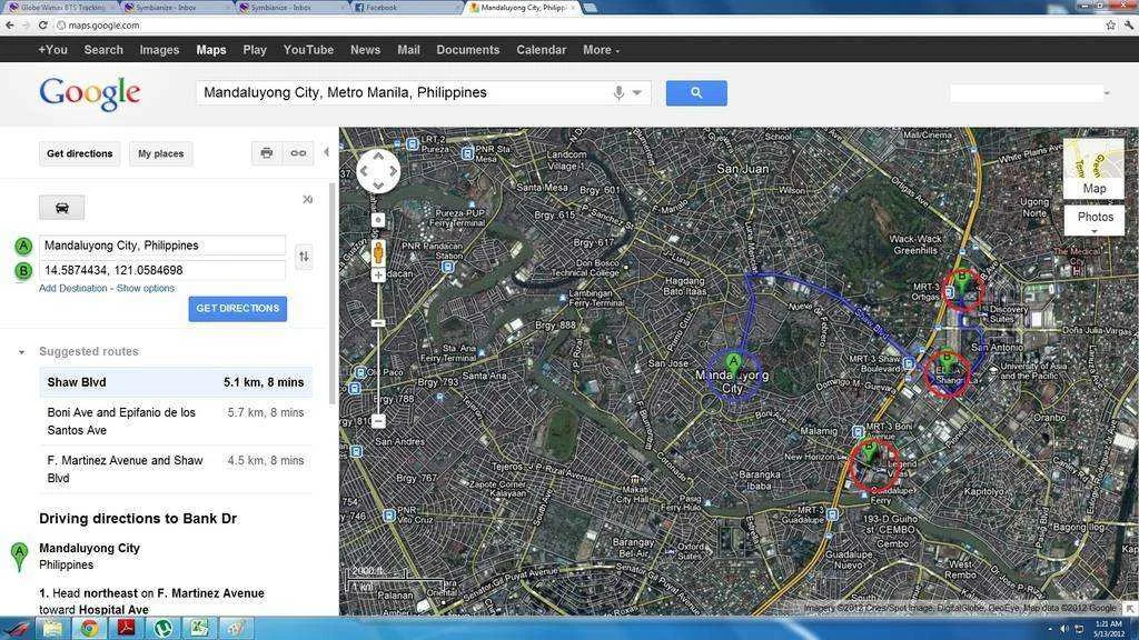

EXAMPLE of plotted BTS in your area (from your destination to available BTS)
blue - your location (mandaluyong)
red - available bts
first:

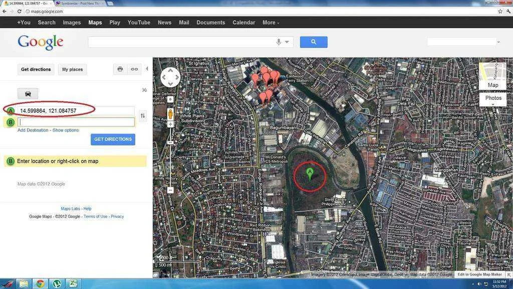

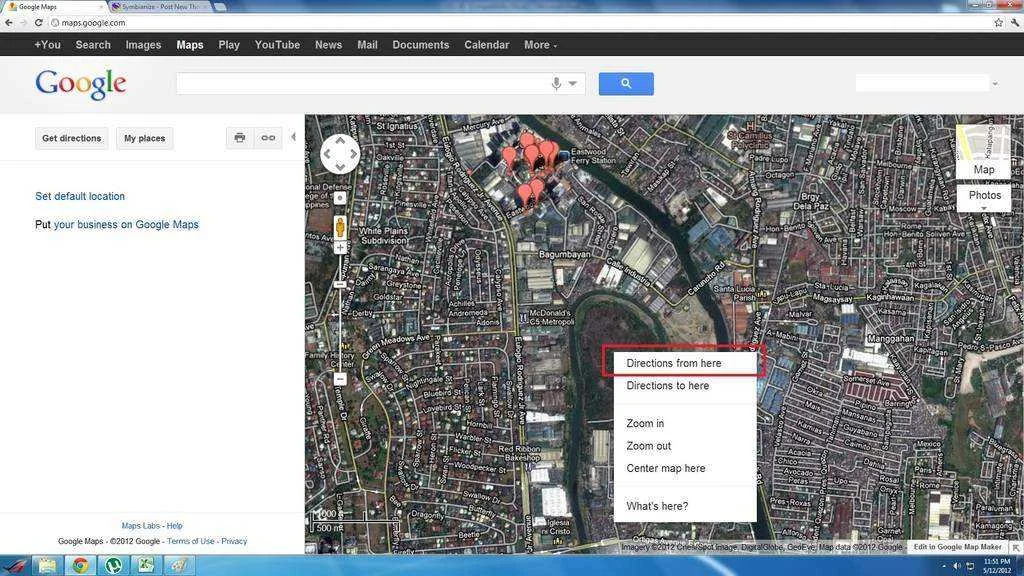

track down your location using google maps
- right click on google map where your located at,
- choose "direction from here"
open the cell id list
- control f to find your location for example "eastwood" "quezon city"
- copy longtitude and latitude

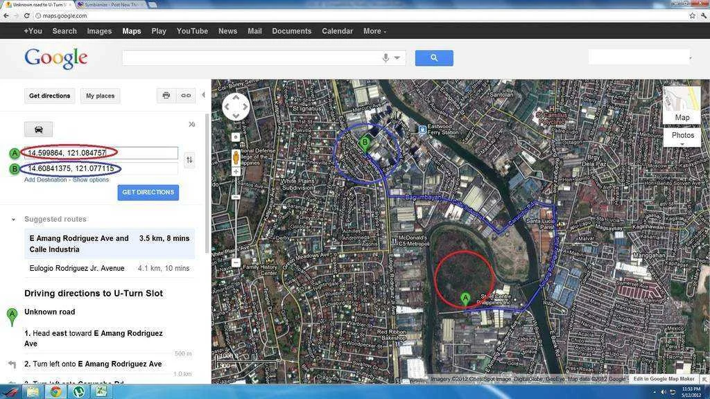

back to google map
- copy and paste longtitude and latitude of bts location on B or destination latitude first then comma space
and longtitude
- then click GET DIRECTIONS
* search mo lang tung cell id sa google map if kung ano pa malapit sa lugar niyo at para malaman mo gaano kalapit sa area mo
* dahil dito matatapat mo na yung antenna mo sa pinakamalapit na bts
* after mo maitapat sa bts na yun, check mo modem gui mo for details much better if take note mo ung BSID at signal strength nya at ung connect frequency, para pwede mo maforce connect yung modem sa bts na yun if sa tingin mo na stable at mabilis ka dun, remember hindi lahat ng araw stable dun sa bts na yun kasi minsan mabagal ka dun sa kadahilanan na congested na or marami nang nakaconnect or minsan walang connection dahil maintenance yung bts n yun kaya hahanap ka ng ibang bts, no choice eh, kaya magtyatyga ka sa ibang bts or hayaan mo na lang mscan automatically yung modem.

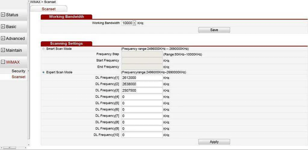

* papano mag force connect on your desired bts.
- access your modem gui as admin then on the bottom left side ng gui
click WIMAX
choose SCANSET
- remove other DL frequency under expert scan mode
- maglagay ka ng isa, dalawa, or tatlo na frequency para sa gusto mong bts
remember: back up default seven scanset para alam mo if ano ilalagay mo
connect frequency ~ bsid it depends in your area
2507500 KHz BSID 01:00:1
2602000 KHz BSID 00:01:2
2612000 KHz BSID 01:0e:3
2638000 KHz BSID 01:01:4
2622000 KHz BSID 0f:1a:5
2505000 KHz BSID b1:12:6
2510000 KHz BSID 1d:1a:7
for example nakatapat na antenna ko sa pinakamalapit na bts,
ang connect frequency na ginagamit niya is 2602000,
dahil yun yung connect frequency niya ang nakukuha niyang BSID is 00:01:2
pwede ko siyang maforce connect lagi sa bsid na yun using connect frequency.
in my case... tatlo lang iniwan ko pero isa lang yung lagi nagkokoconnect, dati apat yan palitan sila pero bumagal kapag tanghali na DL rate niya is 40kbps average of 60kbps unlike yung scanset frequency ko ngayon kahit tanghaling tapat DL lang ok naman speed up to 140kbps minimum of 70kbps and average of 110kbps, hindi na masama...
magdepende kayo sa lugar niyo if ano ang ginagamit ng bts connect frequency nyo, before kayo magbawas.

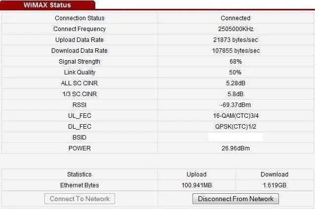

Use the modem LED indicator and modem GUI WIMAX status to find the best
signal and link quality while adjusting the position of the antenna. You can adjust
the up and down tilt of the antenna. The following are the preferred WIMAX
status:
RSSI: -57.5 dBm to -47.5 dBm (LED Status Indicator: Four LEDs on)
DL_FEC: 16-QAM(CTC)1/2 ~ 64-QAM(CTC)3/4
UP_FEC: QPSK (CTC)1/2

wimax status

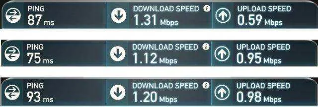

3x times speed test
* 3x suggested speedtest to conduct
then speedtest 1 + speedtest 2 + speedtest 3 = Total * 20%
answer nun is normal download rate mo, or pass pa rin based sa guidelines ni hari ng mundo
ping test -n 50 (ping You do not have permission to view the full content of this post. Log in or register now. -n 50)
* lower than 300ms is pass s download rate "any bandwidth"

ngayon balik tayo kay wimax status
sabi ni technician dapat 100% signal po para mabilis!!
eh walang joke tested ko na yung ganung pamamaraan, lalong bumagal internet ko.
why kasi based on my experience kailangan din tingnan si CINR, if mataas yun ibig sabihin madae interference at magiging prone sa intermittent conncection
"Connect Frequency"
sabi ni technician kapag mataas un like 26000 something
mabilis internet mo
eh walang joke frequency yun eh para skin siya ung channel mo para makahanap ng BSID
"RSSI"
* on my experience higher the RSSI the lower ping latency you will get
RSSI: range of -60dBm or below but not more than -70dBm it may give you a higher ping or late response from the BTS
preferred dl_ul rate
but sometimes even you have this value you'll not able to get a higher dl rate due to BTS and Signal status
QPSK 3/4 is much better rather than QPSK 1/2
UP_FEC: QPSK (CTC)3/4 is better but it doesn't matter since ang taas talaga nito, depende na lang sa frequency na papasukan if mkakapag bigay nang magandang ul rate
DL_FC are measured how far BTS from your location.
This certain value is referring to DL rate or speedtest not IDM rate and if you've able to acquired quality signal this would be the value you will get.
QPSK 1/2 - 1kbps to 2mbps
QPSK 3/4 - 2 to 3mbps (most often sa non peak hours specially sa madaling araw, if peak hours 500kbps to 2mbps)
16-QAM(CTC)1/2 - based on my experience (1mbps) mas pipiliin ko pa makakuha ng QPSK 3/4 (siguro mas benefit dito yung "VIP" MAC)
16-QAM(CTC)3/4 - 4-6mbps ("VIP" MAC will get this dl rate)
64-QAM(CTC)1/2, 2/3 or 3/4 - 6-12mbps ("VIP" MAC will get this dl rate)
NOTE:
if your mac is "VIP" there's a possible that you will get a quality dl rate but still it depend on the status of your signal.
"POWER" dBm
Eto po mga boss kapag mahina ang signal mo ay tataas ang power kase mas tinataasan niya yon para makakuha nang magandang signal based on my experience sa wimax eh mga 26 dbm ang preffered with -63rssi at 25-26 all cinr mas maganda signal mo mas mahina uminit ang modem mas mataas mas madali uminit at malakas kumonsumo nang power
