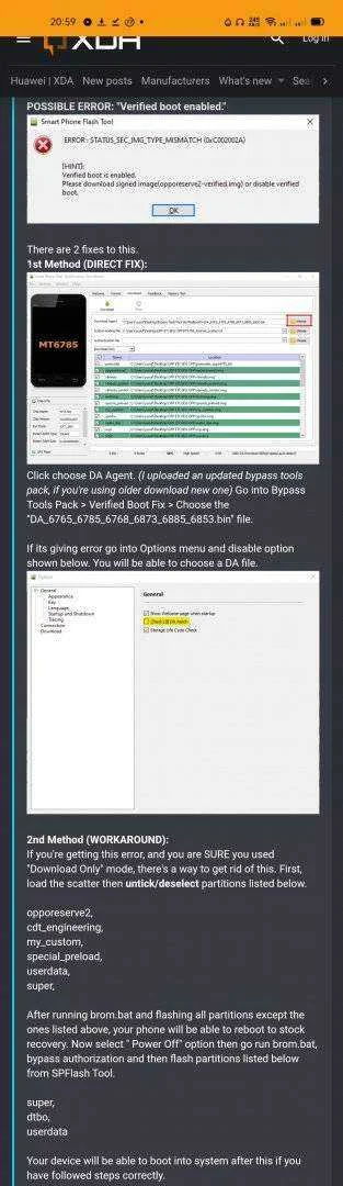

na follow ko lahat ng process tapos success na... pero di parin nag boot yung phone ko.. Inulit ko procedure tapos need to disable vbmeta daw
Ginagamit lang po ang ofp extractor to convert stockrom/firmware from ofp to scatter files, since naka scatter file ung gagamitin mo, need mo lang yan i-flash, mahirap kasi gamitin ang ofp download tool lalo na kung wala kang account id(except sa crack) mostly ofp ang kalimitang gamit ng oppo mtk device
alam koto. may manual way via cmd at ilang files lng. ang naging problema ko is invalid preloader. baka may alam kang way iback-up ang tecno spark 6 go. mt6761 cheap. salamat boss
