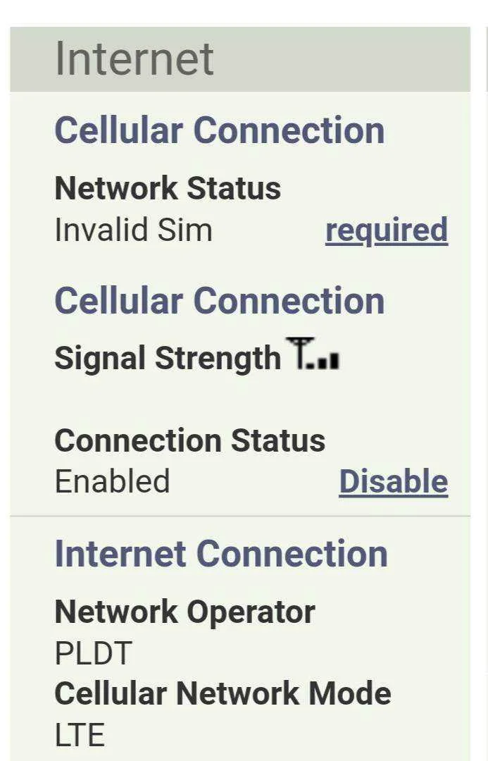

❓ Help PLDT Home R281 nag update ng Software Version (v004.1). Openline di na gumagana.

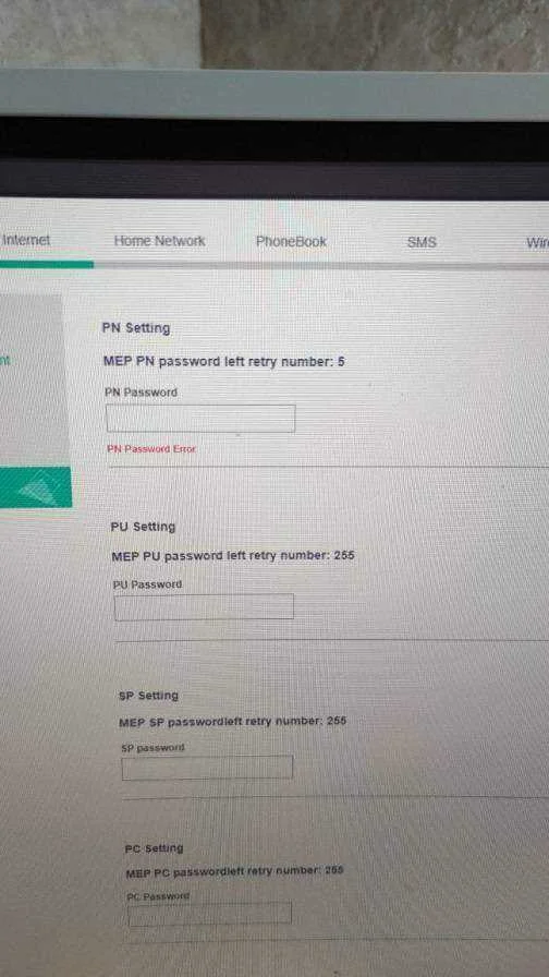

Nag update ang PLDT Home R281 and hindi na gumagana yung openline na AT+CLCK="PN",0,123456,16
Error na ang nakalagay.
Also, openline na sana ako kaso after the update RED na ang signal. Kaya nag system restore ako planning na i-openline ulit kaso error na yung AT+CLCK="PN",0,123456,16
Any solution?
Mukhang working lang sa R01 at R05, magkaiba pala password yung pldt version na R05 dunsa R01 ng Globe, pero mga Boosteven model din kac, Pero nagawang ma unlock ni Master Zander yung R05, using yung firmware ng R01, kaya lang 3G lang sa Globe Sim, mukhang need modify firmware ng R01 magdagdag bands and frequencies. Salamat
Keep it secret muna Nila Maam Ka phc , Lagi ba namang nakakatay, 1 week lang. Nood ka nalang guide ni Master Zander sa Youtube using Winscp at telnet via ssh tunneling, masusundan din naman steps by steps. Pero medyo magsasayang talaga oras at araw. Kaya ako kahit inde na unlock, basta may band lock masaya na using postpaid B535 at R281. D na need black Mamba expensive 👍👍
Sa ngayon Maam, mas maganda gumamit 2 Types of LTE Advanced wifi routers. Mauubos lang din Oras sa pag unlock ng R281, kac meron naman manual select ng Band para lumakas internet Para Pldt Sim, Sa globe Postpaid version na B535 naman, Meron yung Huactrl at Huawei Manager, pan select ng anumang band at pwede rin combined lahat ng Band, Nabibili second hand B535 postpaid version 1k sa shopee Lazada, may kasama pang admin pass, yung yung R281 naman 1.5k, kaya mas maganda may 2 wifi Lte A nalang hehhehe 👍👍
