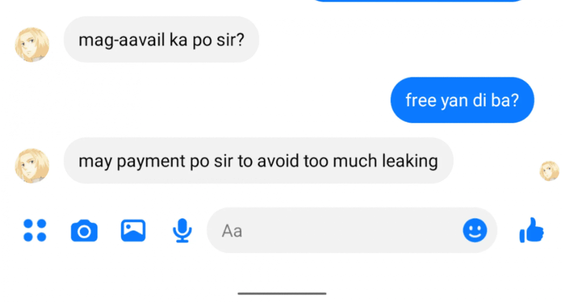

Someone made it Automatic with Nginx and ssh code. Just click and install on Y⊕ùTùbé in case there is a fee better than free, find Master Eugenekey's Tuts, Ghostfighter. It's free, why pay?🙏👏👍👍
Eugenekey did a fantastic job with his Nginx trick. Thanks to him, we can lock bands now. But what about making R281 openline with v004.2 ? Still no solution ?

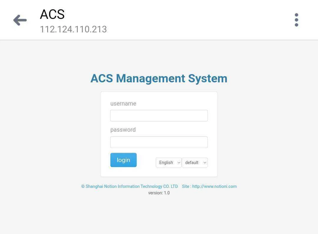

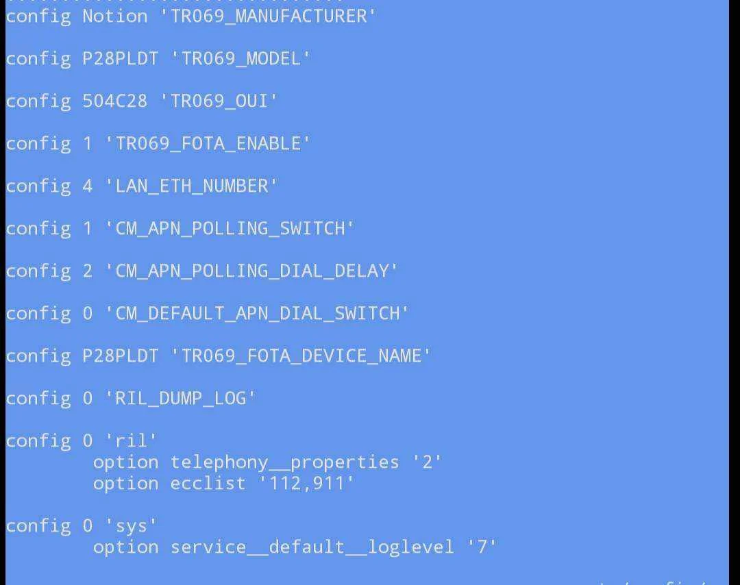

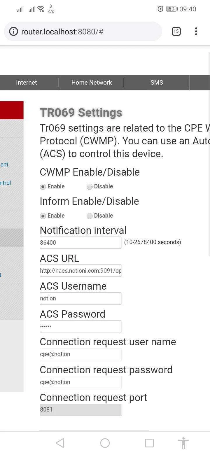

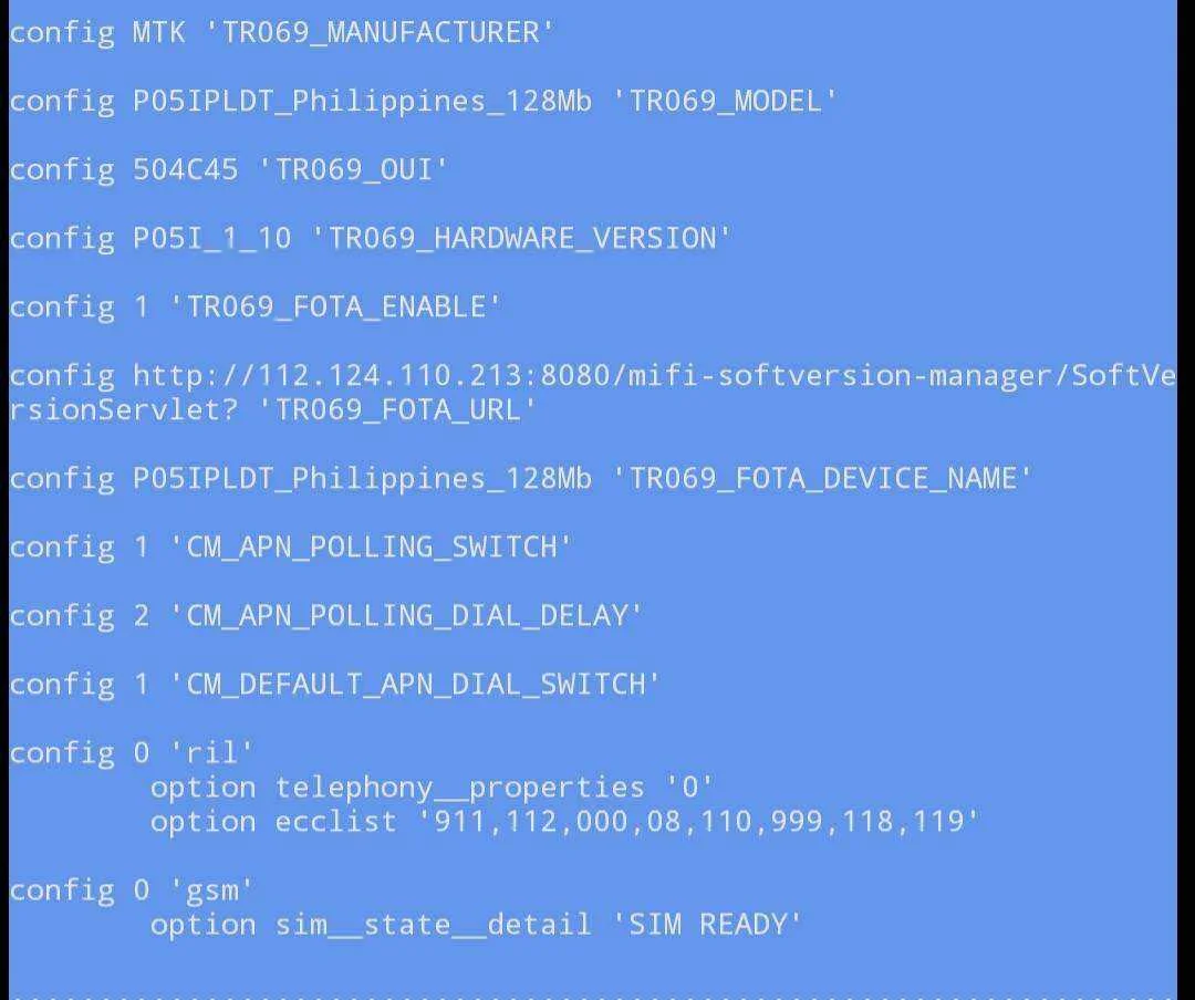

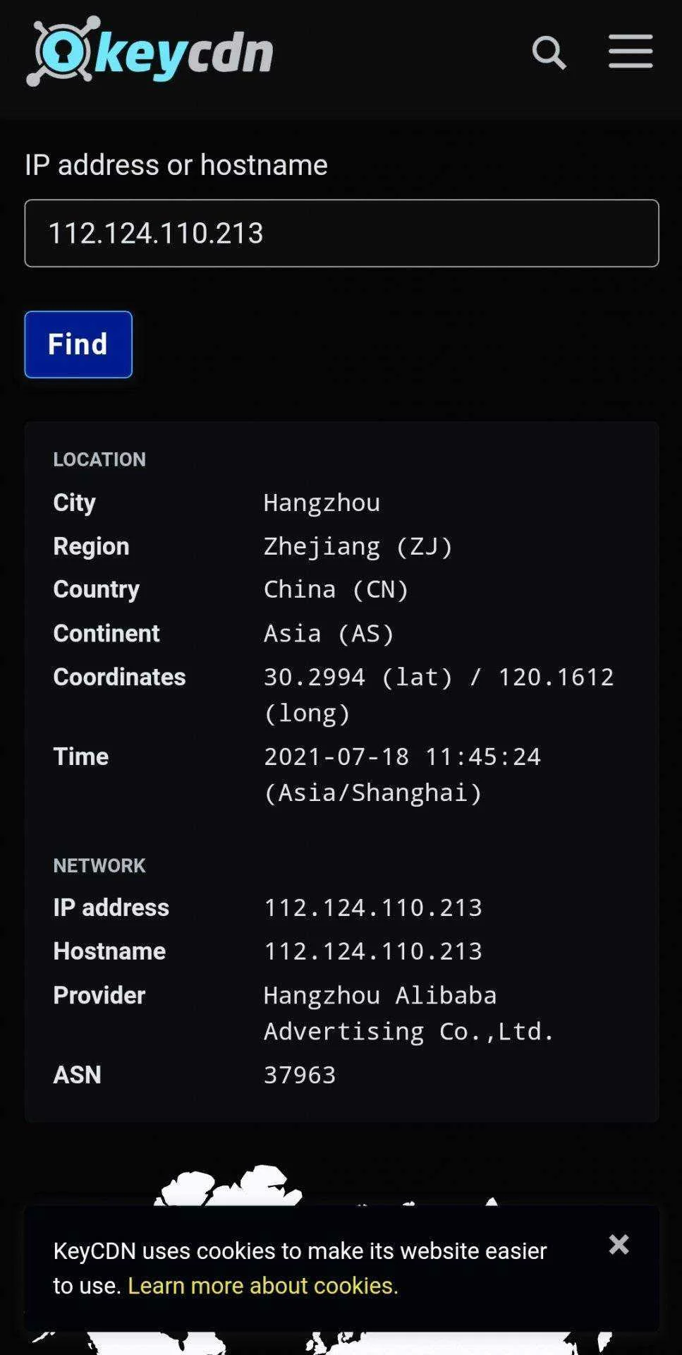

Guyz may nag post sa FB naka Baseband 2.1 He used nginx tricks to disable TRO69 but His Modem still updated to Baseband 2.2
Question is
How?
Does R281 modem have 2 TR069?
PLDT R051
PLDT R281
Medyo bad news yan ah, Lods plan ko pa naman bumili isang R281 uung may old firmware v2.0. Ang Bilis ginawan Paraan, Lods. Ah, pero k na band lock sa akin, kahit d na ma unlock weak naman Globe dto kahit malapit Torre, mga 180Meters pinaka malapit, 3.5kms isa tapos 2.5kms isa, need talaga Hybrid mimo Antenna, hehe. Sana ma disable pa natitirang code ng TR 069. Pinipersonal nila tanggalin lahat butas sa system nila. smart Talino👍👍
