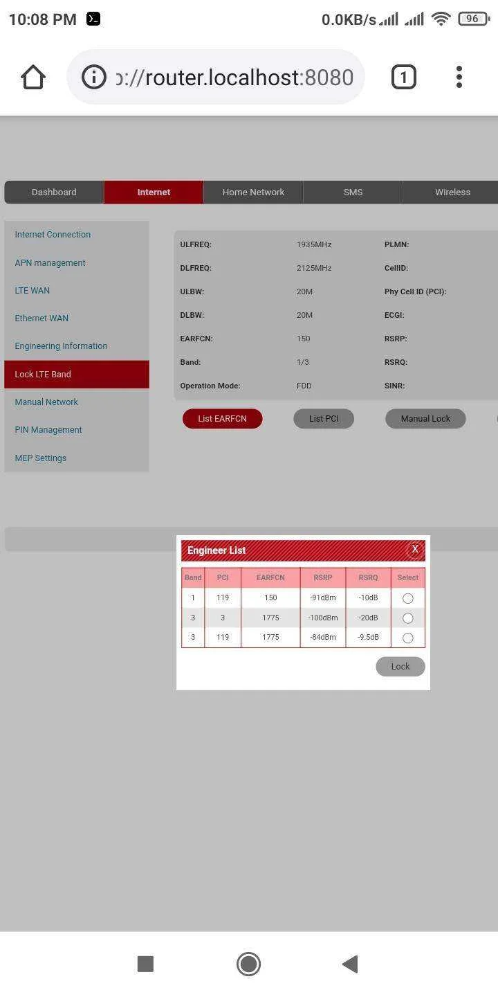

Also, openline na sana ako kaso after the update RED na ang signal. Kaya nag system restore ako planning na i-openline ulit kaso error na yung AT+CLCK="PN",0,123456,16
Any solution?
yung option sa internet tab LOCK LTE BAND. yung 1st band lang sya na lock ung 2nd band nya automatic na. kumabaga magiging priority band ung sinet mo sa list. based sa observation ko

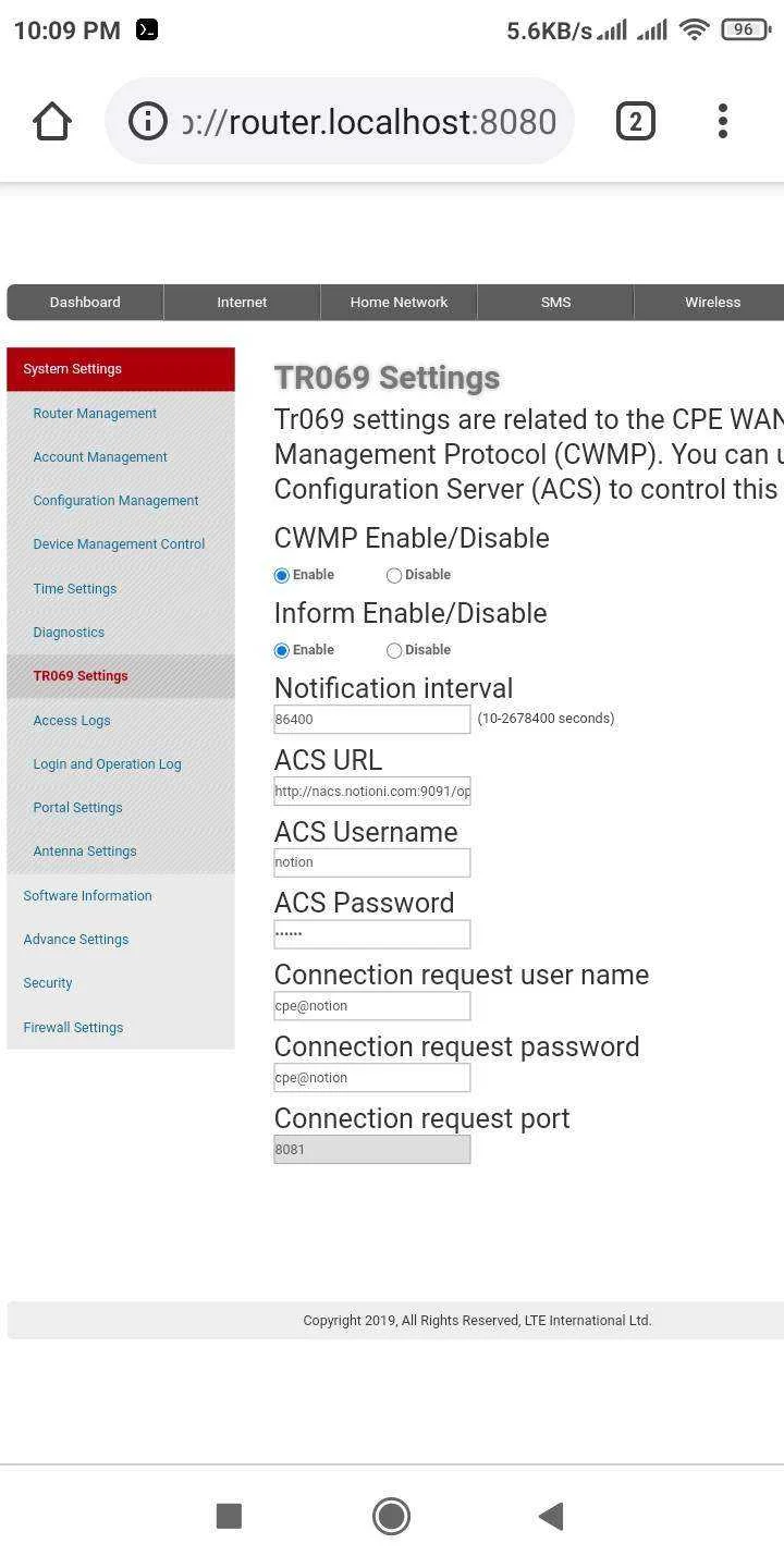

[XX='Elbytex9419, c: 1354921, m: 1814418'][/XX] im not eugenekey but feeling ko po, highly probable na yes, parang monitoring po kasi yung tr069 so if walang data na nassend kay smart or namomonitor niya then it is as good as a rouge / independent modem
