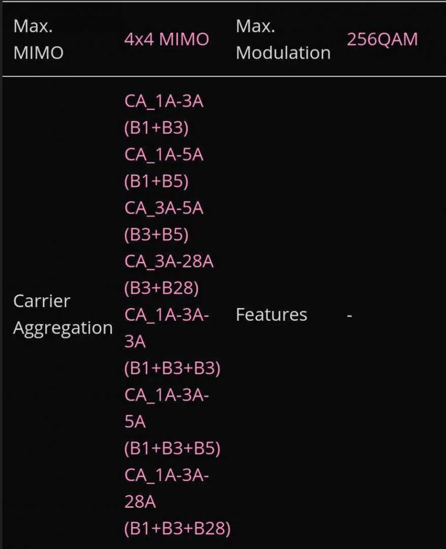

CA IA-3A (Bl+B3) CA IA-5A (Bl+B5) CA 3A-5A (B3+B5) CA 3A-28A (B3+B28) CA I A-3A- Featu res 3A (Bl+B3+B3) CA I A-3A- 5A (Bl+B3+B5) CA I A-3A- 28A (Bl+B3+B28) Carrier Aggregation List.

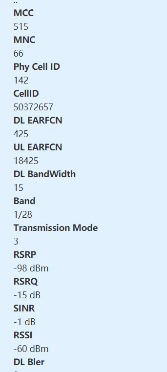

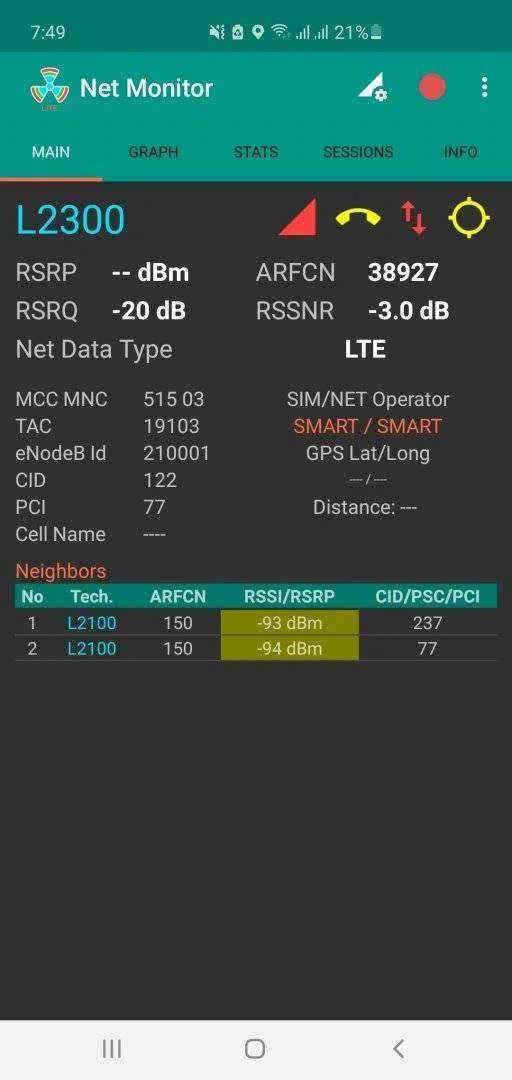

SMART LTE BAND FREQ. LIST B1 U/D:1935MHz/2125MHz (FDD) EARFCN: 150 B3 U/D:1725MHz/1820MHz (FDD) EARFCN: 1350 B3 U/D:1765MHz/1860MHz (FDD) EARFCN: 1750 B3 U/D:1767.5MHz/1862.5MHz (FDD) EARFCN: 1775 B5 U/D:830MHz/875MHz (FDD) EARFCN: 2460
B5 U/D:832.5MHz/877.5MHz (FDD) EARFCN: 2485 B28 U/D:730.5MHz/785.5MHz (FDD) EARFCN: 9485 B40 U/D:2307.5MHz/2307.5MHz (TDD) EARFCN: 38725 B40 U/D:2327.7MHz/2327.7MHz (TDD) EARFCN: 38927 B40 U/D:2347.5MHz/2347.5MHz (TDD) EARFCN: 39125 B40 U/D:2367.3MHz/2367.3MHz (TDD) EARFCN: 39323 B41 U/D:2587.2MHz/2587.2MHz (TDD) EARFCN: 40562 B41 U/D:2607MHz/2607MHz (TDD) EARFCN: 40760 B41 U/D:2640MHz/2640MHz (TDD) EARFCN: 41090
Freq. Lock Example ARFCN 150 is band 1. Band 1 carrier aggregation is Band 3 and Band 5
ubus call cm set_cell_lock '{"mode":"1","act":"3","band":"1","freq":"150","cellid":"77"}'

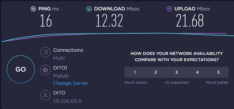

mimo v4 lang yon dami 2nd hand sa fb. bigay lang to sakin ng pinsan ko eh galing sa setup nya ng s10g kaso nasira yung modem kaya binigay sakin yung antenna pati bakal. 1k lang srp siguro nyan
Dito sim in peak hours with r281. May kagabalan kasi mimo v4 lang antenna lang. Mas stable to if yung antenna sakop band 28 frequency kasi malakas na talaga band 1 ng dito samin

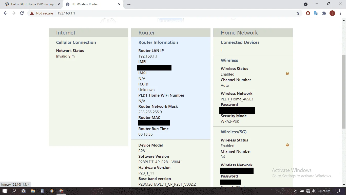

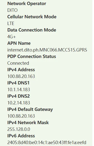

Looks like PLDT released another update just a few minutes ago. My DITO sim was working fine then suddenly lost internet and checking the dashboard, invalid sim na sha with any sim i put in even smart and the original sim it came with. I can't access 192.168.8.1 even if I can ping it. Telnet to port 80 or 22 is blocked. Any thoughts EugeneKey ?
