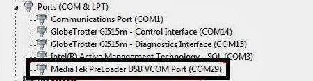

  • You do not have permission to view the full content of this post. Log in or register now. ↦ Install this driver first on your computer, Turn off your device and remove the battery, using USB cable connect your device while look at My Computer ↦ Manage ↦ Device Manager there will be MTK65xx Preloader Devices show up for 5 second than disappeared, before disappeared right click on it and select Update Driver Software point it to You do not have permission to view the full content of this post. Log in or register now. extracted folder. When it finish disconnect and connect again there will be Mediatek PreLoader USB VCOM Port on your device manager.

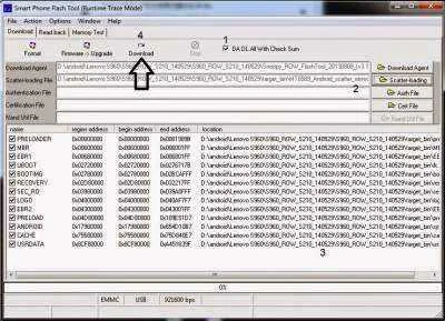

  3. Go to flash_tool folder and run flash_tool.exe if you are running windows 7 or above please run this program using administrator privilege to avoid any permission error while flashing.
  4. On the flash tool please check DA DL All with Checksum option, this is the first option that need to be change and don't forget to check this option. Click on Scatter-Loading button and point it to target_bin and select MT6589_Android_scatter_emmc.txt this action will automatically load all images files to flash tool.
  5. When everything set up, now you can click Download button or hit F9. Flash tool will initialize the ROM file and after a few minutes it become stand by and ready to make connection with your device. (When you got flash tool error 8038 when connect your device, then please try click firmware↦upgrade button)

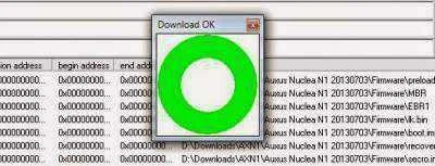

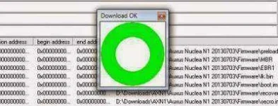

  7. Flash tool will recognize your device and begin to start flashing process, the process will take 5-6 minutes, it will show progress bar on the bottom of flash tool. When finish it will show GREEN CIRCLE on the middle of flash tool.
