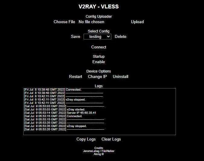

well that's the router that i use for installing v2ray
for starters ginamit ko ito firmware kay jeromelaliagg
Tools - E5573Cs-933 21.335.01.01.00

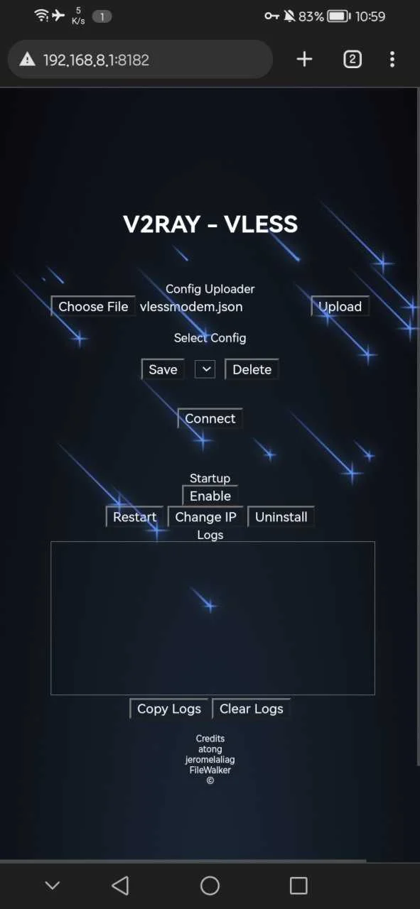

since most people use a phone (i mainly use a pc) install this app
AND REMEMBER THE IP AND THE PORT AND ALSO WHERE YOU PUT THE SETUP FILE
download the setup file
open ssh/telnet of ur router and put the commands ONE BY ONE
mount -o remount,rw /system /system
wget -g -v -l /mnt/obb/atong.tgz -r <the file location> -P <port> <ip address>
tar -xzvf /mnt/obb/atong.tgz -C /online
chmod 777 /online/atong/v2ray/bin/
chmod 777 /online/atong/v2ray/bin/fixstartup.sh
chmod 777 /online/atong/v2ray/bin/run.sh
chmod 777 /online/atong/v2ray/bin/installv2ray.sh
./installv2ray.sh
reboot
./fixstartup.sh

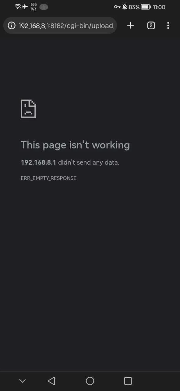

paps yng 2nd part ang hirap applet not found
