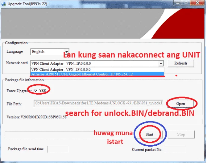

UNLOCK B593s-931
Step 1: Plug in your B593s-931 and Run s22 Multicast Upgrade Tool >select LAN kung saan nakakabit ang UNIT
>icheck ang YES ang Force Upgrade
>Open file 931_FOR_unlock.BIN
>huwag muna iistart
STEP 2: Begin the unlocking
>iPower OFF ang modem
>click START the Multicast Upgrade Tool
>iPower ON ang modem
>iobserve ang SIGNAL BAR hanggang mag FULL BAR o mag 5 BAR >click STOP the Multicast Upgrade Tool and iCLOSE
>RESTART YOUR MODEM

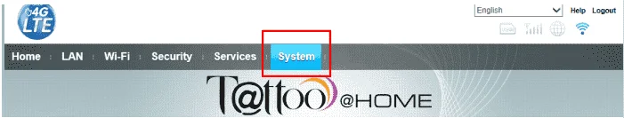

Step 3: Uploading of Configuration Login to your device Dashboard
1. Login as USER in You do not have permission to view the full content of this post. Log in or register now.
username: user
password: @l03e1t3
2. Click System
3. Go to Upload Configuration File
4. Browse your file > jhosherxx.conf
5. Click Submit

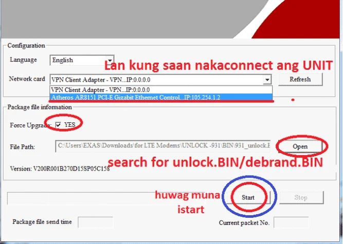

DEBRAND B593s-931
>Open file 931_FOR_Debrand.BIN
>huwag muna iistart
>iPower ON ang modem
>RESTART YOUR MODEM

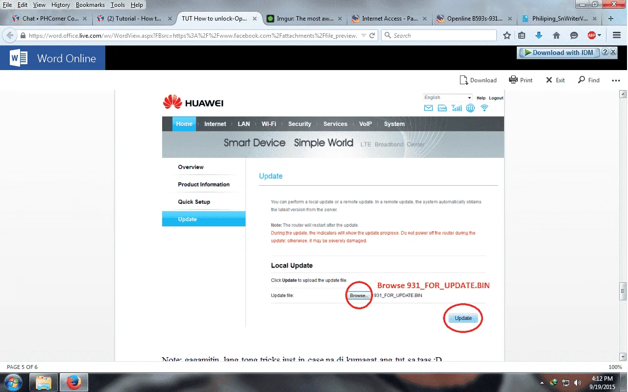

UPDATE B593s-931
username: admin
password: password123
>Home
>Update
>In Local Update Browse 931_FOR_UPDATE.BIN
Note: gagamitin lang tong tricks just in case na di kumagat ang tut sa taas :D

UPDATE B593s-931
username: admin
>Home
>Update
