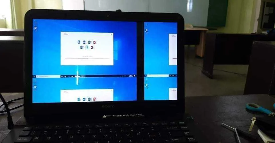

Humihingi po ako ng tulong regarding sa laptop Sony Vaio na after the first boot ng Windows 10 Fresh install nag split na ang screen into four. Mula sa POST screen hanggang windows. Ano kaya possible cause and solution? Patulong naman po. TIA
Try mo install yung display drivers ng laptop mo paps. Not sure if gagana since sabi mo even yung bios ganyan, pero worth a shot naman.
solved na po, pang windows 7 lang po talaga ang compatability ng laptop na ito, tried to remove the battery overnight, plugged in the windows 7 installer. I powered on the laptop and got a single screen, installed windows 7 and never again the screen splits into 4 even after the drivers were installed. Thanks for your comments and suggestions. Keep Safe
