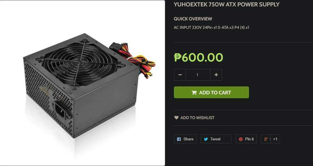

🔒 Closed Ask ko lang po kung ok po ang PSU na 'to kasi ang mura po kasi at nag-dadalawang isip po ako
Pomenthium
Leecher
Specs po ng pc ko:
Ryzen 3 2200g
Asus A320m Motherboard
2x8(16gb of ram 2666mhz)
MSI GTX 1050 Ti 4GT OCV1 4GB
Ito po pala description ng product:
1,Rated power 750W,passed 80plus Bronze certification, conversion efficiency is up to 80%.
2,Active power factor correction , super wide voltage design. Adopt double-MOS forward technology,work between 90V and 264V.
3,Standby power less than 1W ,suitable of energy star(Version 4.0) and EUP2010 standard.
4,Symmetric four+12V load can reach 40A,and it supports six core processor and high-end graphics card.
5, Adopt dual 4+4pin processor port,support top motherboard and dual CPU sever motherboard.
6,Six protect functions:OVP UVP,OCP,OLP,SCP,Lightning Protection.
okay lng yan
bale 480 watts rated power nyan (12V x 40A)
300W lng required ng 1050ti
pero kung gusto mong maka sigurado.. 450W true rated PSU ka
Susubukan ko sanang bumili ng ganyang PSU, kaso ang daming nag sabi na delikado daw. Just beware na you are putting your PC at-risk if pu-push mong bumili nyan. If I were you, if you can still wait, mag ipon ka na lang muna to get a better PSU. I got a Corsair po na 650w na bronze. Hindi sya ganon ka mahal.. you can check online
Nag research po ako regarding sa manufacturer niyan; wala akong mahanap maliban sa isang description nila na makikita mo sa iba't ibang sites kaya naisip ko na lang na bumili sa trusted na brand. Corsair 450w bronze po siya at Php 2,250 ang price.
Yea, that's waaaay much better. The 450w Corsair that I bought lasted for 7 years, actually still buhay pa sya. I just had to change PSU cause nagpalit din ako ng PC Specs. Better to save and wait than buy something cheap tpos you might ruin your PC in the process. Goodluck!
Good Choice boss. Tama yan research research, and wag na wag mo titipirin yang PSU hehe. Go for branded and true rated PSU
