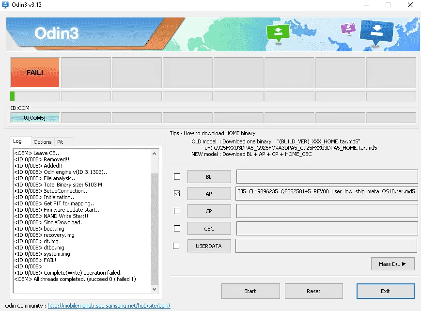

always failing in system.img already tried version 3.13 - 1.14
if i use 3.12 it stuck on set partition in shootbin.lz4
I tried October and November firmware but no luck .
Tried 3 same version of PH October firmware in different site all leads to failining in system.img
Gonna try version from other country
Any suggestion??
emmc chip na ba problema dito? or may another way para mainstall old version ng firmware sa phone na to
Pakitingnan kung anong binary ng a205gn mo, baka ibang binary ung naiflash mo, kapag nasa odin mode(download mode) ka, tingnan mo ung binary version like this one A205GNDXU3ASI2, bumilang ka ng lima mula sa kanan pakaliwa which is binary 3, go to official site ng samsung (sammobile) at idownload mo latest version ng binary 3(kung binary 3 ung unit mo), dapat alam mo din carrier, glb for globe, sma for smart and xtc for openline
May nireprogram din ako dati na samsung j7 pro ganyan din. Kahit latest firmware tska latest odin ayaw pumasok sa phone. Emmc na problem nun e baka ganun din yang sayo. Try mo po iflash yung custom recovery nya galing sa xda. Kung naflash mo yun hindi emmc problem nyan.
