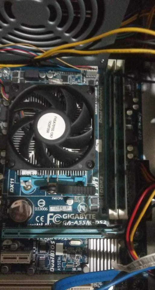

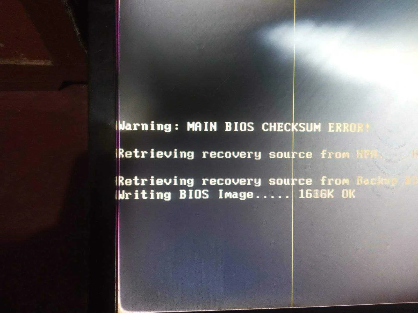

First, try clearing the CMOS settings memory. If you can get into setup after rebooting, use default CMOS settings.
If that doesn’t work, you can try flashing the BIOS memory using tools that can be run without windows from Gigabyte support website.
Just in case it’s some other hardware, use a minimum of memory by removing RAM to only 1 slot. If it doesn’t work, swap with another RAM and see if that works.
kung defective na yung primary bios chip mo,pwede mo iswap dun sa pangalawa using hot air. pero itry mo muna using yung jumper trick para maiload yung backup bios mo sa primary, kung error pa din dun muna pagpalitin
Nagupdate ka ata bios narestore mo naman si bios pero ganun pa rin flash mo si old bios if di magwork swap mo yan hot air
Mabute at napagana mo ng sa sarili mong paraan grats sa new knowledge pag may tanong ka ask ka lang saken
