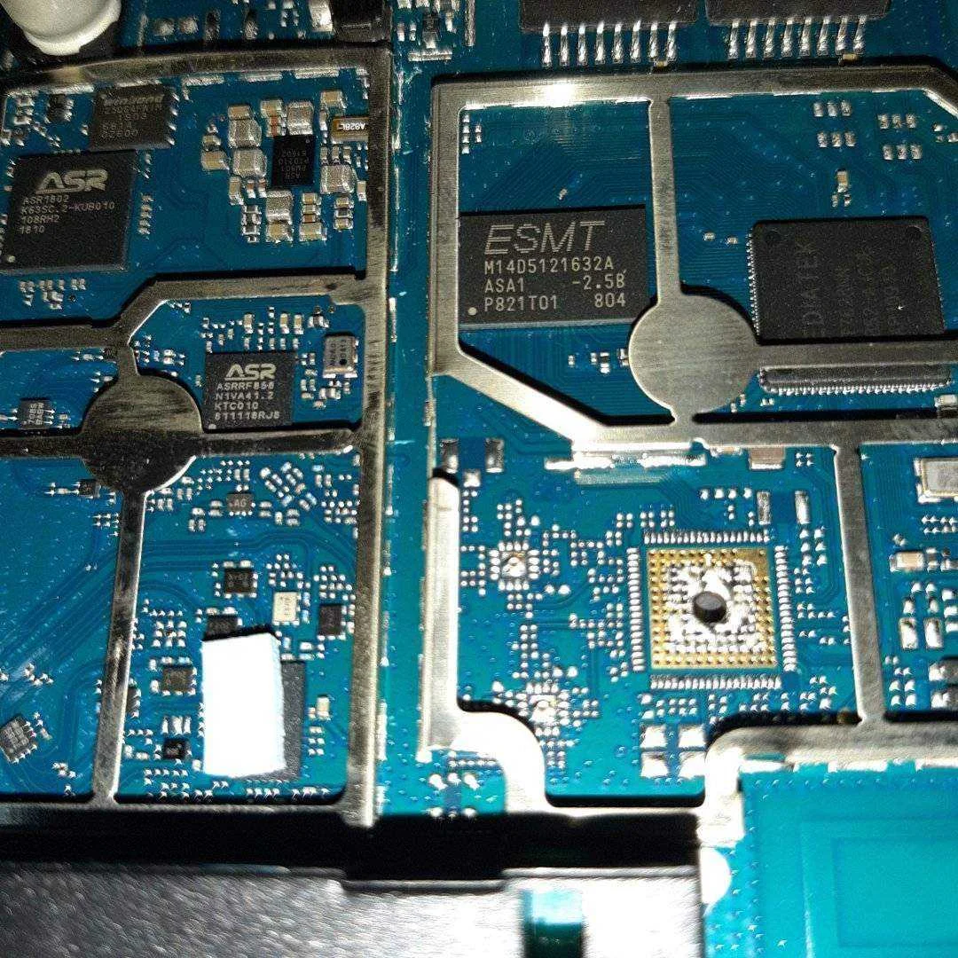

Well i opened both of them, R051 indeed has the same ASR1802 Chip as the R281, but it's provisioned/set to be CAT4 modem, while the r281 is provisioned to be CAT6 (not even cat 7). I would want to test copying the reliable data from the r281 to the r051 though i dont know how to do that. The r281 has a bigger flash mem for the chips compared to the r051 and also uses ubi flash instead of plain emmc. so i wonder if its possible.

[XX='mashuser, c: 416783, m: 682955'][/XX] Woah, I DIDN'T EXPECT that R051 and R281 would have the same BB ASIC. I just opened my R051 and found the ASR1802 paired with an ASRRF858 RF ASIC and Winbond 25Q64FWIM 64Mb serial flash. The two are sold at different price points but carries the same ASIC? That's crazy, given the specs below.
From this PR [1], it says that ASR1802 is "based on the same product of Marvell," which I think is the ARMADA PXA1802 Multi-mode LTE R8 Cat.4. So how can this be a Cat.6? 😯🤔

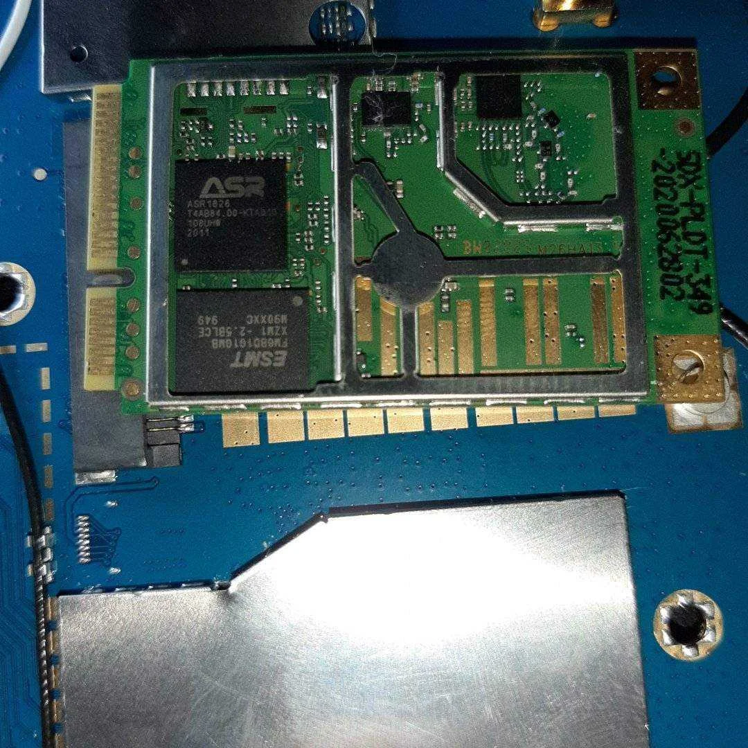

[XX='bjarnco32, c: 418151, m: 1690679'][/XX] kek, sorry didnt realize my mistake, quarantine sabaw mode
The two modems do use different ASR/marvell chips, but i guess from the same technology. Here are their pictures, R051 uses ASR 1802, and R281 uses ASR 1826.

[XX='mashuser, c: 420161, m: 682955'][/XX] Hehe it's okay. It would really be crazy if the two are the same. My only gripe remaining then is that Boost Even didn't upgrade the SOC, opting to use the same from R051.
Thanks for the pics btw.

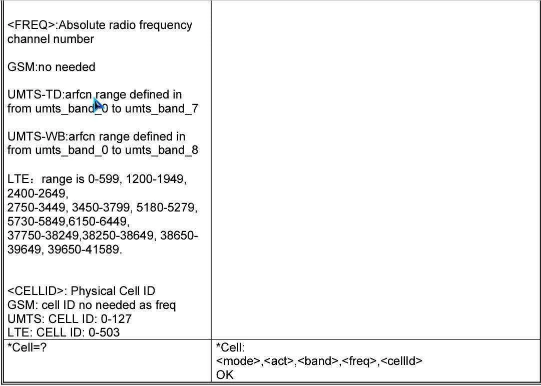

I was able to band lock mine to band 3 using Putty: AT*Cell=1,1,3,1775 problem is it jumps between band 3/1, 3/5 and 3/28 (best). Since it's only allowing us to lock the primary band (I observed that the Cell ID remained the same even when it switches between the different 3/xx combinations), it's not as stable as a single band locked 936 modem.
Question. Why do we need to specify the ARFCN (1775)? For admin enabled modems, you can just choose band 40 and that's it, the router sticks to that band regardless of operating frequency. I found this PDF - although it's for a different brand of modem, is it possible to indicate a 'range' instead of a specific ARFCN?
Is there an AT*Cell command that will let us specify the 'primary' and 'secondary' bands? How do I do it if I want it to stick to band 3/28?
[XX='bjarnco32, c: 415898, m: 1690679'][/XX] paano ung root access? may link ka paps? Also, pwede kaya salpakan ng SIMCOM module dun sa pcie, parang papalitan ung current na nsa pcie ng R281?
