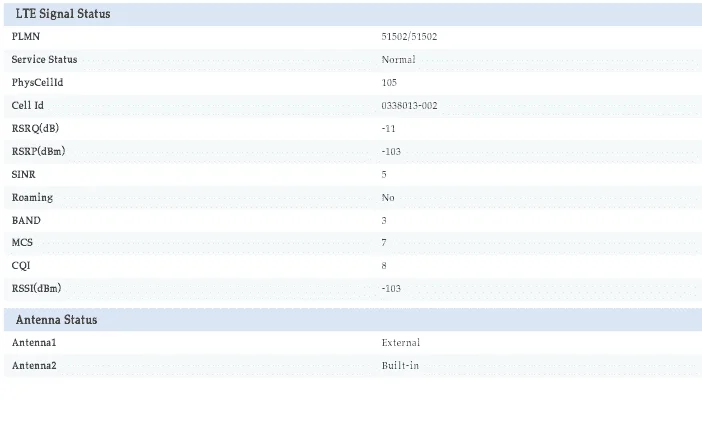

bakit kaya ganto mga sir di ma detect ung antenna2 ung antenna1 lang gumagana.
na reset ko narin pero ganon parin.
sa modem napo kaya sira nito.
thanks😊
Antenna detection works on that modem by way of having a DC grounded, aka shunt fed, antenna. This will register a short circuit or close to it when tested in an ohmmeter. Simply put, you just need to have your antenna connector terminals shorted for the antenna to work with the device, if your device is set to AUTO antenna setting, as is the case with S10G.
