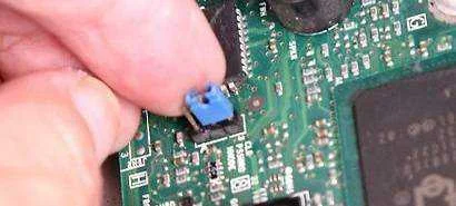

try mo reset ang Bios settings ( Clear CMOS Memory ) mo by removing cmos battery for at least 10-15secs or hanapin mo yung Jumper sa Motherboard mo ... madalas malapit lang sa cmos battery may 3pins yun, yung dalawa connected sila (like na nasa Picture) . so ang gagawin mo lang ilipat yung connector to Clear Position then turn on your PC if mag ON turn off mo ulet then balik mo ulet sa original Position..
