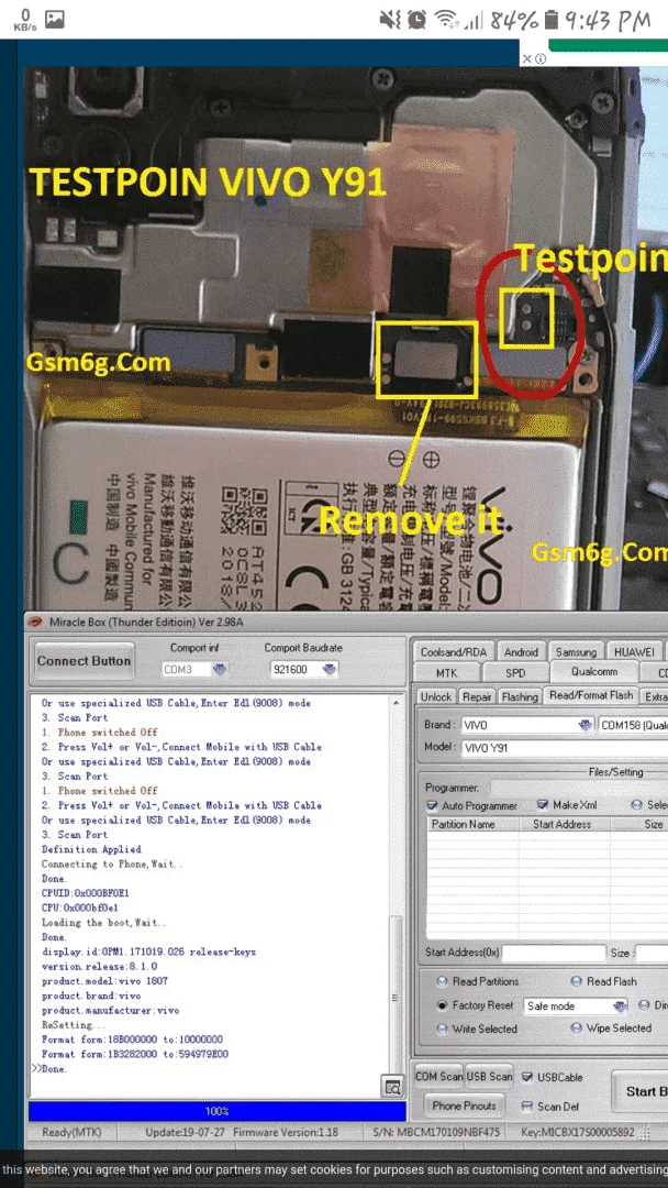

If nakaedl mode baka possible tong tool na to
