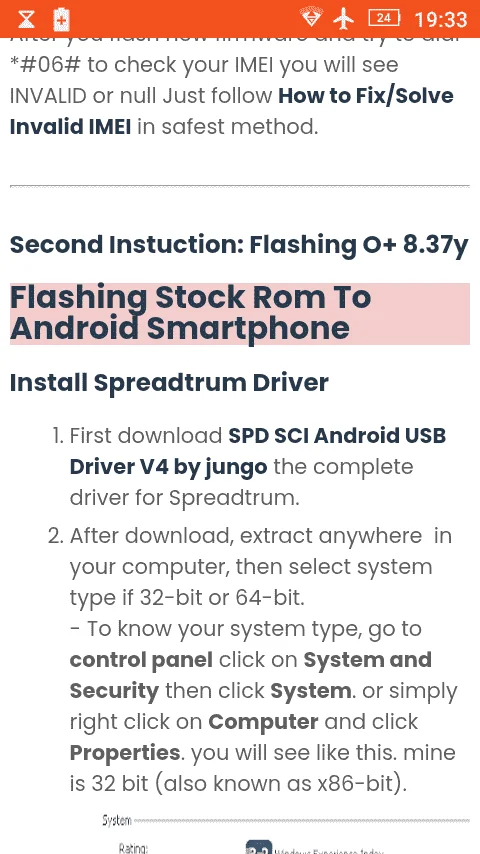

U usersusername Elite Aug 22, 2020 #5 second instruction sinundan mo? Attachments Screenshot_2020-08-22-19-33-16.webp 57.8 KB · Views: 25
U usersusername Elite Aug 22, 2020 #7 Asiapot18 said: opo sir ung usb driver po ayaw po ma install Click to expand... 64bit ata pc mo?
